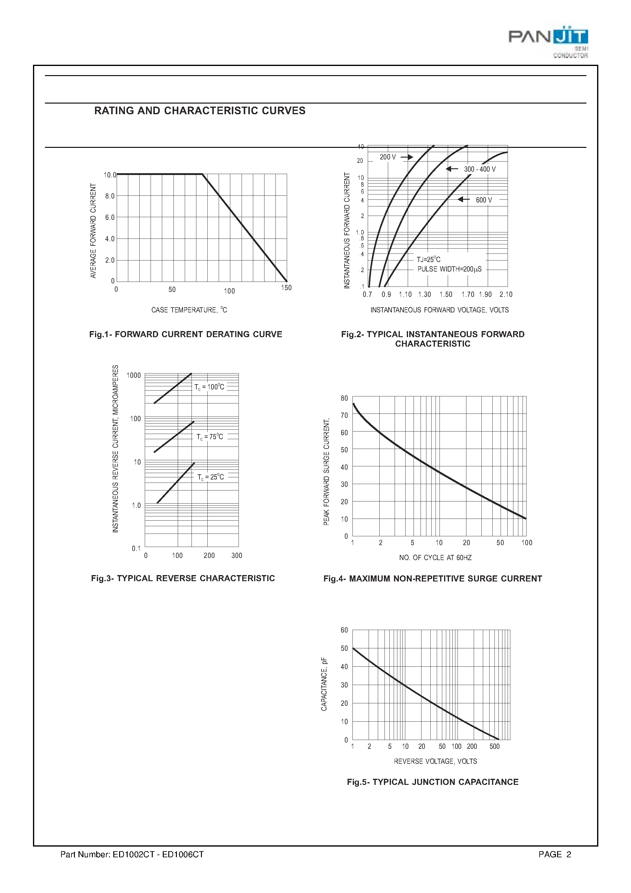

ED1002CT-SUPER FAST RECOVERY RECTIFIER(VOLTAGE - 200 to 600 Volts CURRENT - 10.0 Amperes)
Producer:Pan Jit International Inc.
Description:SUPER FAST RECOVERY RECTIFIER(VOLTAGE - 200 to 600 Volts CURRENT - 10.0 Amperes)
Others with the same file: ED1002CT
Datasheet ED1002CT - SUPER FAST RECOVERY RECTIFIER(VOLTAGE - 200 to 600 Volts CURRENT - 10.0 Amperes) page 1
Datasheet ED1002CT - SUPER FAST RECOVERY RECTIFIER(VOLTAGE - 200 to 600 Volts CURRENT - 10.0 Amperes) page 2
