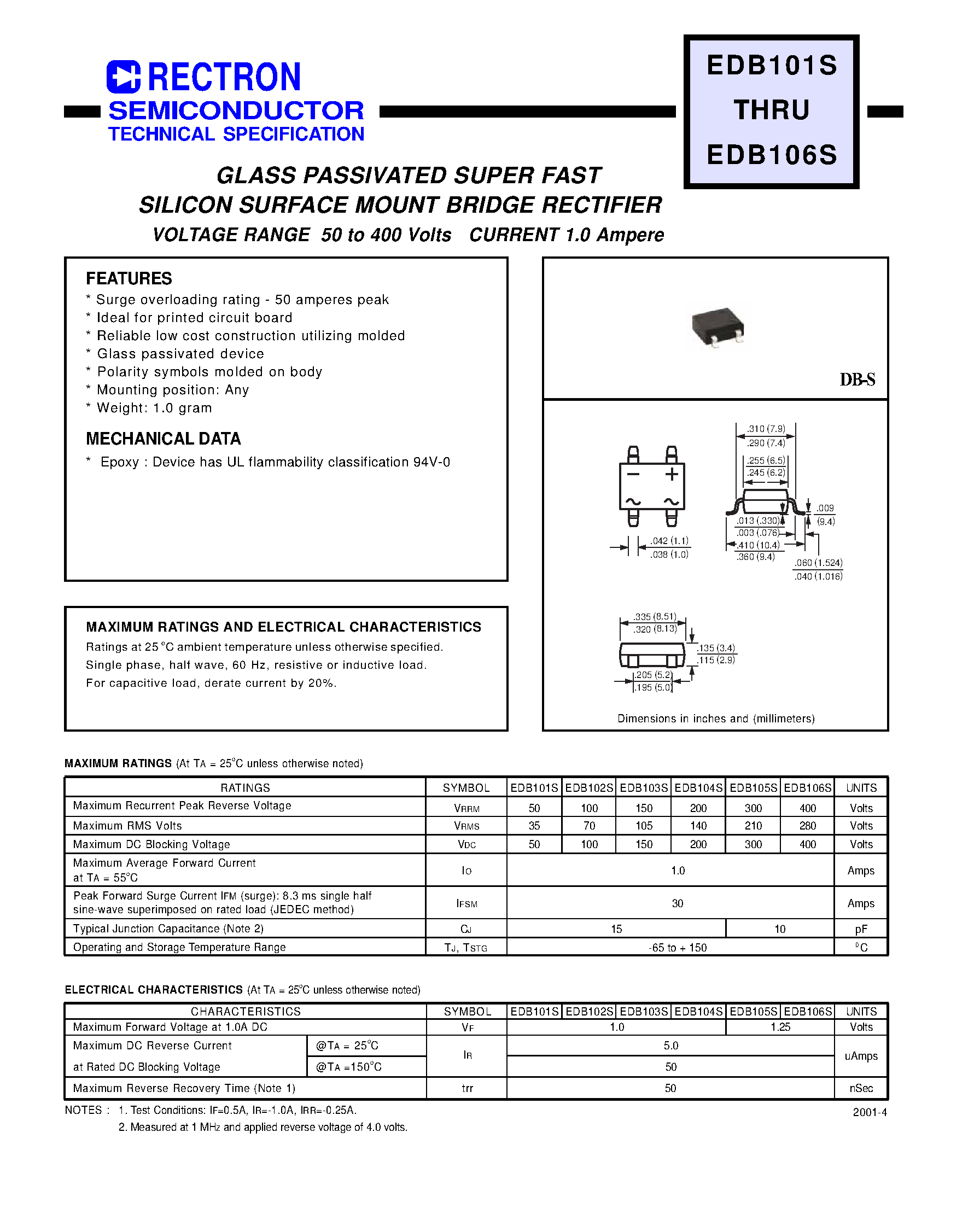

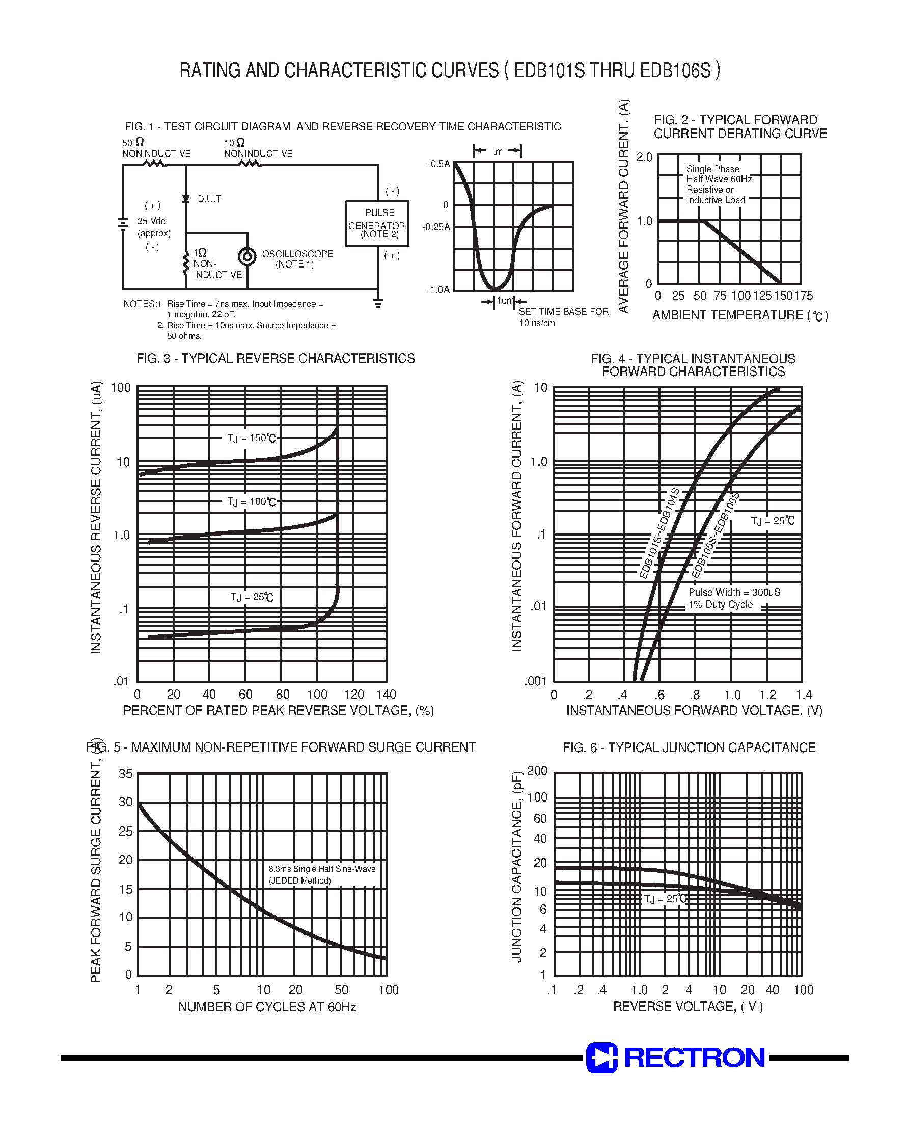

EDB101S-GLASS PASSIVATED SUPER FAST SILICON SURFACE MOUNT BRIDGE RECTIFIER (VOLTAGE RANGE 50 to 400 Volts CURRENT 1.0 Ampere)
Producer:Rectron
Description:GLASS PASSIVATED SUPER FAST SILICON SURFACE MOUNT BRIDGE RECTIFIER (VOLTAGE RANGE 50 to 400 Volts CURRENT 1.0 Ampere)
