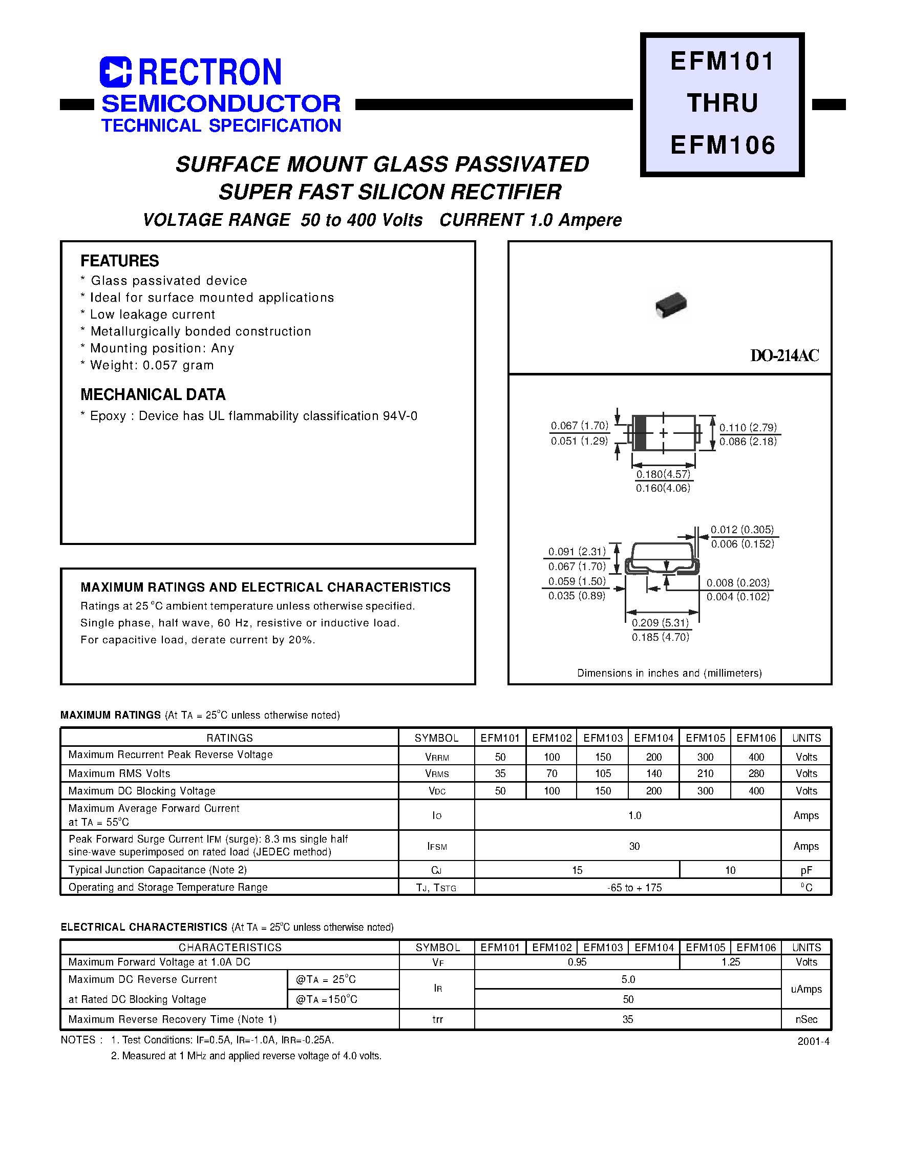

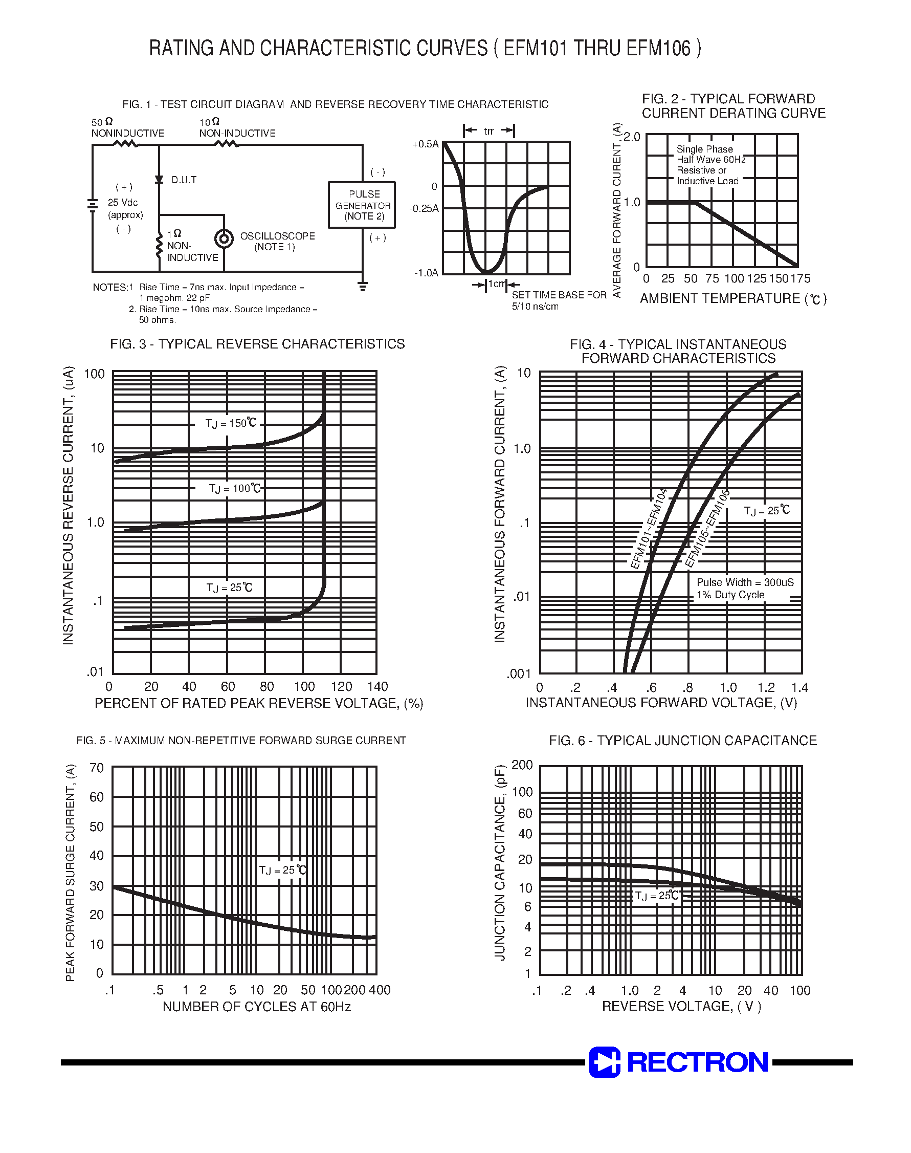

EFM101-SURFACE MOUNT GLASS PASSIVATED SUPER FAST SILICON RECTIFIER (VOLTAGE RANGE 50 to 400 Volts CURRENT 1.0 Ampere)
Producer:Rectron
Description:SURFACE MOUNT GLASS PASSIVATED SUPER FAST SILICON RECTIFIER (VOLTAGE RANGE 50 to 400 Volts CURRENT 1.0 Ampere)
Others with the same file: EFM101
Datasheet EFM101 - SURFACE MOUNT GLASS PASSIVATED SUPER FAST SILICON RECTIFIER (VOLTAGE RANGE 50 to 400 Volts CURRENT 1.0 Ampere) page 1
Datasheet EFM101 - SURFACE MOUNT GLASS PASSIVATED SUPER FAST SILICON RECTIFIER (VOLTAGE RANGE 50 to 400 Volts CURRENT 1.0 Ampere) page 2
