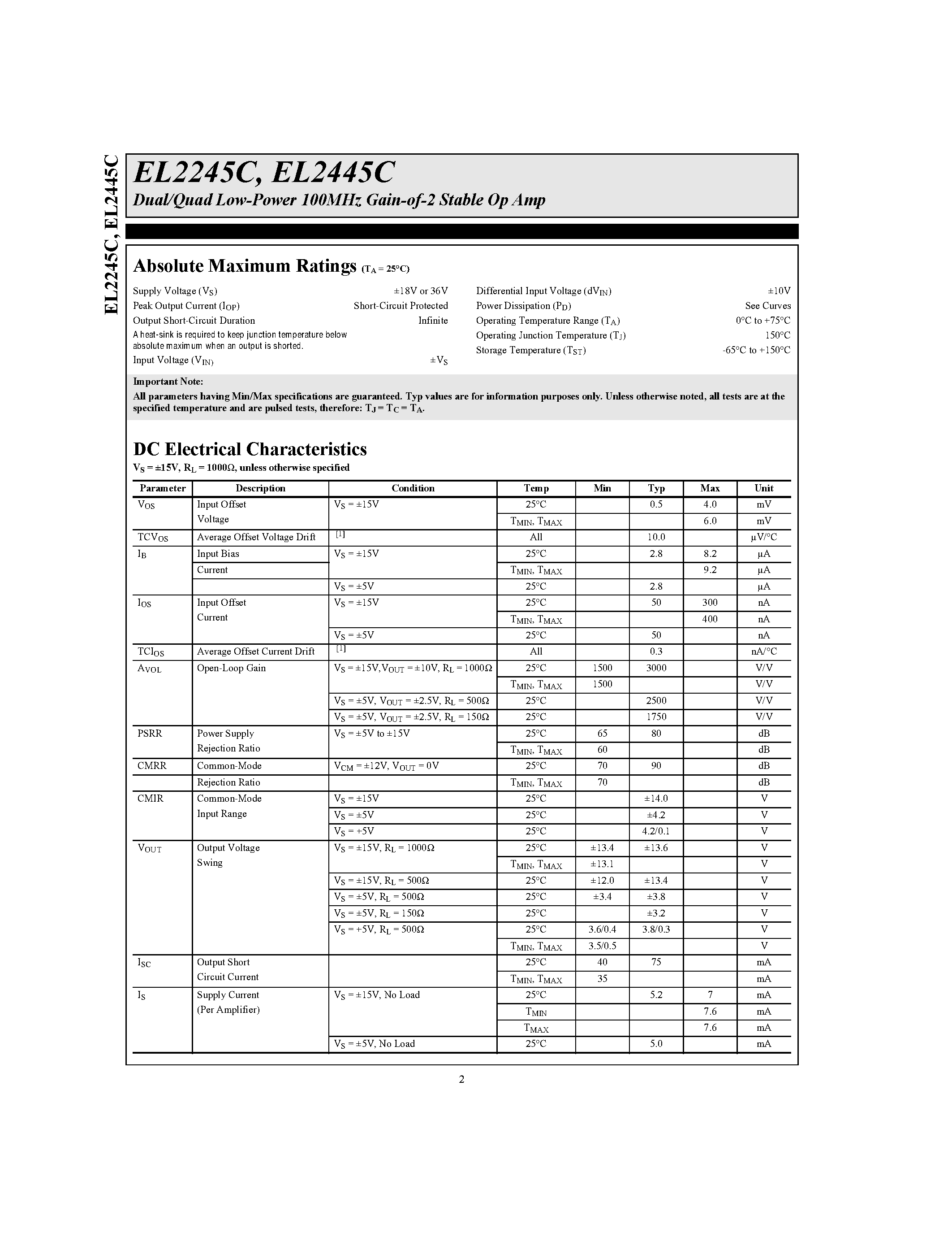

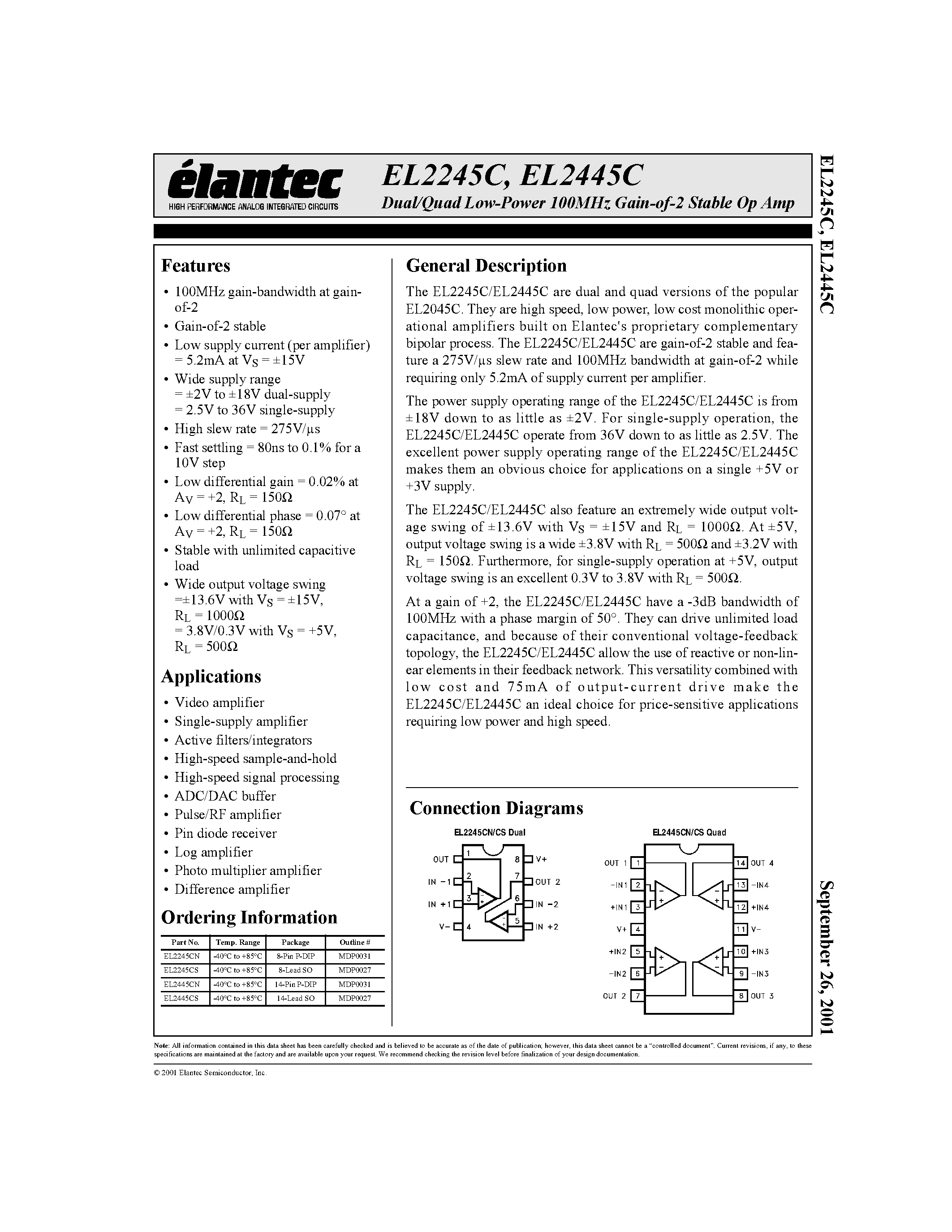

EL2245-Dual/Quad Low-Power 100MHz Gain-of-2 Stable Op Amp
Producer:Elantec Semiconductor
Description:Dual/Quad Low-Power 100MHz Gain-of-2 Stable Op Amp
Others with the same file: EL2245
Datasheet EL2245 - Dual/Quad Low-Power 100MHz Gain-of-2 Stable Op Amp page 1
Datasheet EL2245 - Dual/Quad Low-Power 100MHz Gain-of-2 Stable Op Amp page 2
