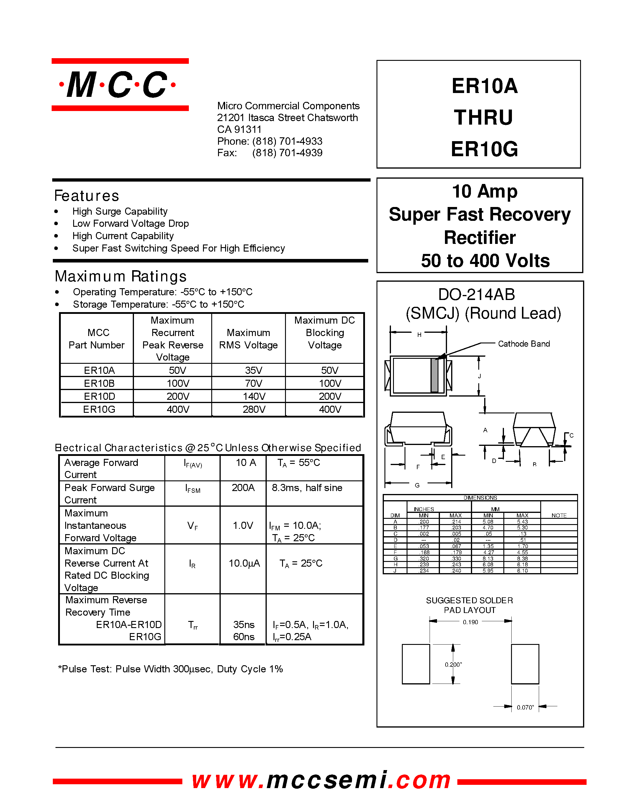

ER10D-10 Amp Super Fast Recovery Rectifier 50 to 400 Volts
Description:10 Amp Super Fast Recovery Rectifier 50 to 400 Volts
Others with the same file: ER10D
Datasheet ER10D - 10 Amp Super Fast Recovery Rectifier 50 to 400 Volts page 1

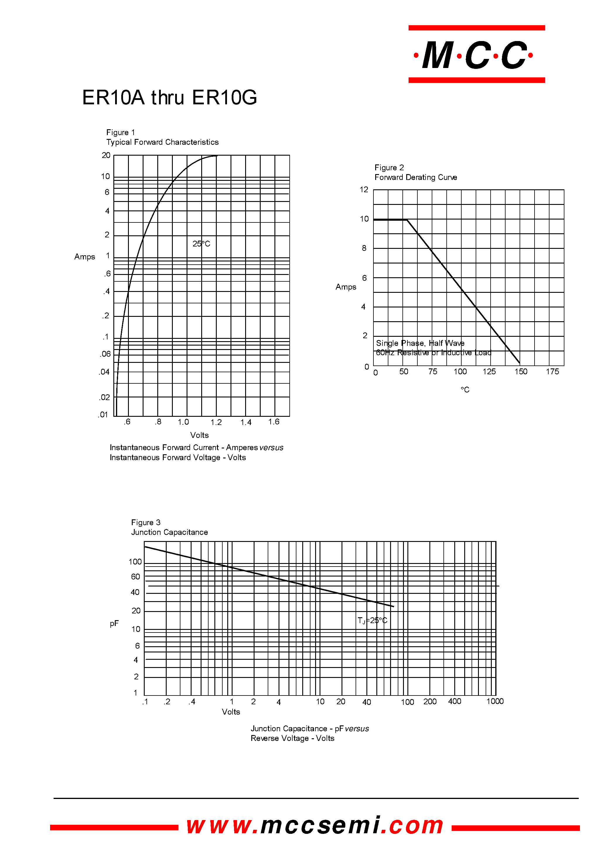

Datasheet ER10D - 10 Amp Super Fast Recovery Rectifier 50 to 400 Volts page 2
