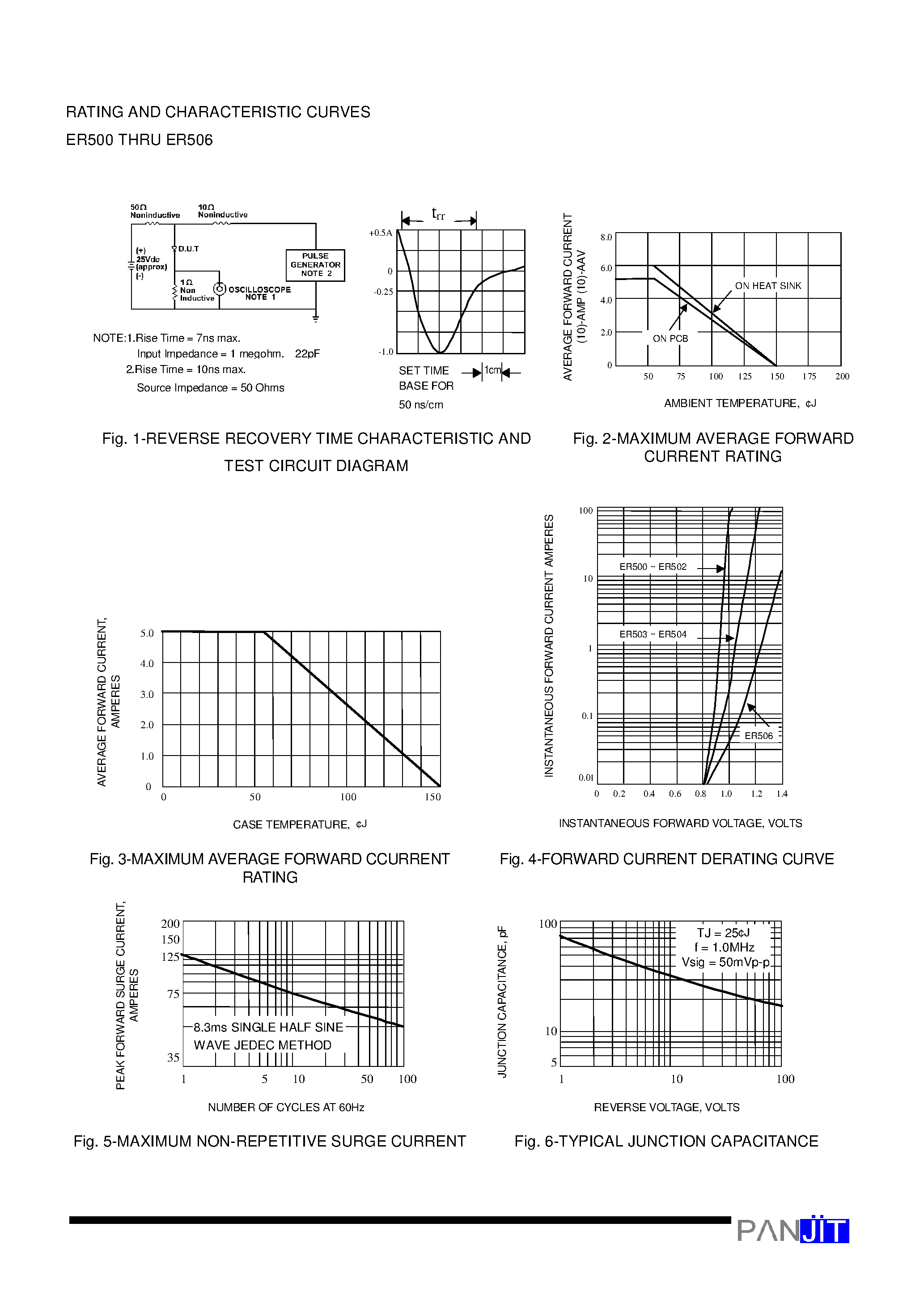

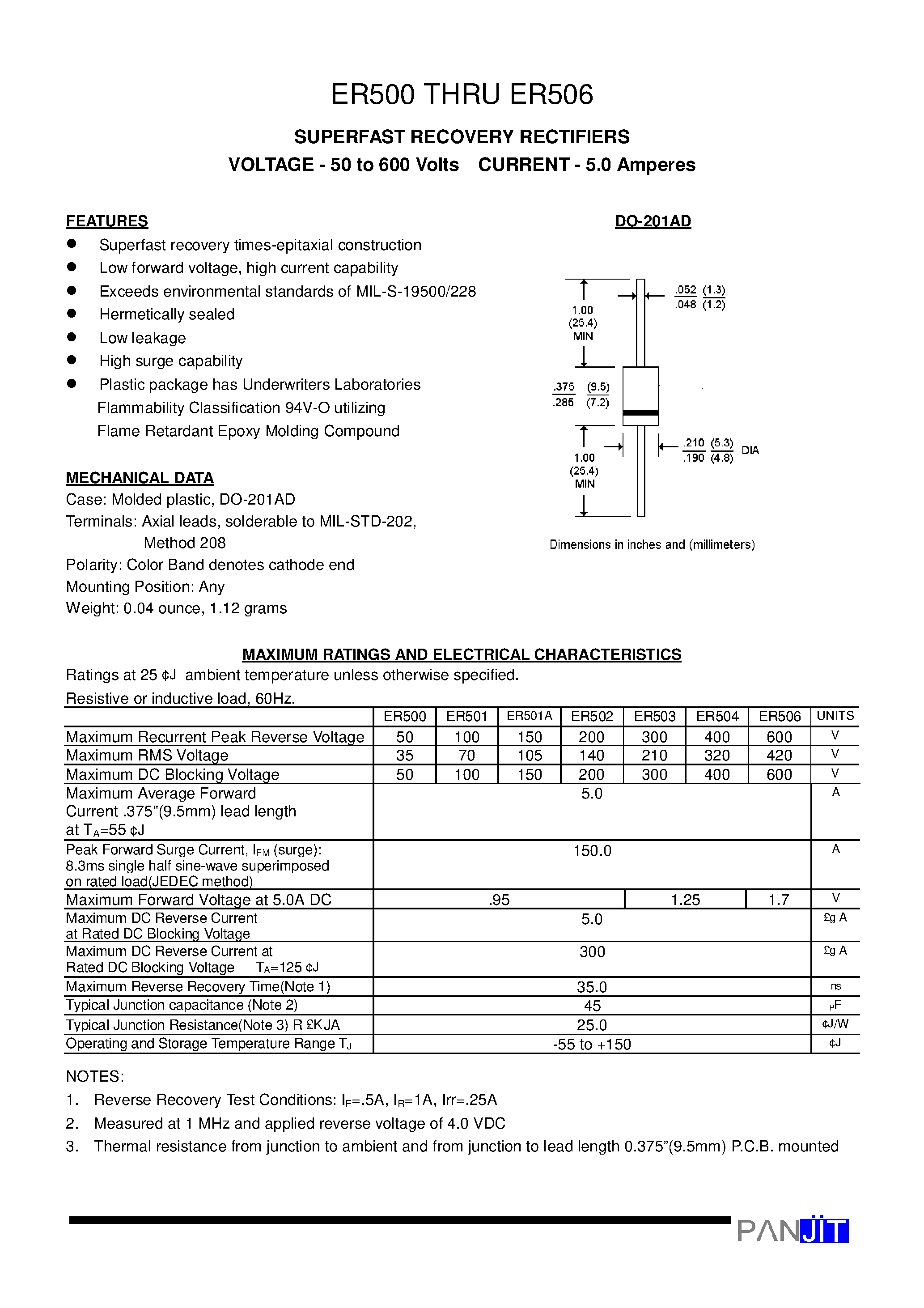

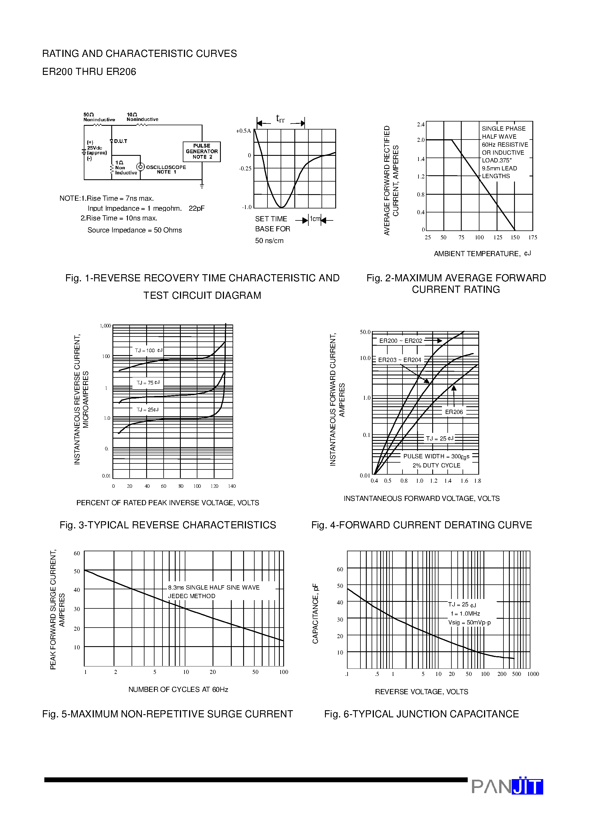

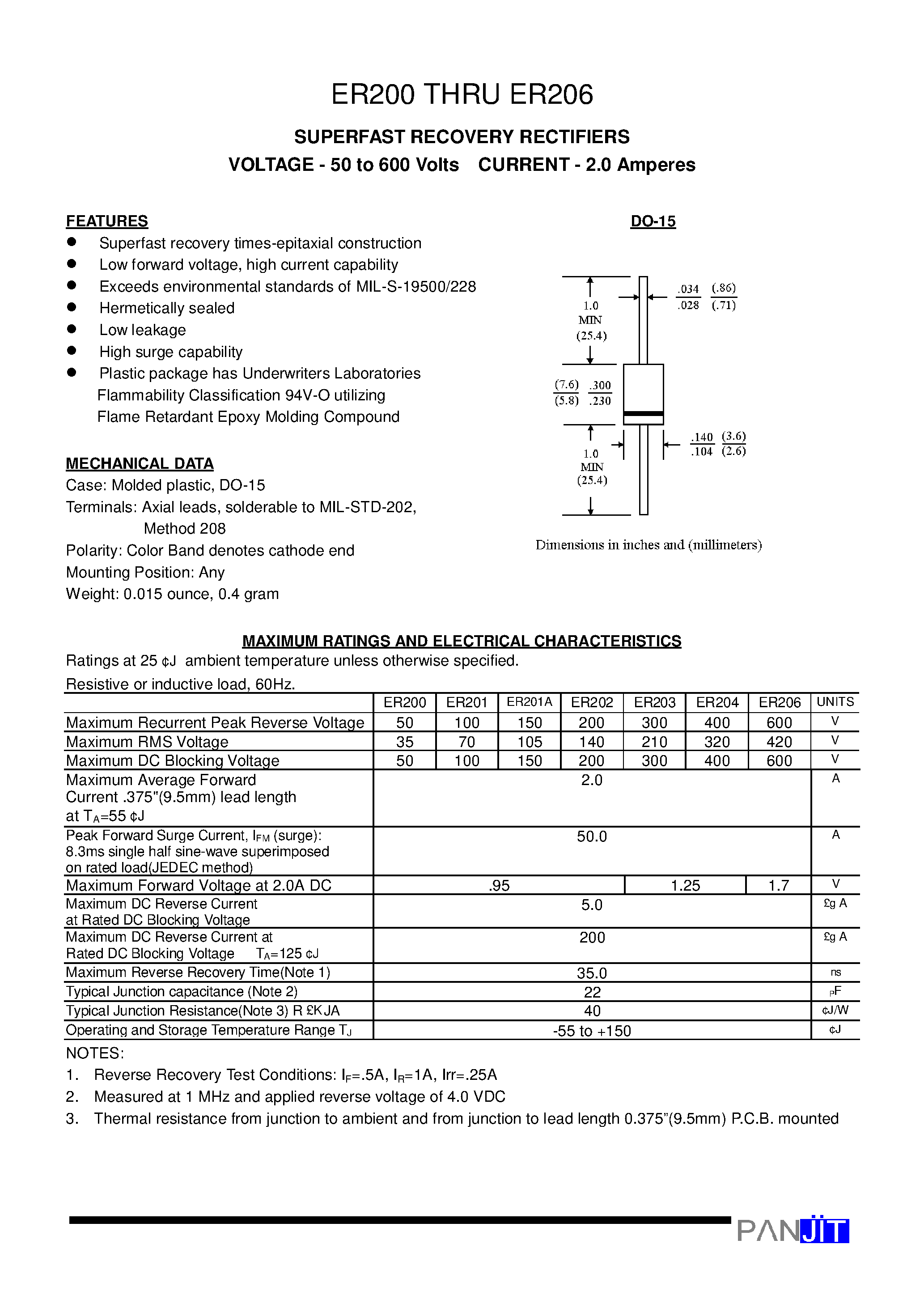

ER200-SUPERFAST RECOVERY RECTIFIERS(VOLTAGE - 50 to 600 Volts CURRENT - 2.0 Amperes)
Producer:Pan Jit International Inc.
Description:SUPERFAST RECOVERY RECTIFIERS(VOLTAGE - 50 to 600 Volts CURRENT - 2.0 Amperes)
Others with the same file: ER200
Datasheet ER200 - SUPERFAST RECOVERY RECTIFIERS(VOLTAGE - 50 to 600 Volts CURRENT - 2.0 Amperes) page 1
Datasheet ER200 - SUPERFAST RECOVERY RECTIFIERS(VOLTAGE - 50 to 600 Volts CURRENT - 2.0 Amperes) page 2
