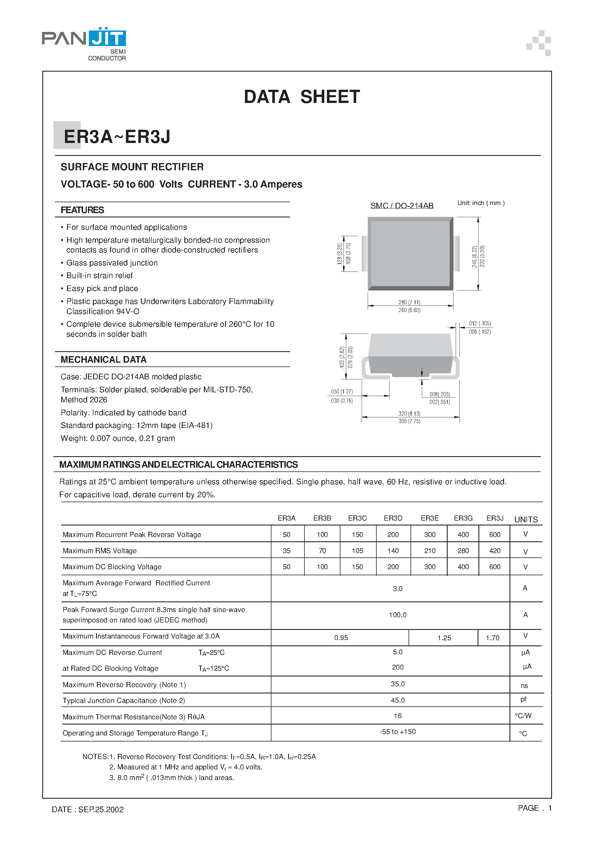

ER3G-SURFACE MOUNT RECTIFIER(VOLTAGE- 50 to 600 Volts CURRENT - 3.0 Amperes)
Producer:Pan Jit International Inc.
Description:SURFACE MOUNT RECTIFIER(VOLTAGE- 50 to 600 Volts CURRENT - 3.0 Amperes)
Others with the same file: ER3G
Datasheet ER3G - SURFACE MOUNT RECTIFIER(VOLTAGE- 50 to 600 Volts CURRENT - 3.0 Amperes) page 1

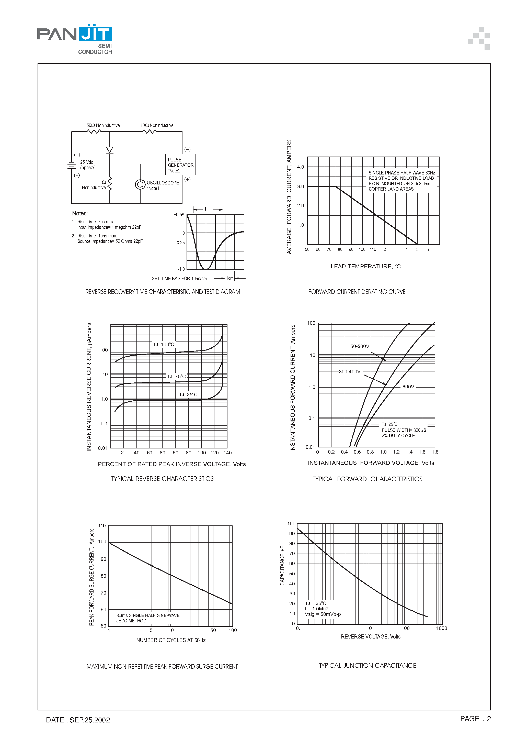

Datasheet ER3G - SURFACE MOUNT RECTIFIER(VOLTAGE- 50 to 600 Volts CURRENT - 3.0 Amperes) page 2
