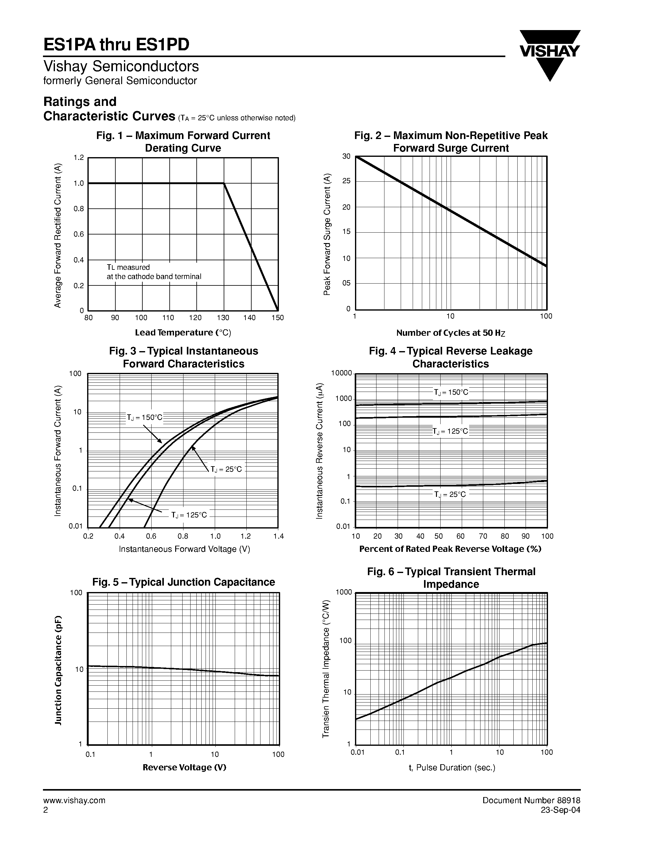

ES1PA-(ES1Px) High Current Density Surface Mount Ultrafast Rectifiers
Producer:Vishay Siliconix
Description:(ES1Px) High Current Density Surface Mount Ultrafast Rectifiers
