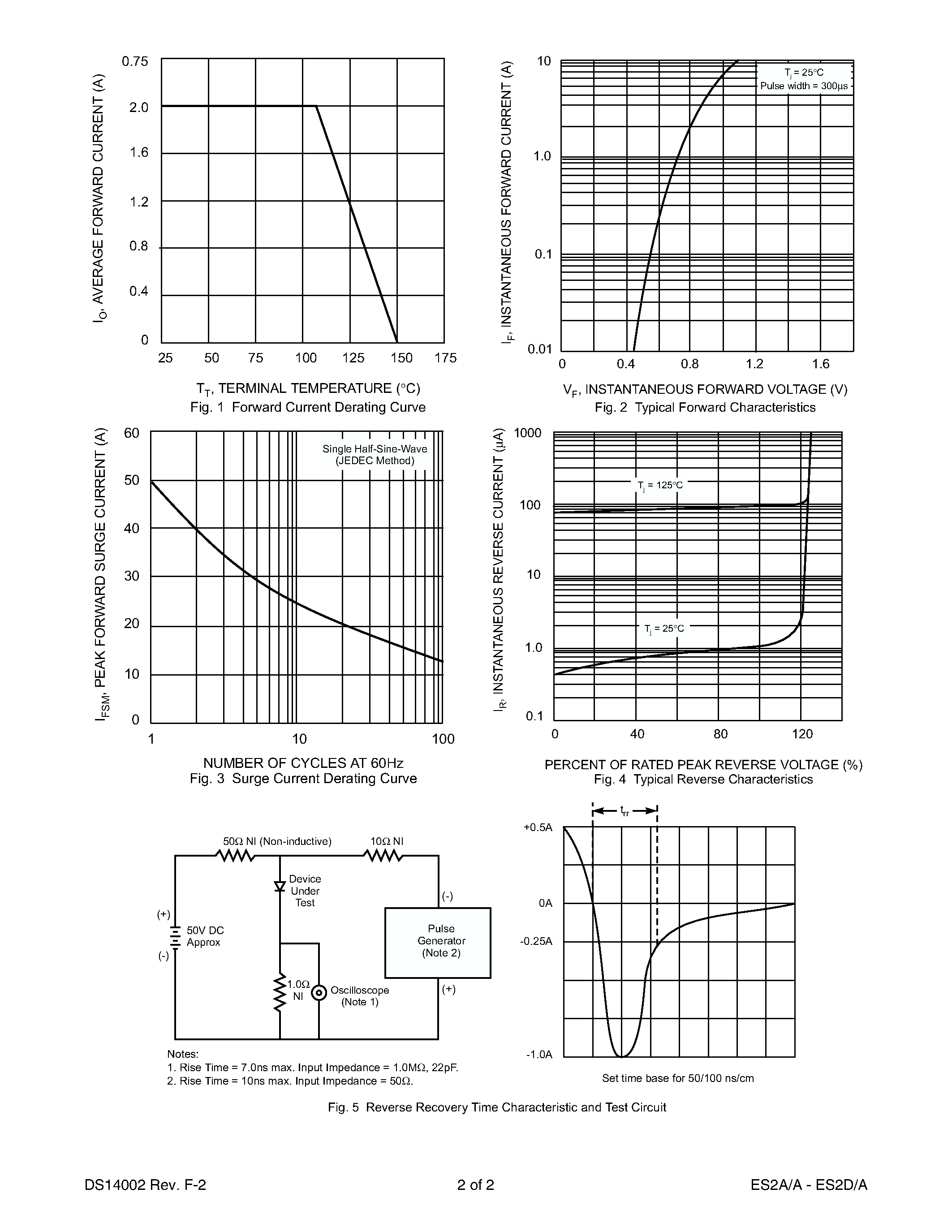

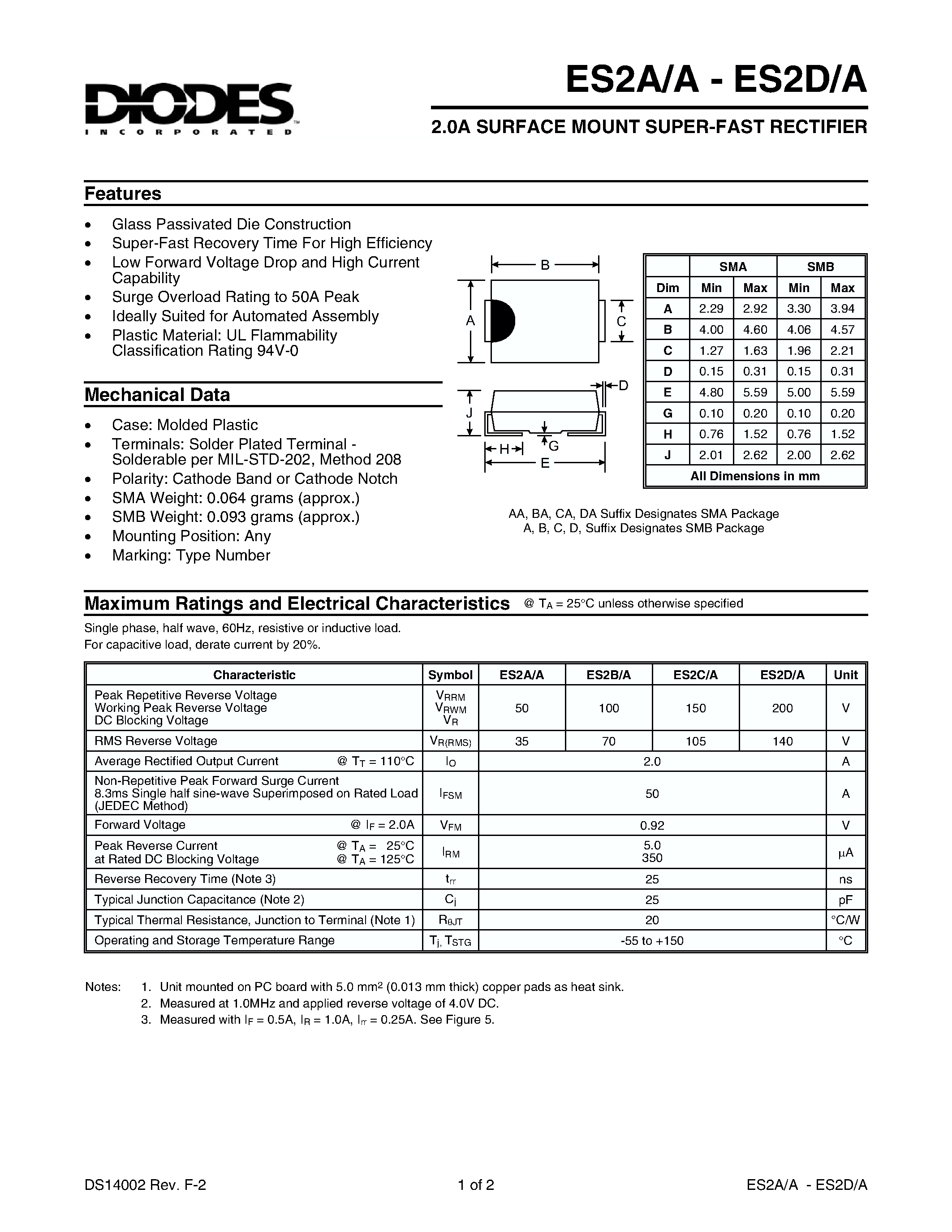

ES2CA-2.0A SURFACE MOUNT SUPER-FAST RECTIFIER
Producer:Diodes Incorporated
Description:2.0A SURFACE MOUNT SUPER-FAST RECTIFIER
Others with the same file: ES2CA
Datasheet ES2CA - 2.0A SURFACE MOUNT SUPER-FAST RECTIFIER page 1
Datasheet ES2CA - 2.0A SURFACE MOUNT SUPER-FAST RECTIFIER page 2
