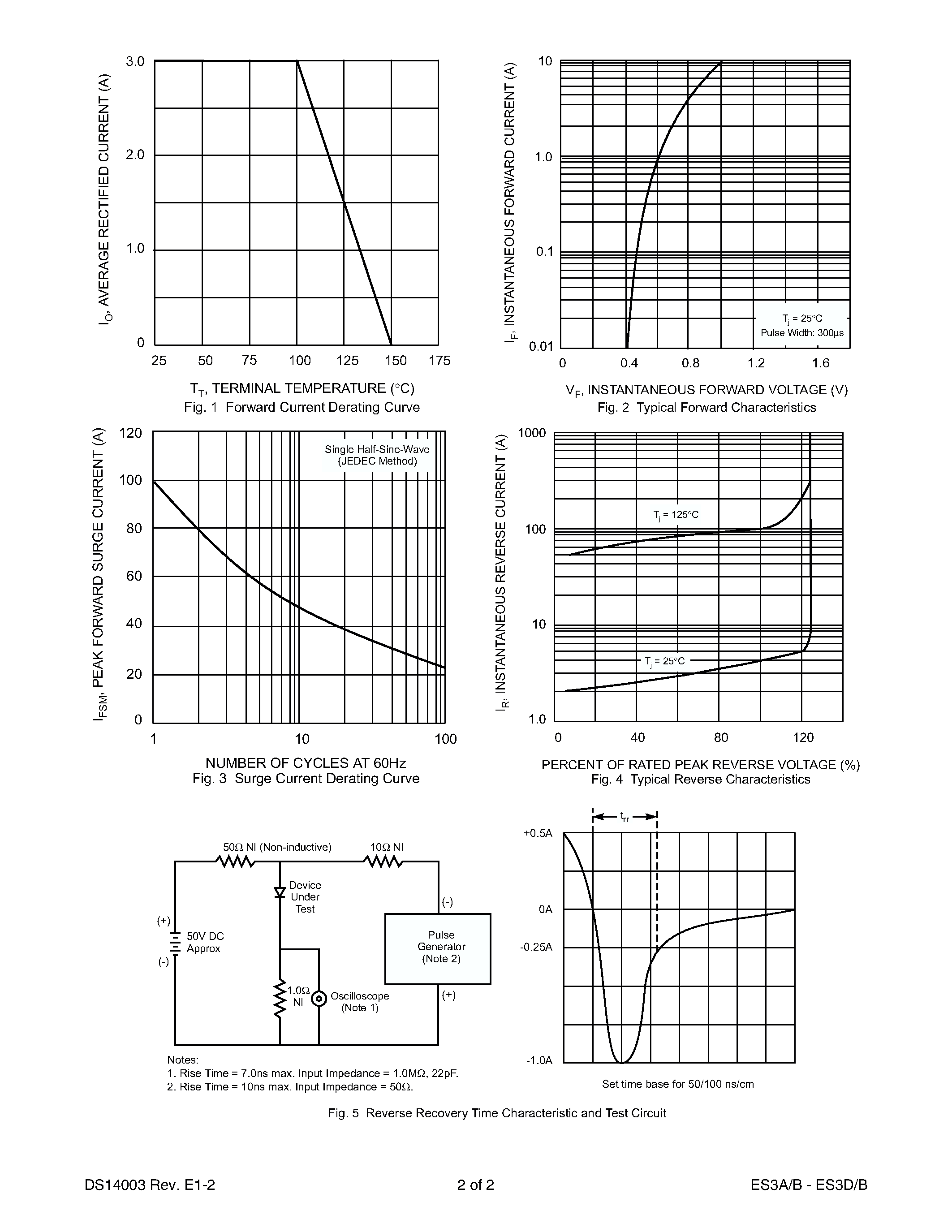

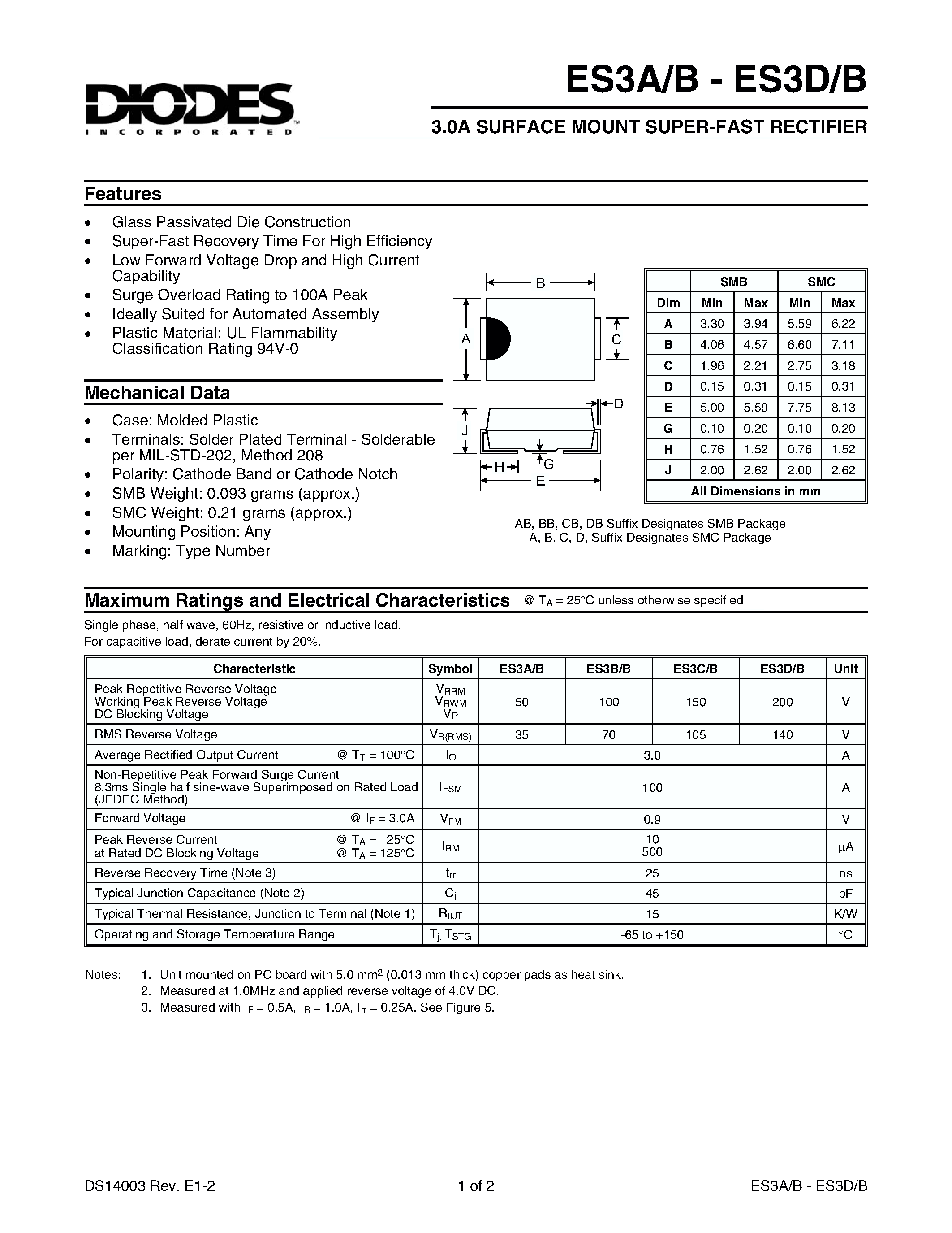

ES3DB-3.0A SURFACE MOUNT SCHOTTKY BARRIER RECTIFIER
Producer:Diodes Incorporated
Description:3.0A SURFACE MOUNT SCHOTTKY BARRIER RECTIFIER
Others with the same file: ES3DB
Datasheet ES3DB - 3.0A SURFACE MOUNT SCHOTTKY BARRIER RECTIFIER page 1
Datasheet ES3DB - 3.0A SURFACE MOUNT SCHOTTKY BARRIER RECTIFIER page 2
