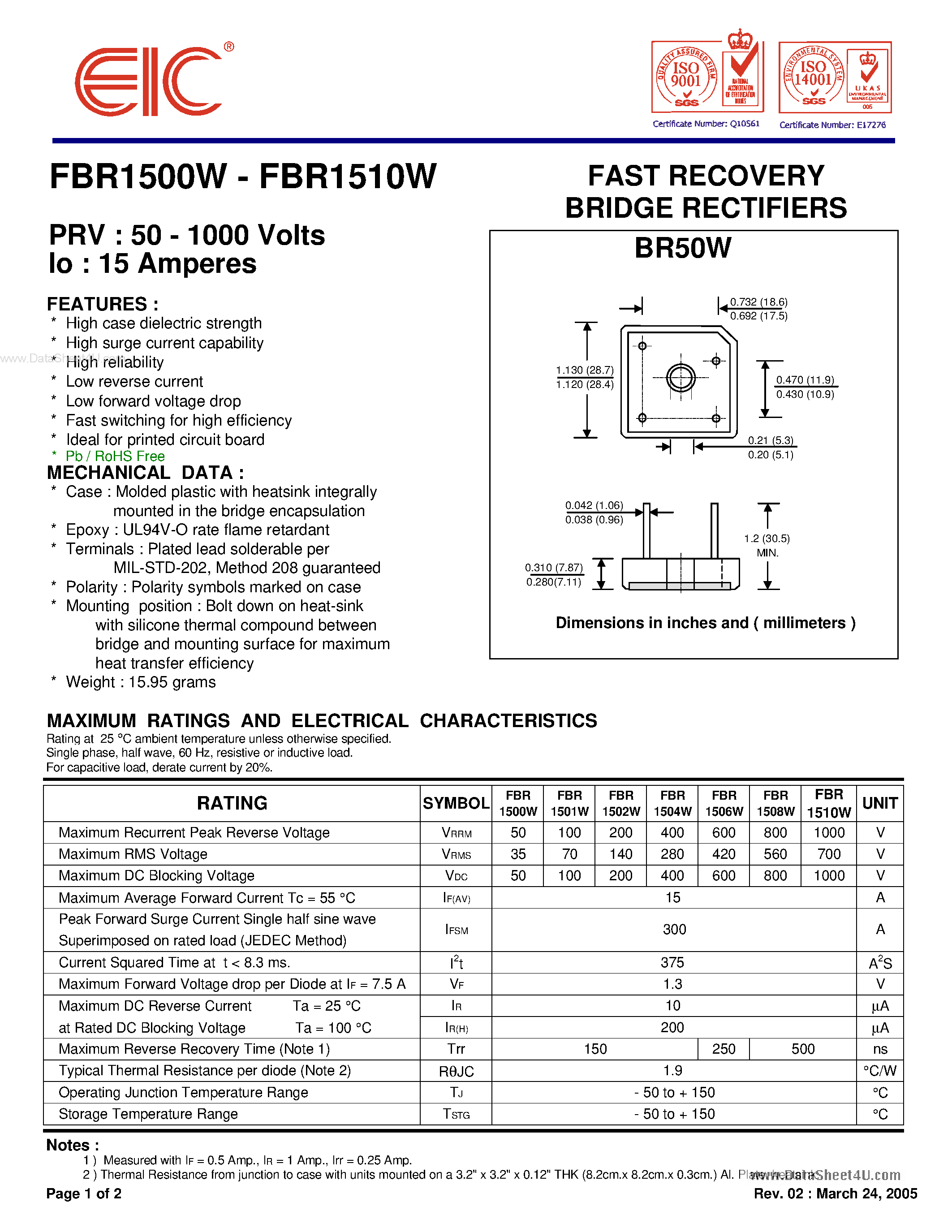

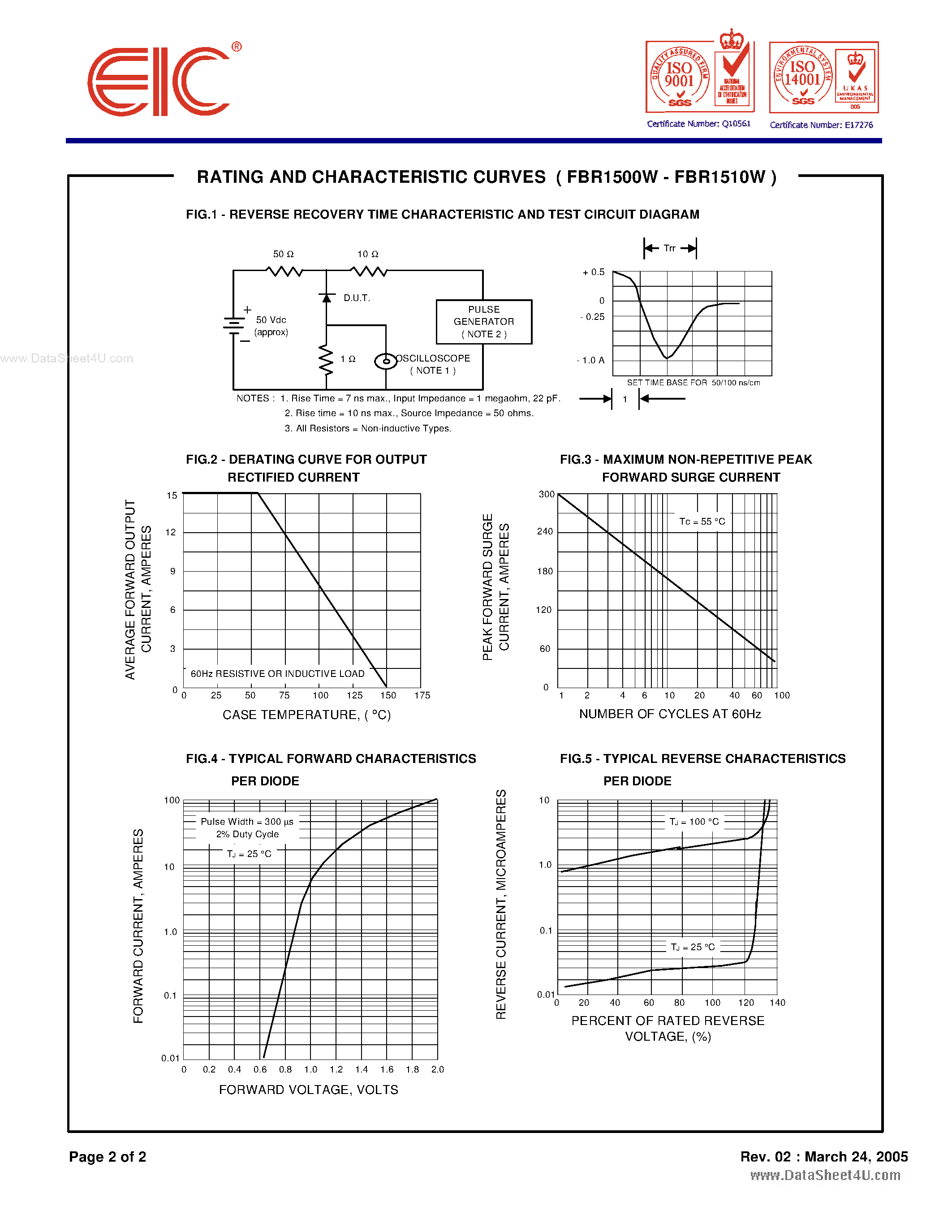

FBR1500W-(FBR1500W - FBR1510W) FAST RECOVERY BRIDGE RECTIFIERS
Producer:EIC discrete Semiconductors
Description:(FBR1500W - FBR1510W) FAST RECOVERY BRIDGE RECTIFIERS
