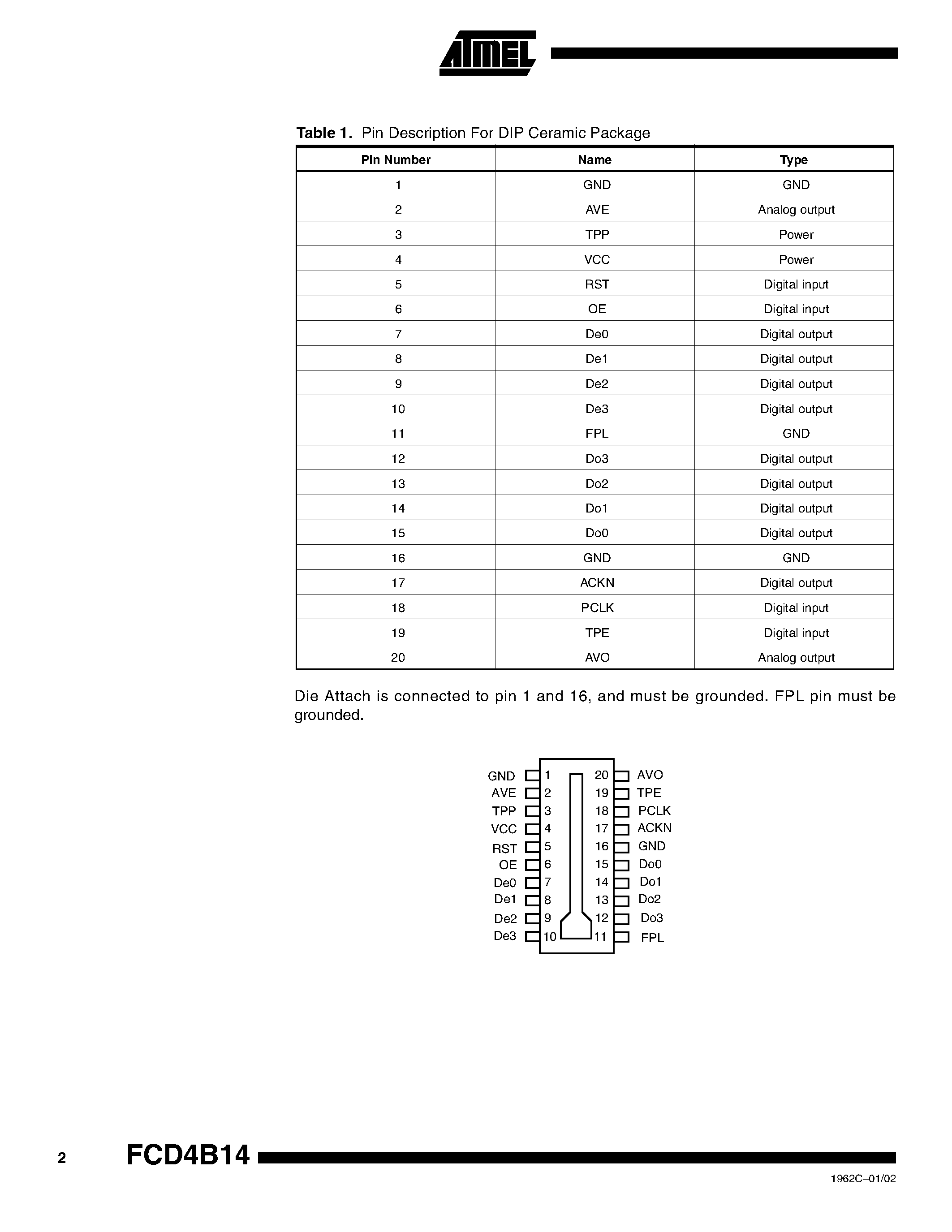

Datasheet FCD4B14CC - Thermal Fingerprint Sensor with 0.4 mm x 14 mm Sensing Area and Digital Output page 1
Datasheet FCD4B14CC - Thermal Fingerprint Sensor with 0.4 mm x 14 mm Sensing Area and Digital Output page 2
