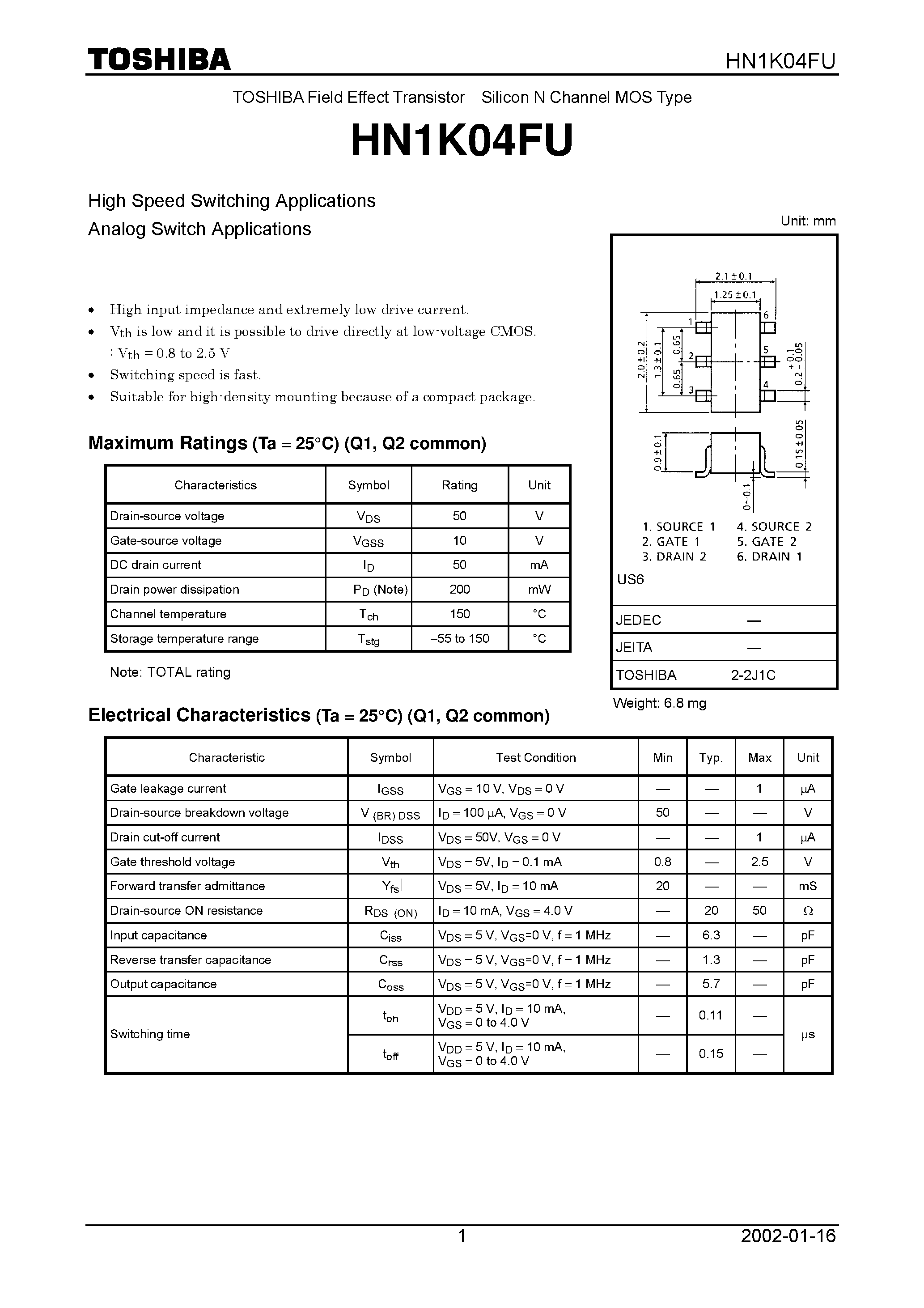

HN1K04FU-TOSHIBA Field Effect Transistor Silicon N Channel MOS Type
Description:TOSHIBA Field Effect Transistor Silicon N Channel MOS Type
Others with the same file: HN1K04FU
Datasheet HN1K04FU - TOSHIBA Field Effect Transistor Silicon N Channel MOS Type page 1

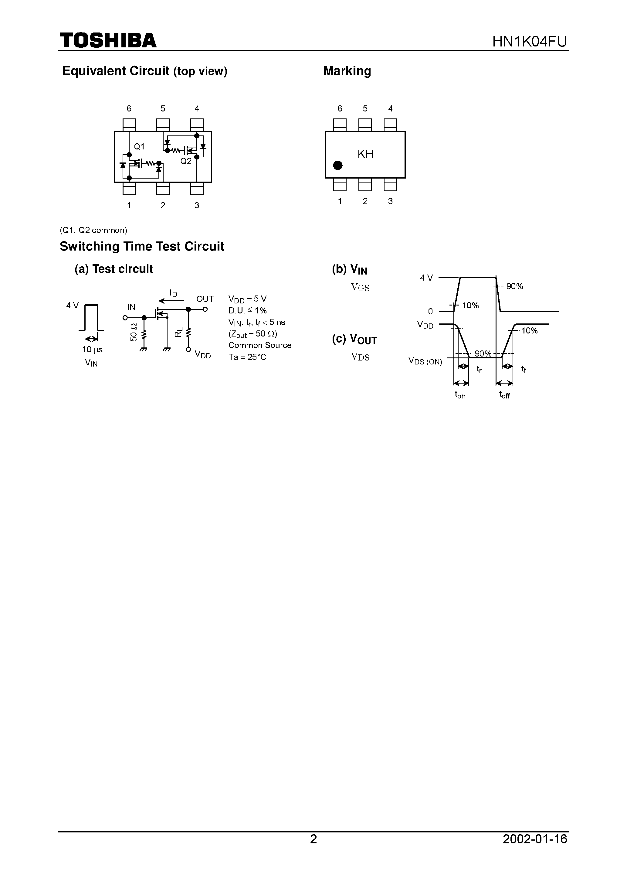

Datasheet HN1K04FU - TOSHIBA Field Effect Transistor Silicon N Channel MOS Type page 2
