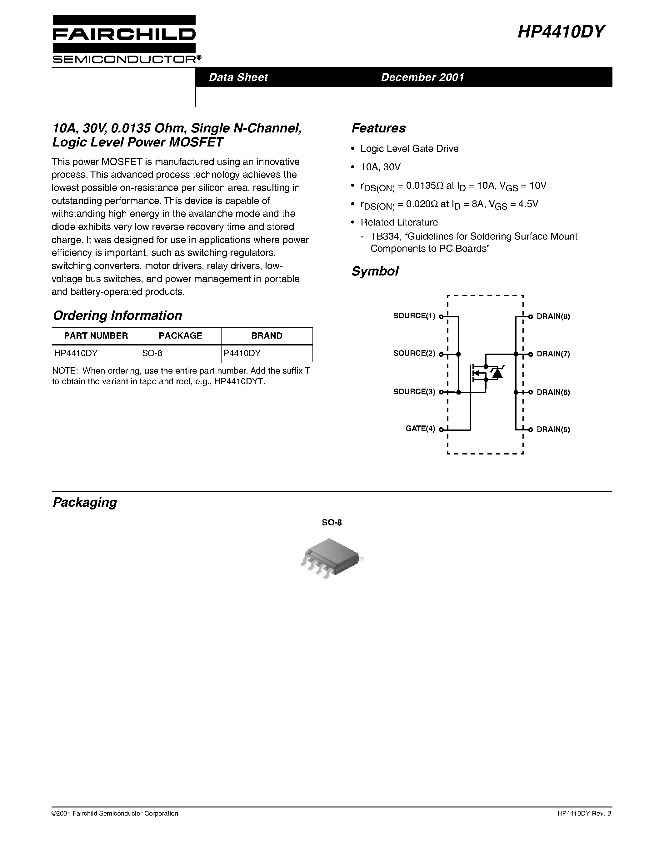

HP4410-10A/ 30V/ 0.0135 Ohm/ Single N-Channel/ Logic Level Power MOSFET
Description:10A/ 30V/ 0.0135 Ohm/ Single N-Channel/ Logic Level Power MOSFET
Others with the same file: HP4410
Datasheet HP4410 - 10A/ 30V/ 0.0135 Ohm/ Single N-Channel/ Logic Level Power MOSFET page 1

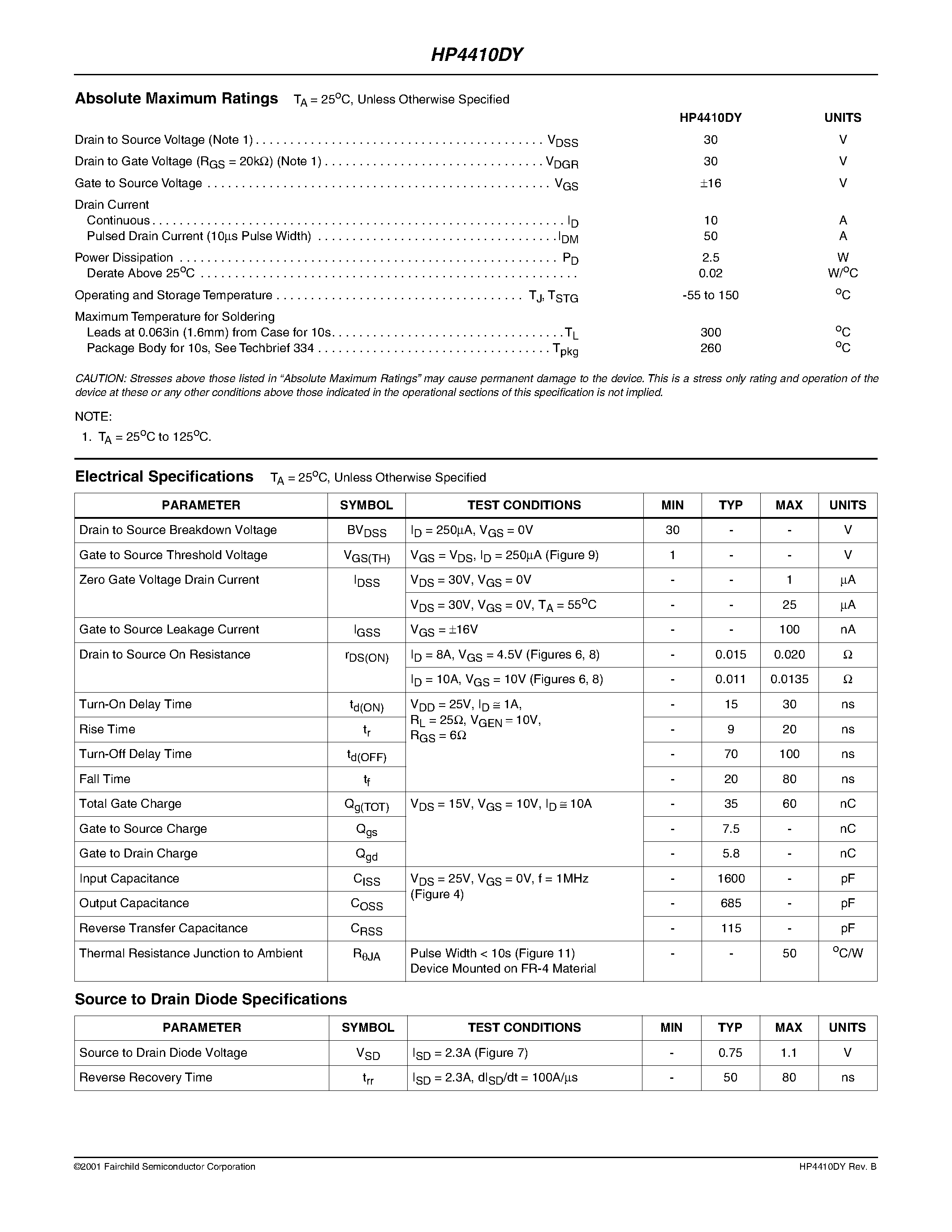

Datasheet HP4410 - 10A/ 30V/ 0.0135 Ohm/ Single N-Channel/ Logic Level Power MOSFET page 2
