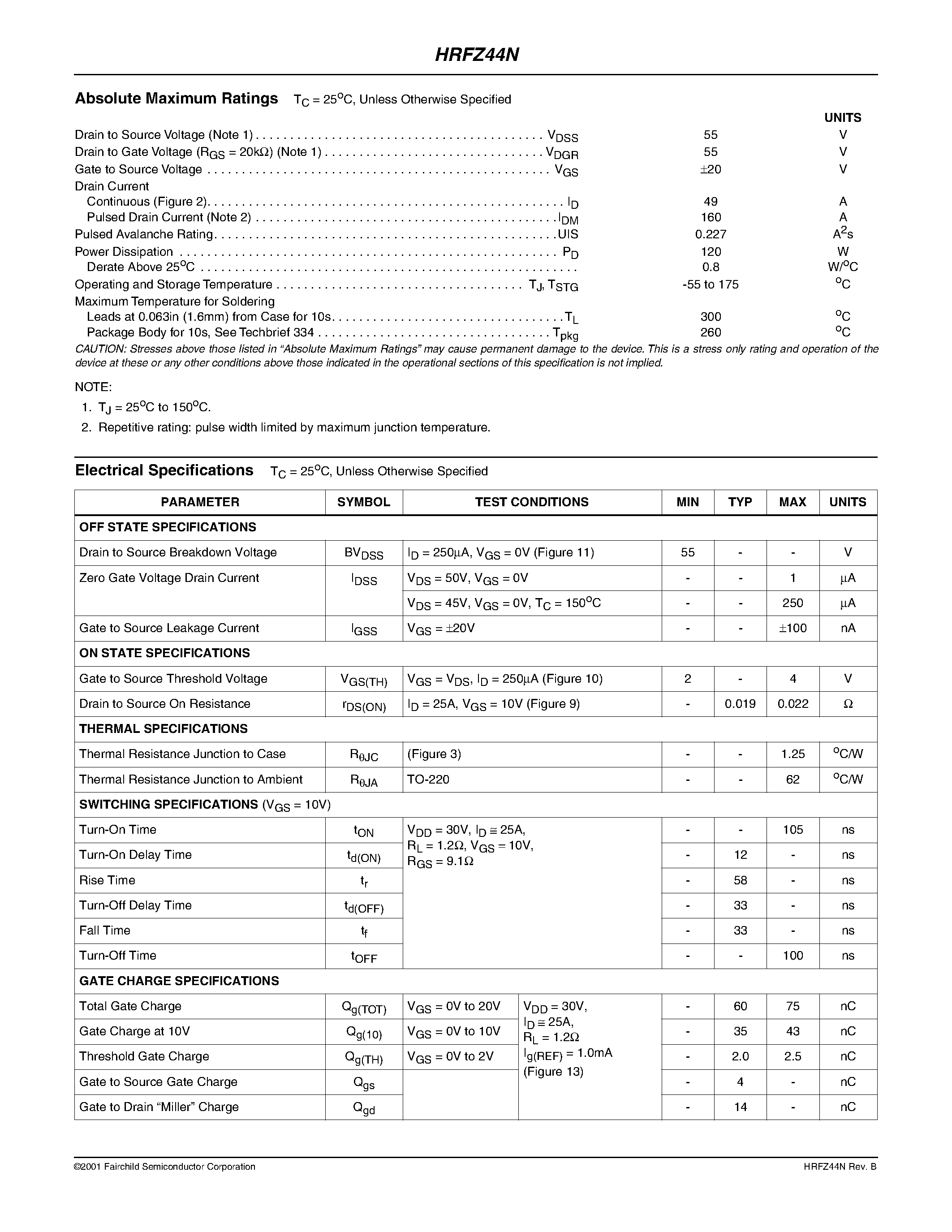

Datasheet HRFZ44N - 49A/ 55V/ 0.022 Ohm/ N-Channel UltraFET Power MOSFET page 2
