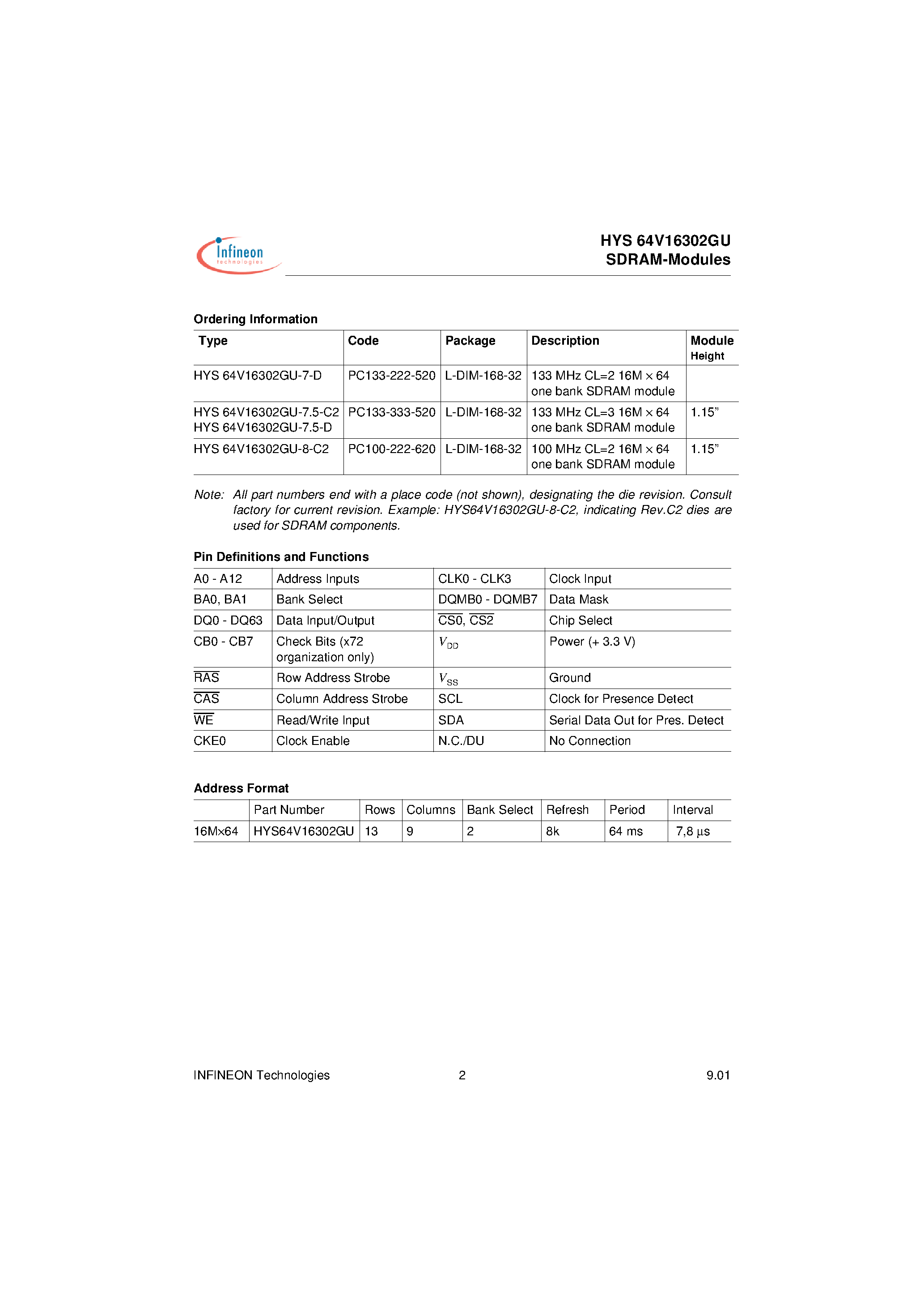

Datasheet HYS64V16302GU - 3.3 V 16M 64-Bit/ 128MByte SDRAM Module 168-pin Unbuffered DIMM Modules page 1

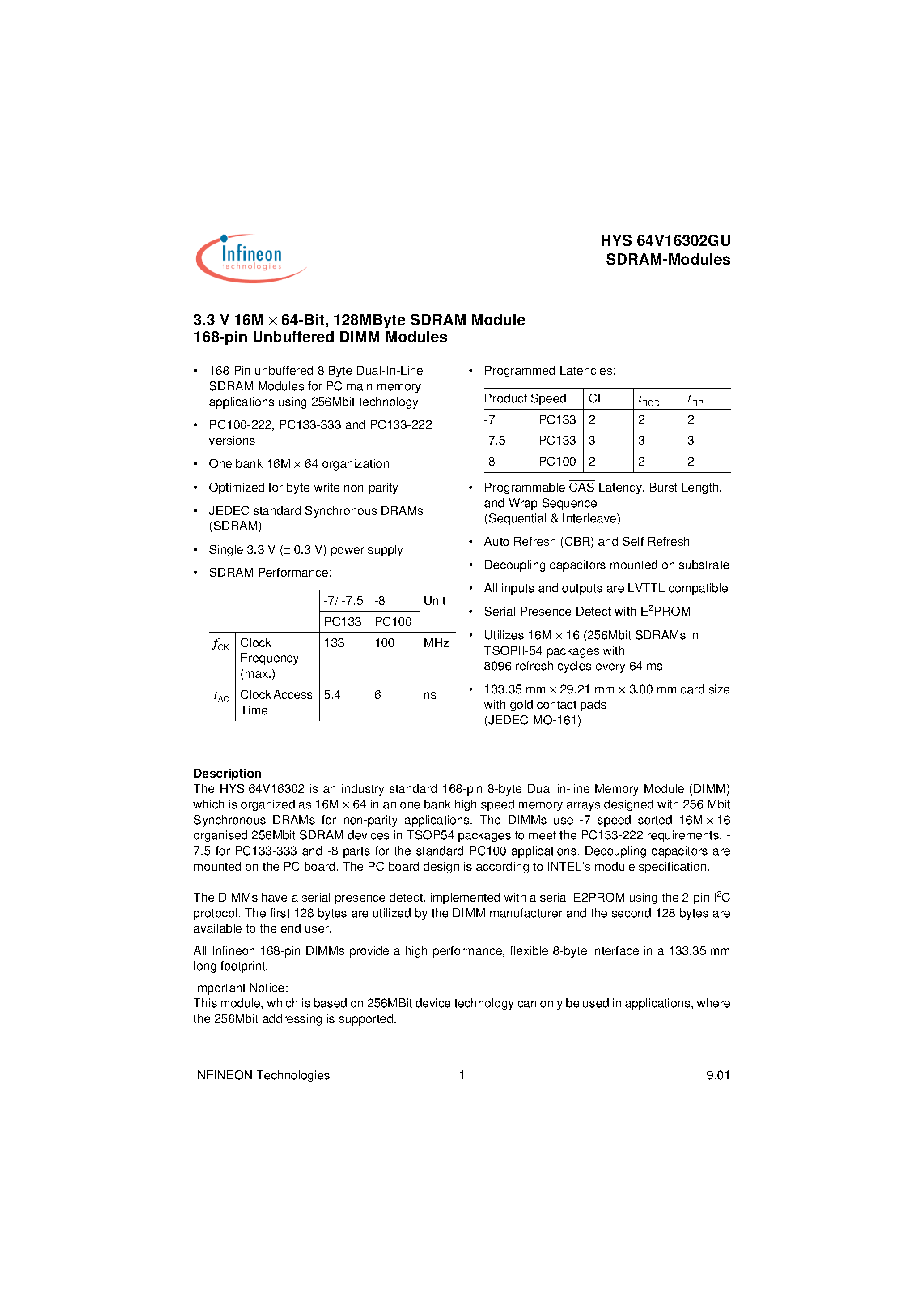

Datasheet HYS64V16302GU - 3.3 V 16M 64-Bit/ 128MByte SDRAM Module 168-pin Unbuffered DIMM Modules page 2
