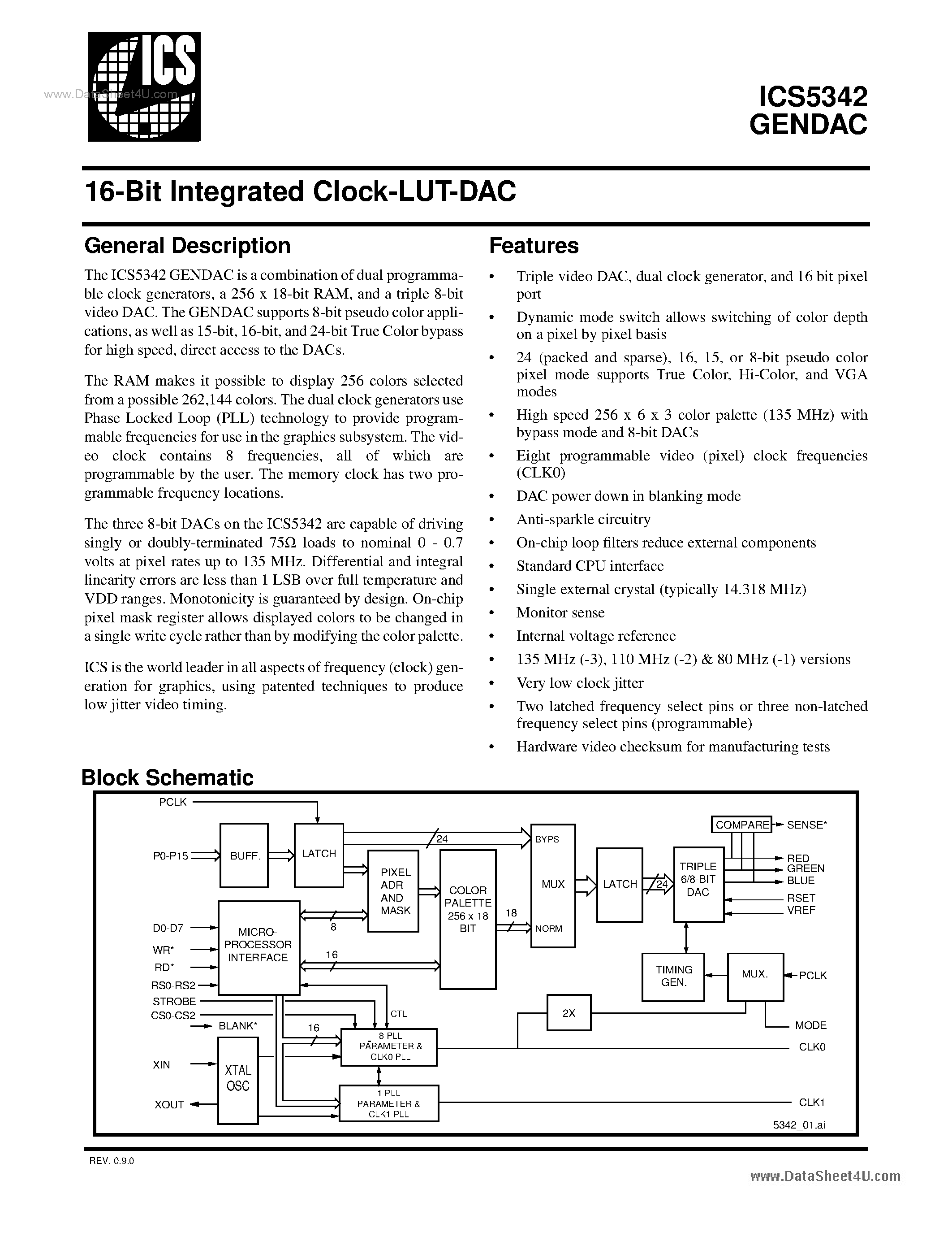

ICS5342-16-Bit Integrated Clock-LUT-DAC
Producer:Integrated Circuit Systems
Description:16-Bit Integrated Clock-LUT-DAC
Others with the same file: ICS5342
Datasheet ICS5342 - 16-Bit Integrated Clock-LUT-DAC page 1

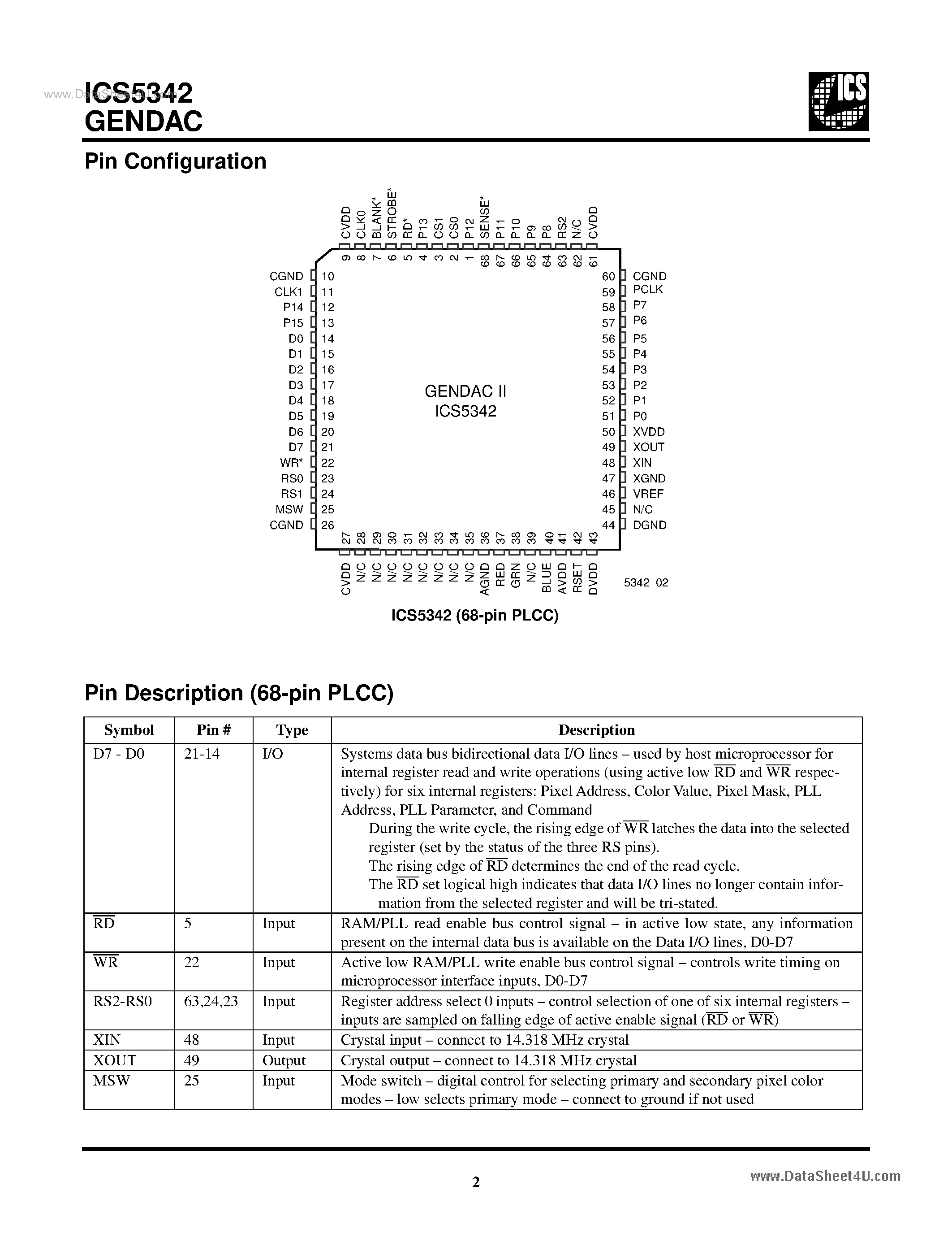

Datasheet ICS5342 - 16-Bit Integrated Clock-LUT-DAC page 2
