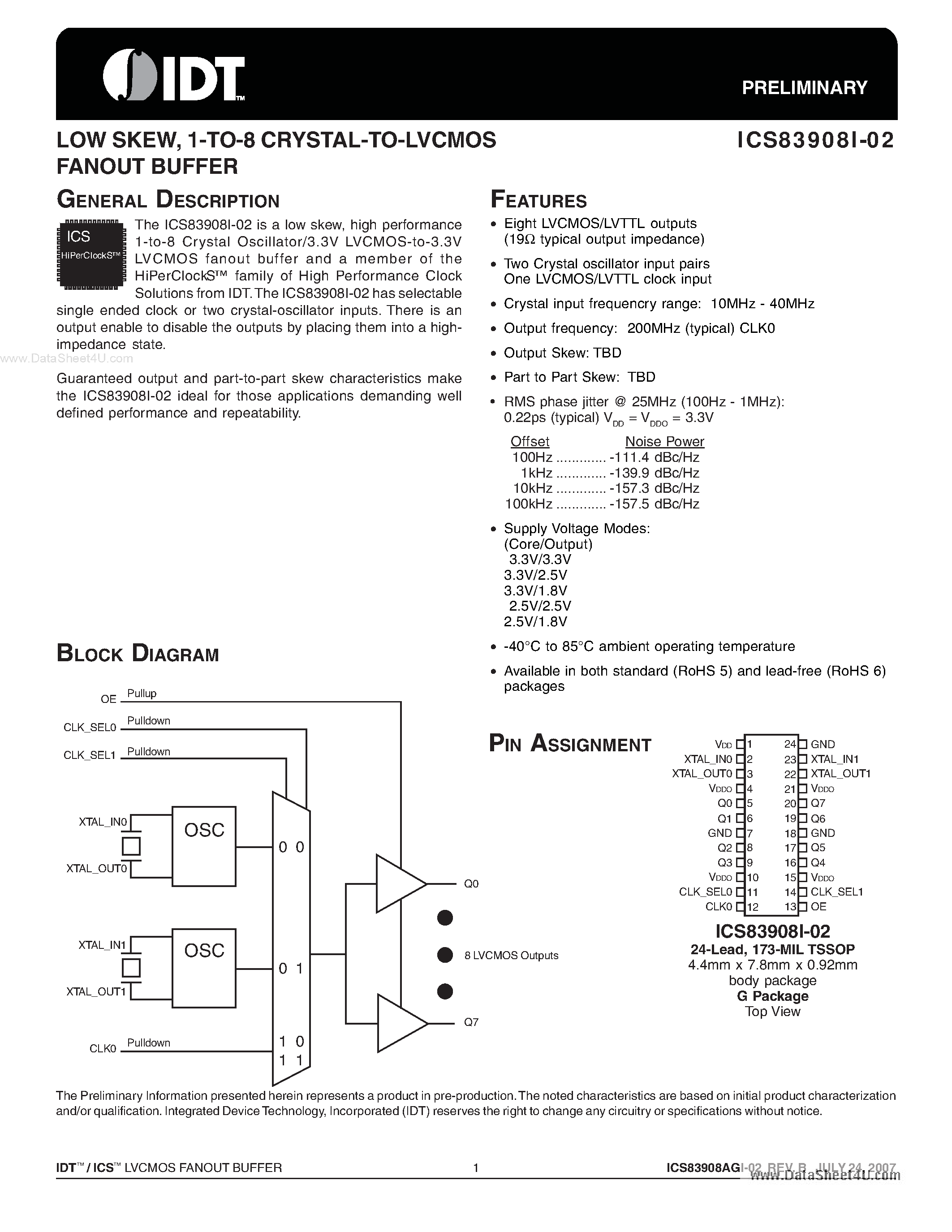

ICS83908I-02-1-TO-8 CRYSTAL-TO-LVCMOS FANOUT BUFFER
Description:1-TO-8 CRYSTAL-TO-LVCMOS FANOUT BUFFER
Others with the same file: ICS83908I-02
Datasheet ICS83908I-02 - 1-TO-8 CRYSTAL-TO-LVCMOS FANOUT BUFFER page 1

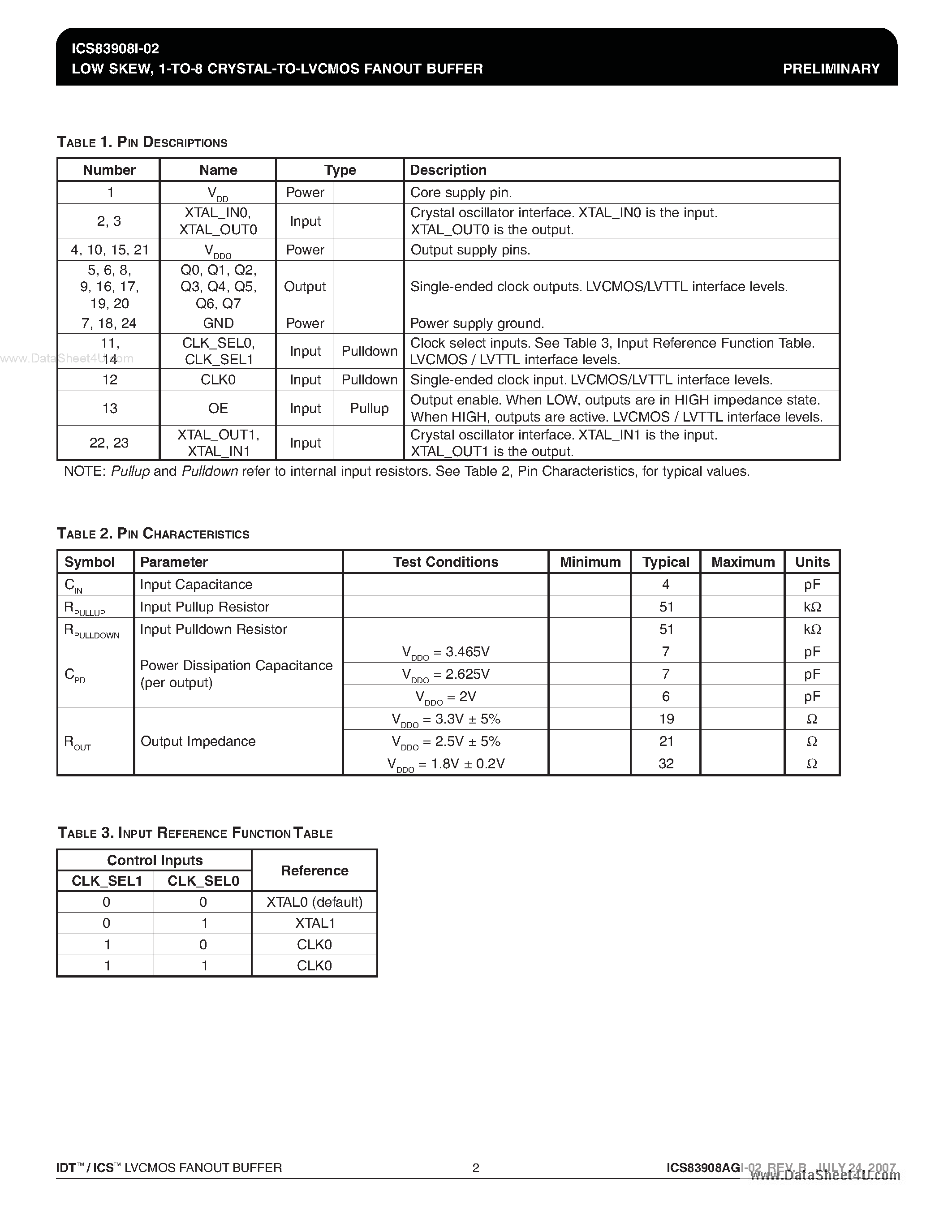

Datasheet ICS83908I-02 - 1-TO-8 CRYSTAL-TO-LVCMOS FANOUT BUFFER page 2
