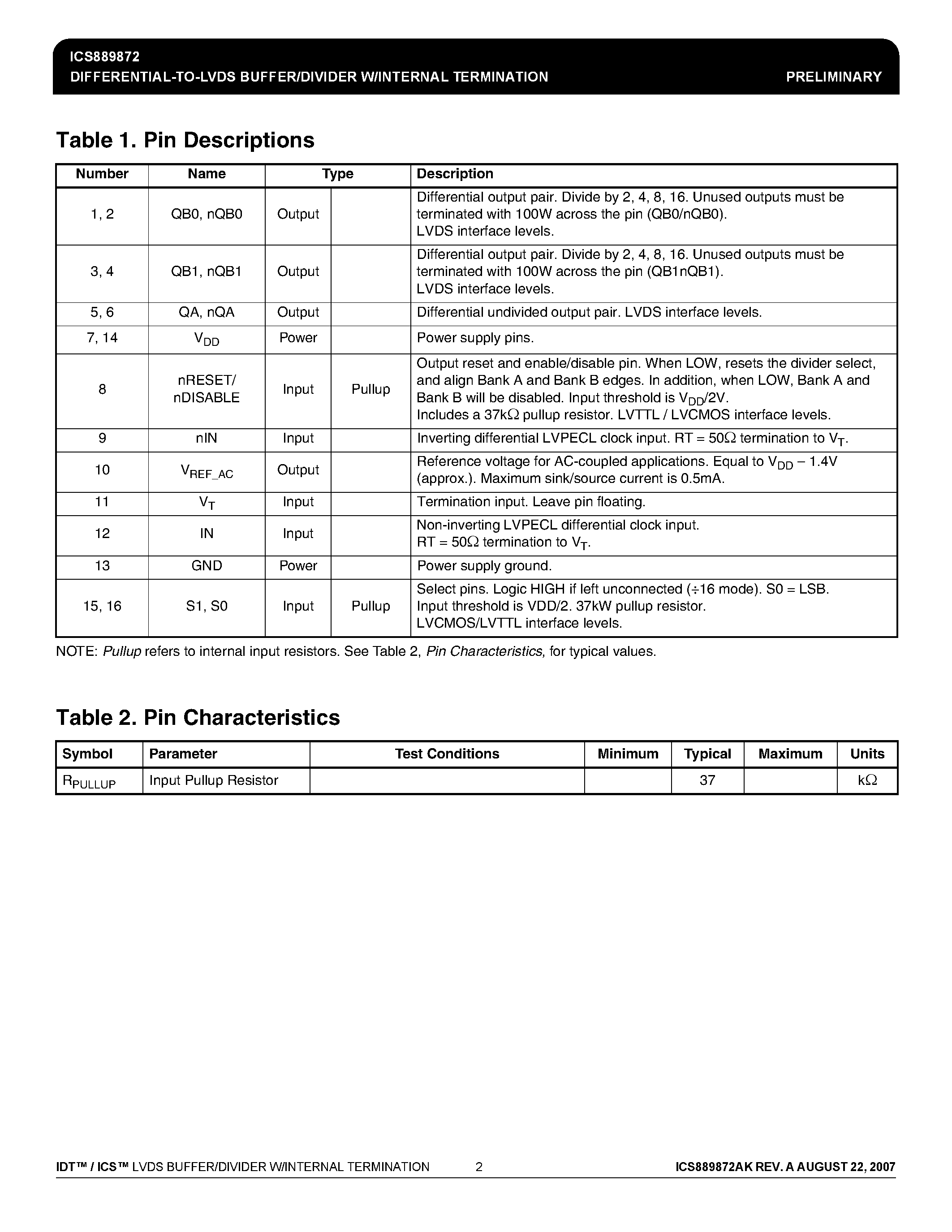

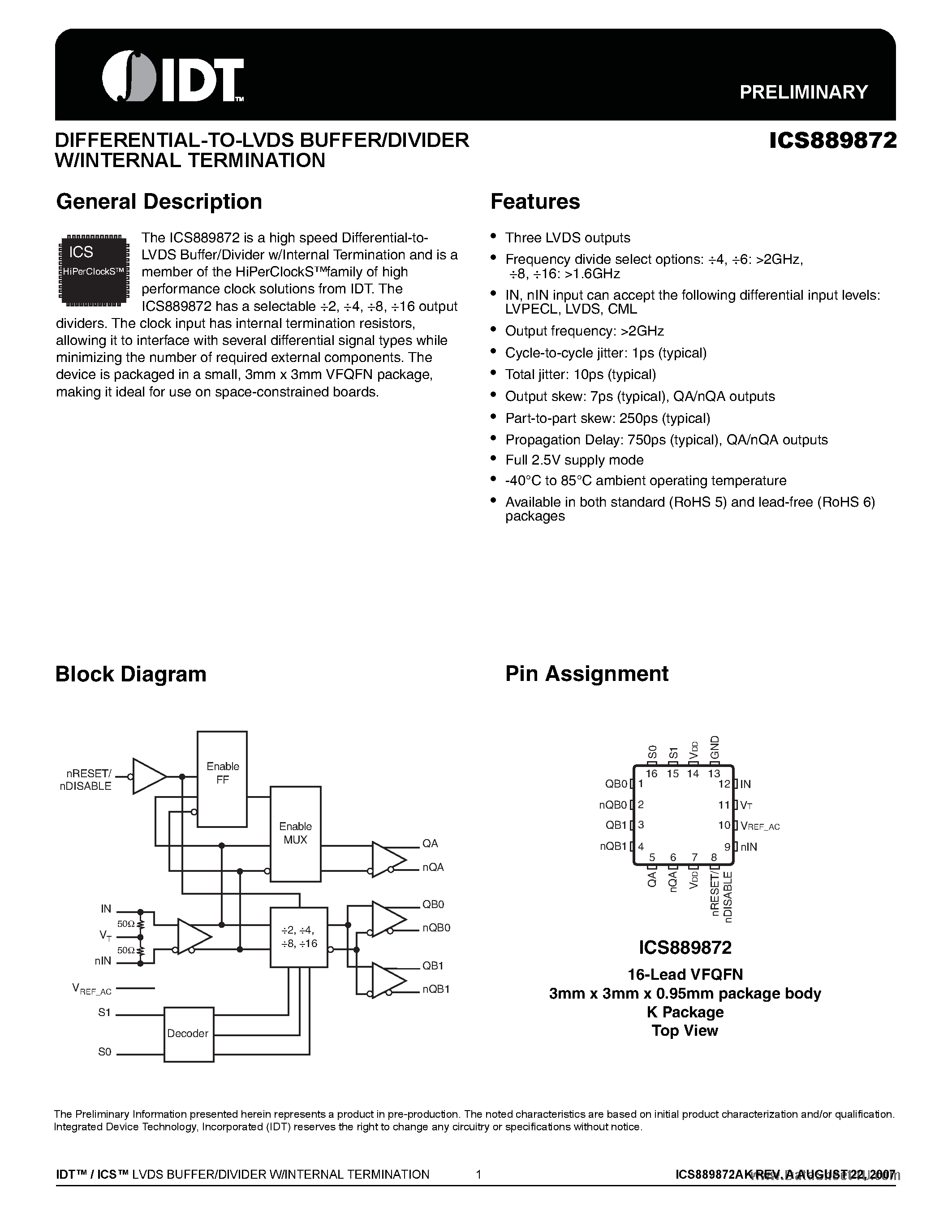

ICS889872-DIFFERENTIAL-TO-LVDS BUFFER/DIVIDER W/INTERNAL TERMINATION
Producer:IDT
Description:DIFFERENTIAL-TO-LVDS BUFFER/DIVIDER W/INTERNAL TERMINATION
Others with the same file: ICS889872
Datasheet ICS889872 - DIFFERENTIAL-TO-LVDS BUFFER/DIVIDER W/INTERNAL TERMINATION page 1
Datasheet ICS889872 - DIFFERENTIAL-TO-LVDS BUFFER/DIVIDER W/INTERNAL TERMINATION page 2
