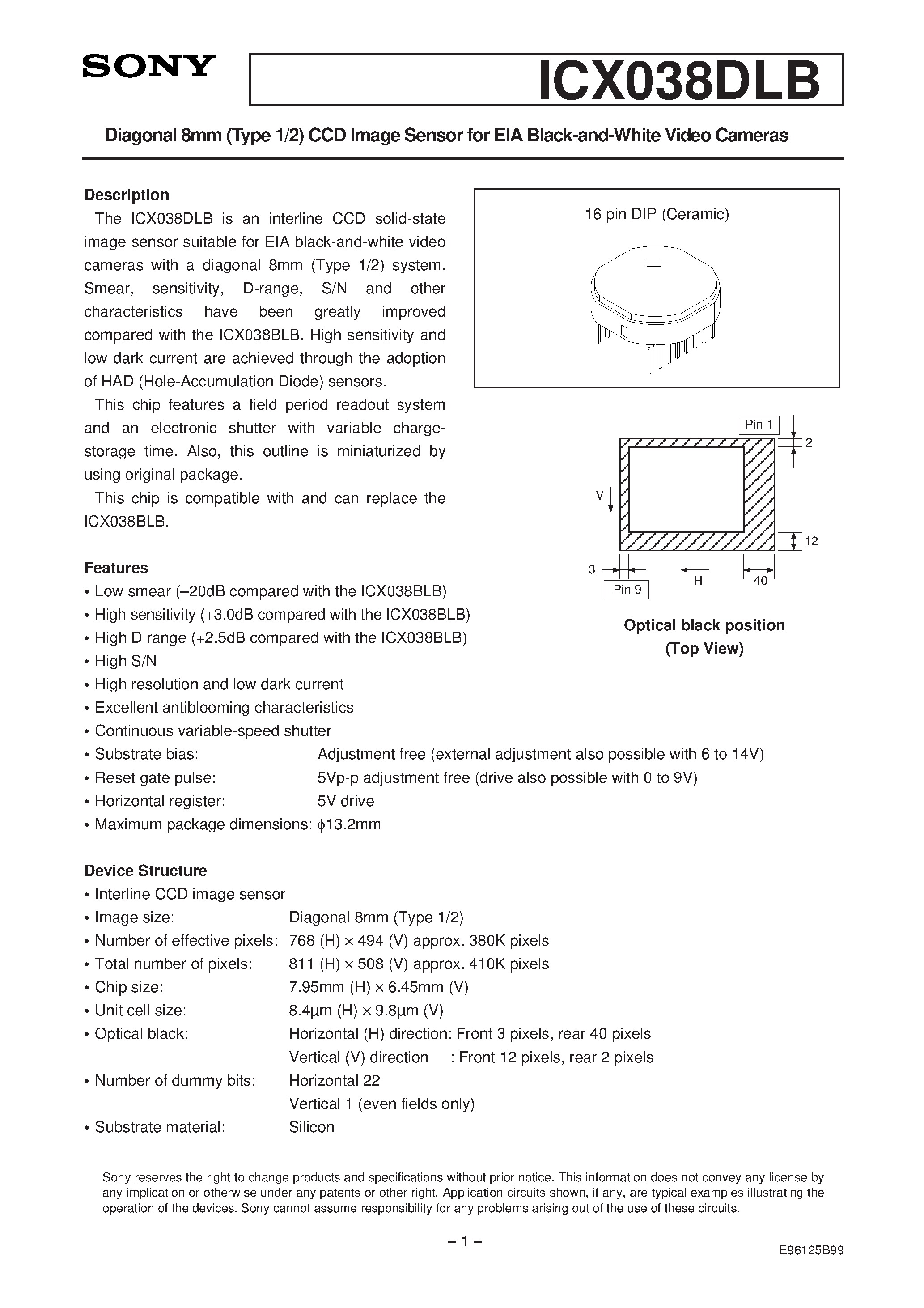

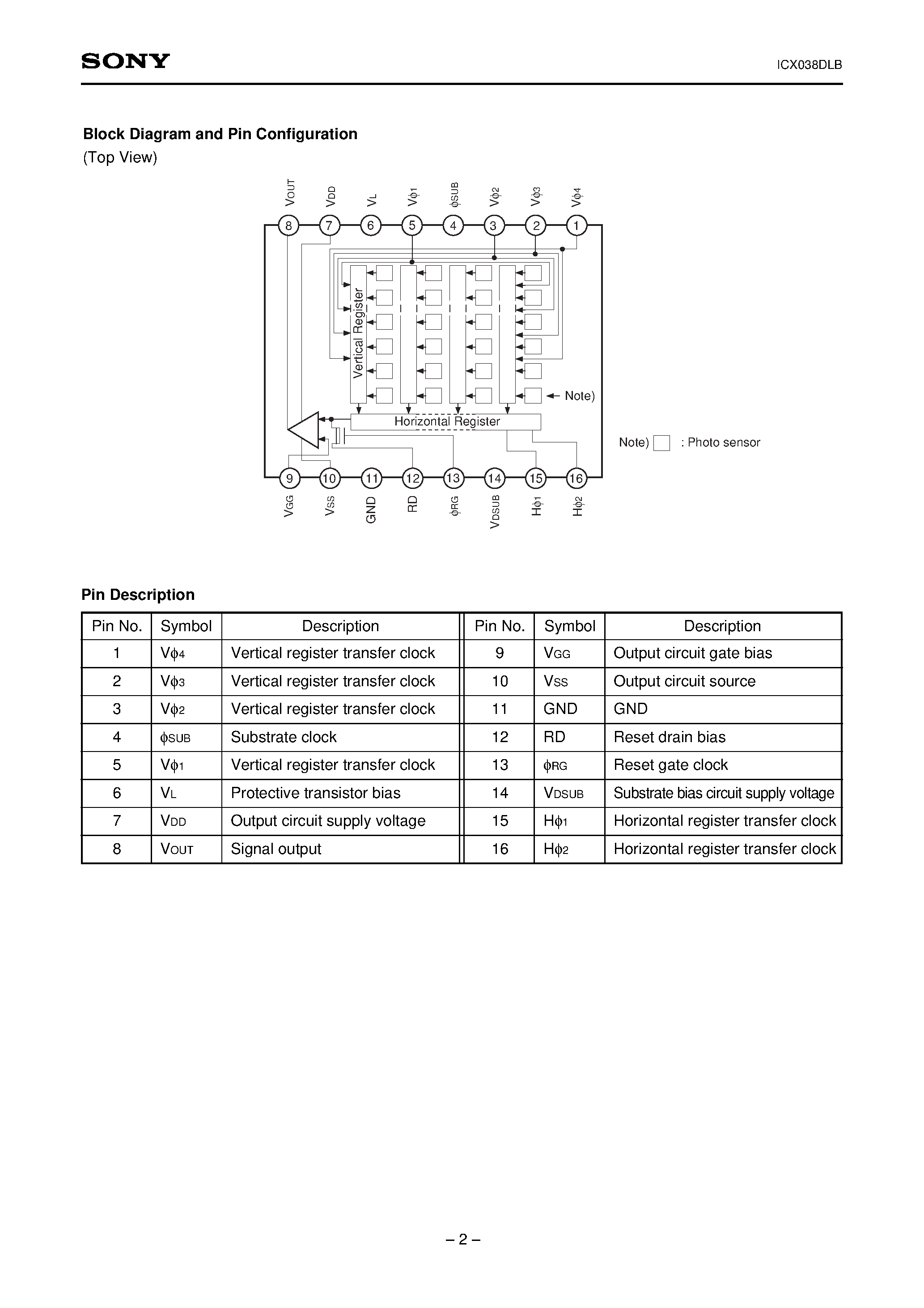

ICX038DLB-Diagonal 8mm (Type 1/2) CCD Image Sensor for EIA Black-and-White Video Cameras
Producer:Sony Corporation
Description:Diagonal 8mm (Type 1/2) CCD Image Sensor for EIA Black-and-White Video Cameras
