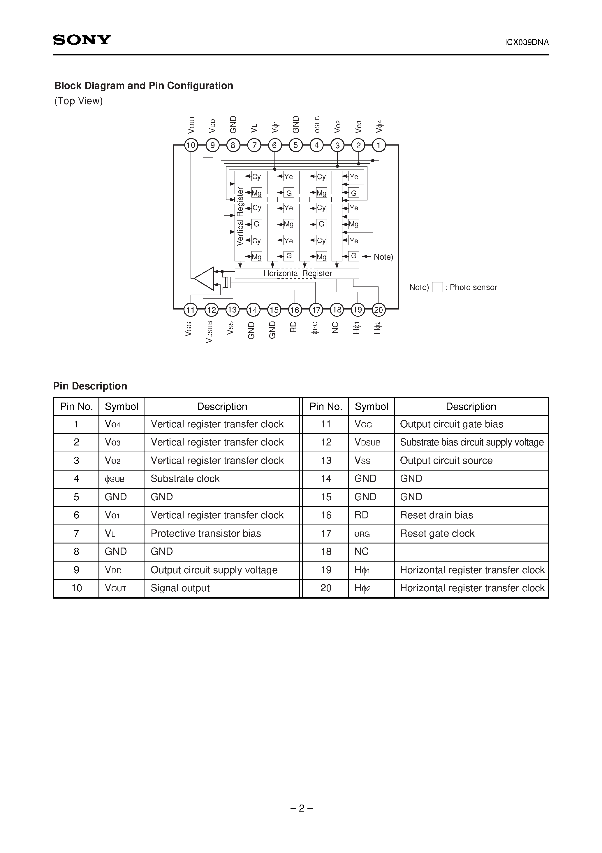

Datasheet ICX039DNA - Diagonal 8mm (Type 1/2) CCD Image Sensor for PAL Color Video Cameras page 1
Datasheet ICX039DNA - Diagonal 8mm (Type 1/2) CCD Image Sensor for PAL Color Video Cameras page 2
