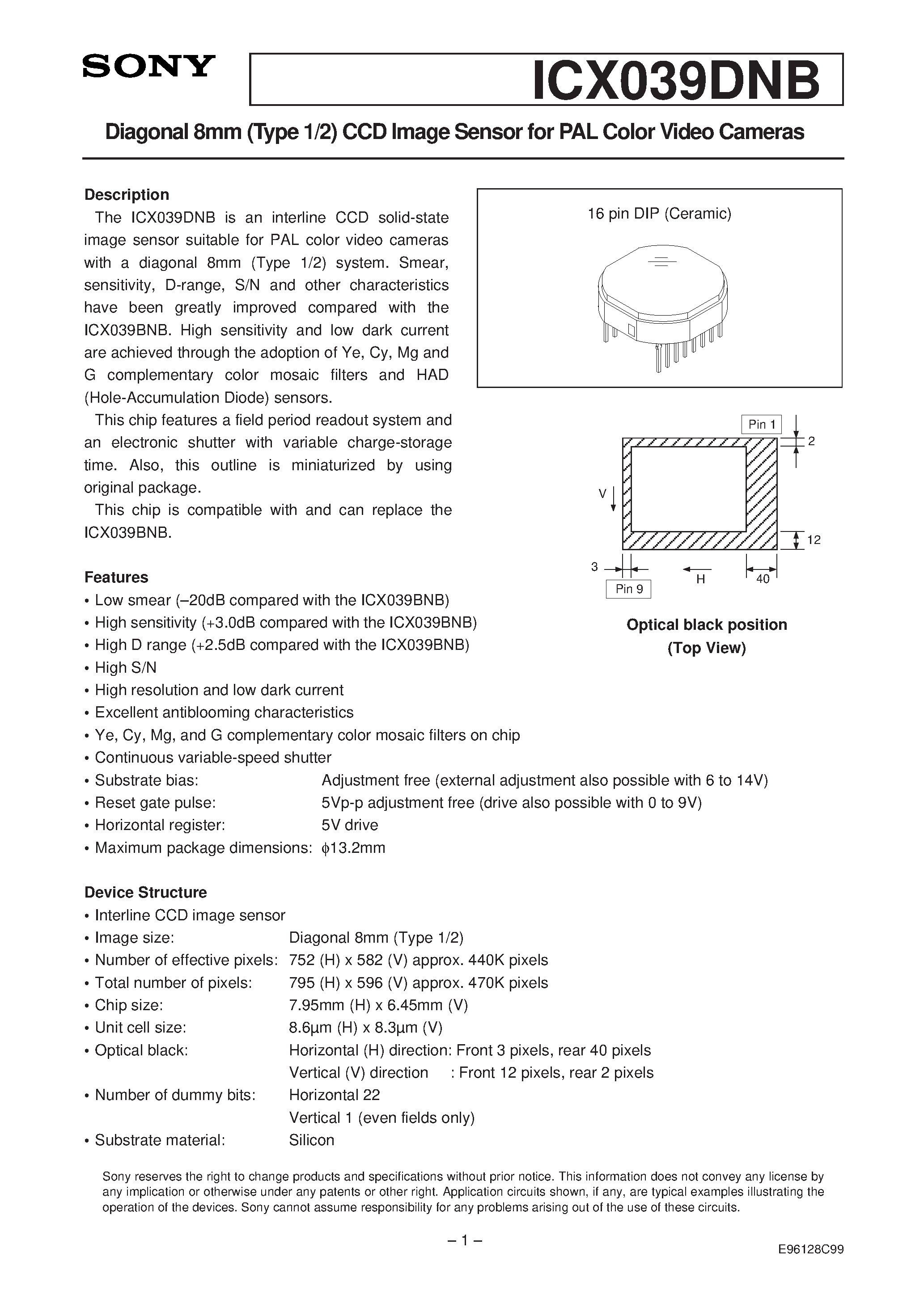

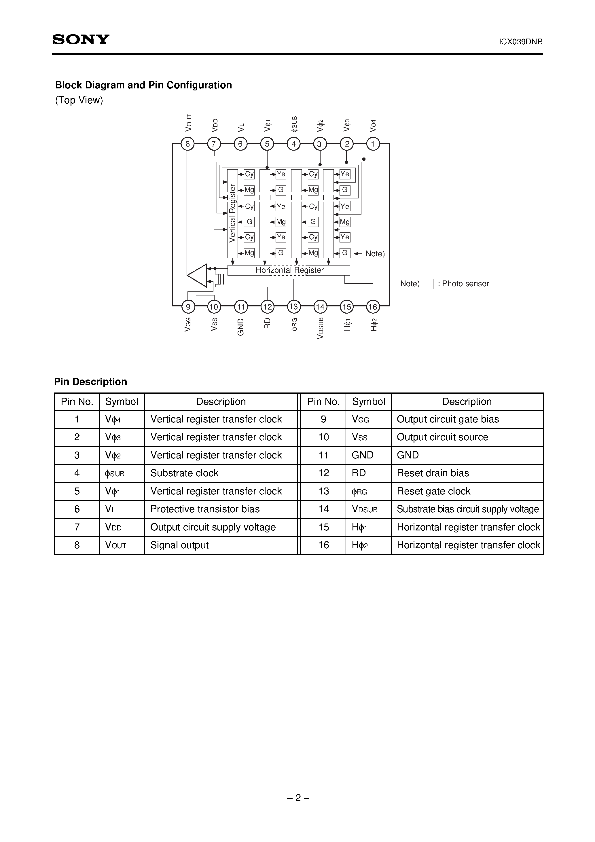

ICX039DNB-Diagonal 8mm (Type 1/2) CCD Image Sensor for PAL Color Video Cameras
Producer:Sony Corporation
Description:Diagonal 8mm (Type 1/2) CCD Image Sensor for PAL Color Video Cameras
