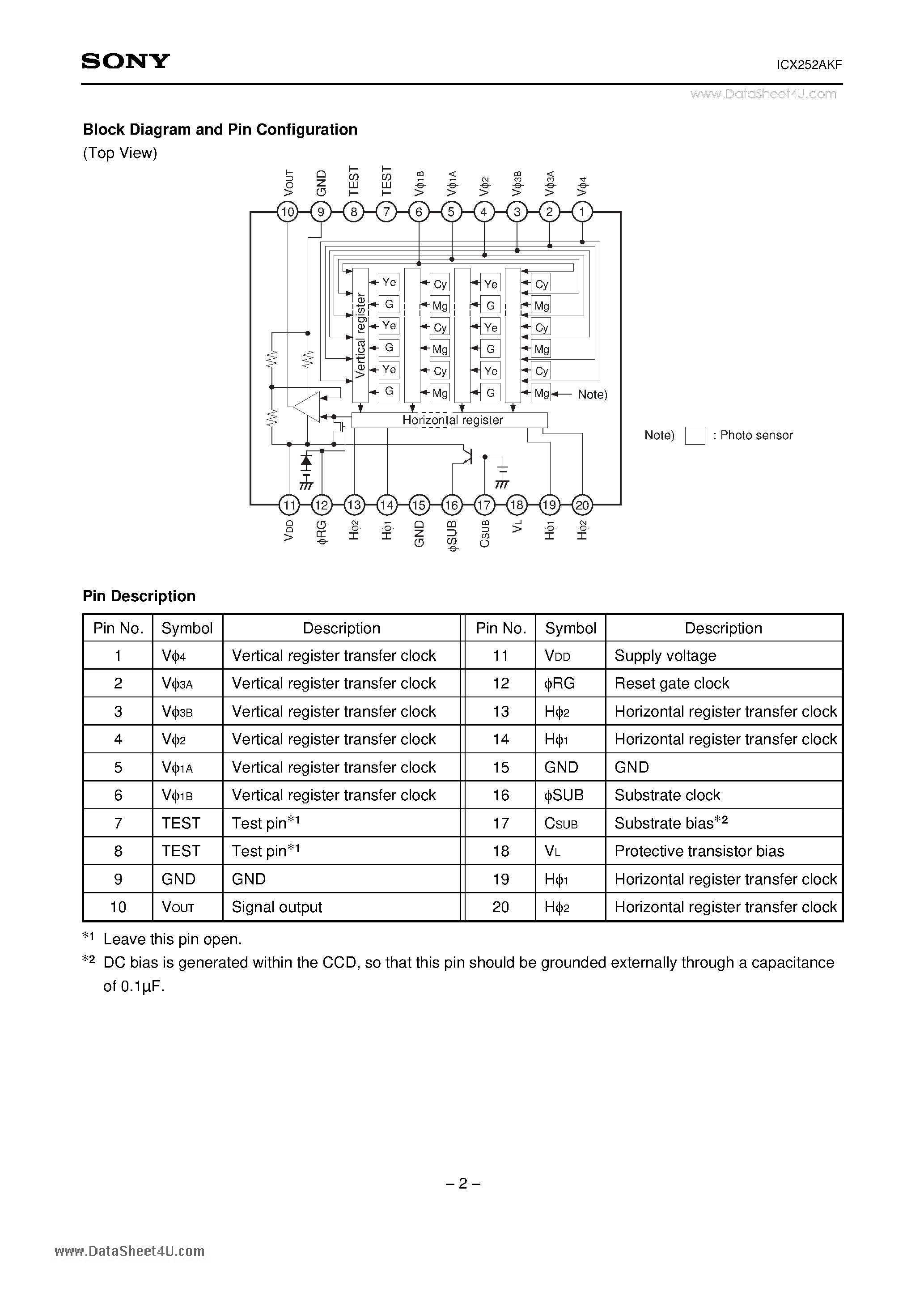

ICX252AKF-Diagonal 8.933mm (Type 1/1.8) Frame Readout CCD Image Sensor
Producer:Sony Corporation
Description:Diagonal 8.933mm (Type 1/1.8) Frame Readout CCD Image Sensor
