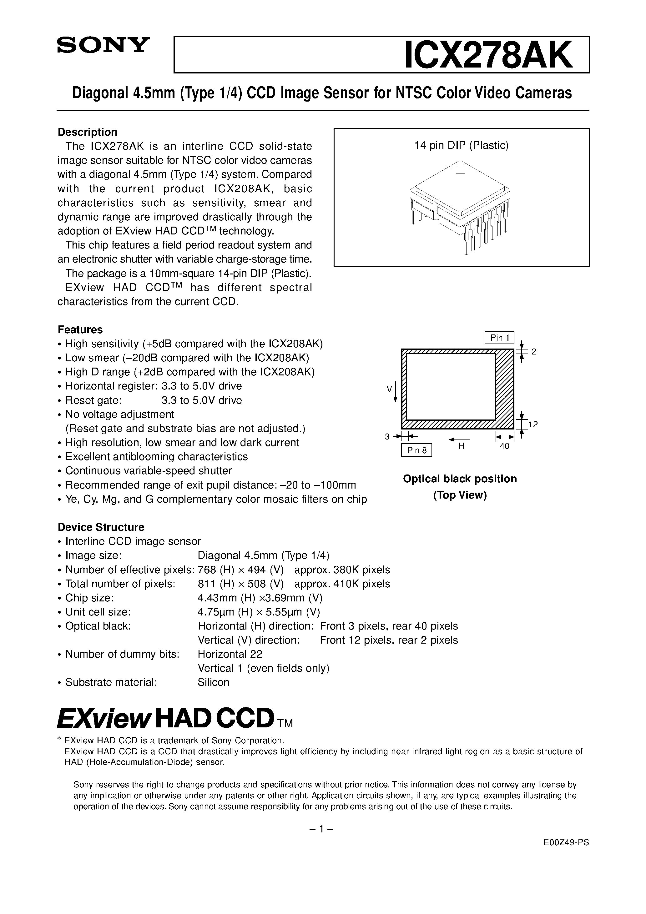

ICX278AK-Diagonal 4.5mm (Type 1/4) CCD Image Sensor for NTSC Color Video Cameras
Producer:Sony Corporation
Description:Diagonal 4.5mm (Type 1/4) CCD Image Sensor for NTSC Color Video Cameras
Others with the same file: ICX278AK

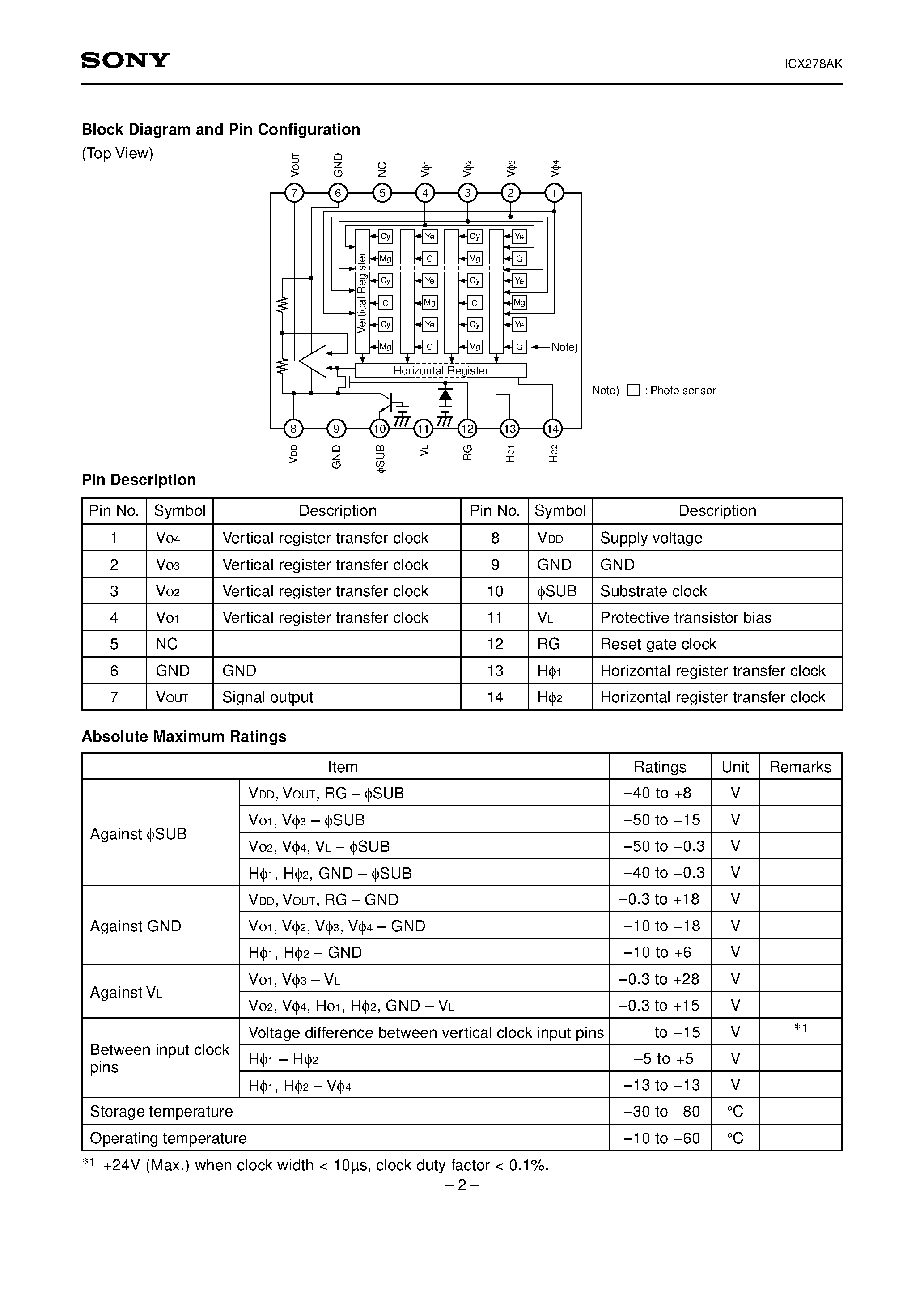

Datasheet ICX278AK - Diagonal 4.5mm (Type 1/4) CCD Image Sensor for NTSC Color Video Cameras page 1
Datasheet ICX278AK - Diagonal 4.5mm (Type 1/4) CCD Image Sensor for NTSC Color Video Cameras page 2
