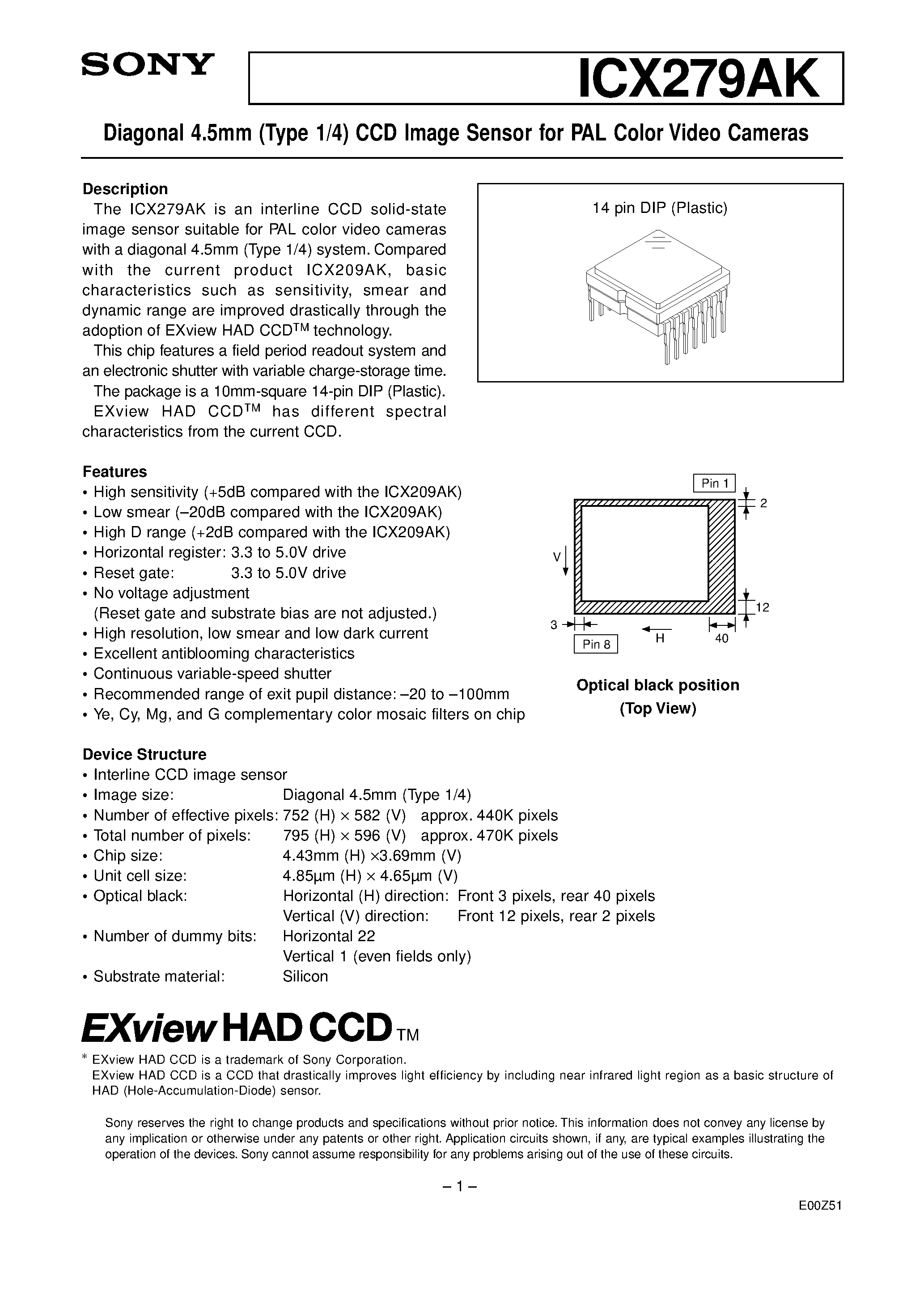

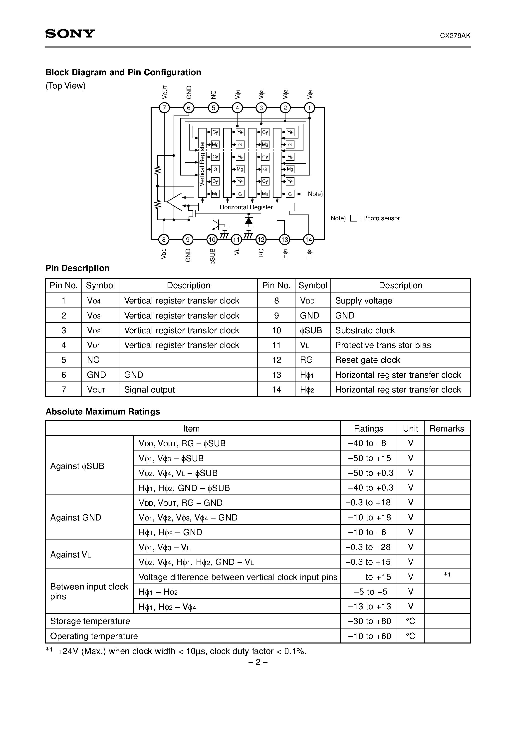

ICX279AK-Diagonal 4.5mm (Type 1/4) CCD Image Sensor for PAL Color Video Cameras
Producer:Sony Corporation
Description:Diagonal 4.5mm (Type 1/4) CCD Image Sensor for PAL Color Video Cameras
