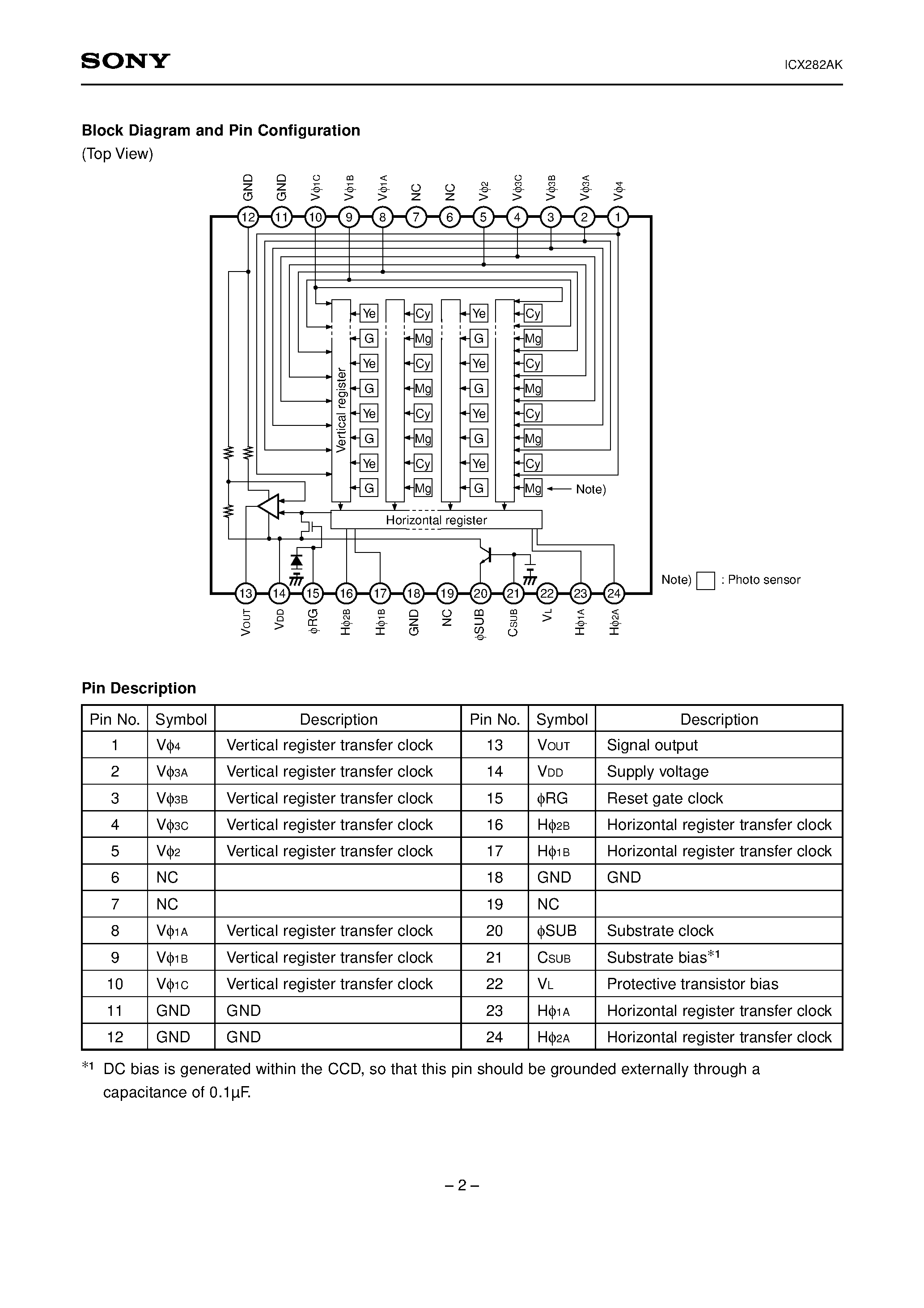

ICX282AK-Diagonal 11mm (Type 2/3) Frame Readout CCD Image Sensor
Producer:Sony Corporation
Description:Diagonal 11mm (Type 2/3) Frame Readout CCD Image Sensor
