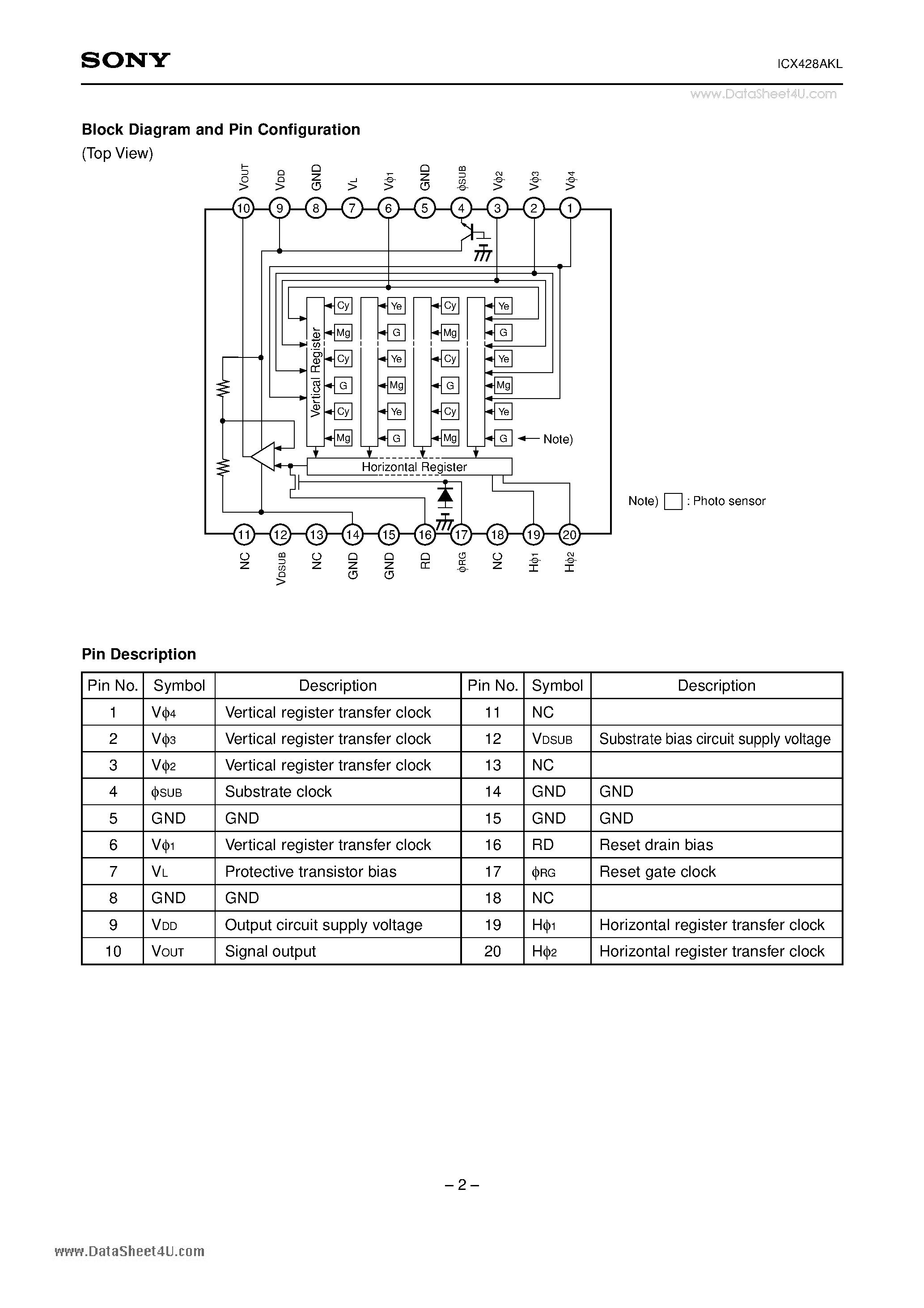

ICX428AKL-Diagonal 8mm (Type 1/2) CCD Image Sensor
Producer:Sony Corporation
Description:Diagonal 8mm (Type 1/2) CCD Image Sensor
Others with the same file: ICX428AKL
Datasheet ICX428AKL - Diagonal 8mm (Type 1/2) CCD Image Sensor page 1
Datasheet ICX428AKL - Diagonal 8mm (Type 1/2) CCD Image Sensor page 2
