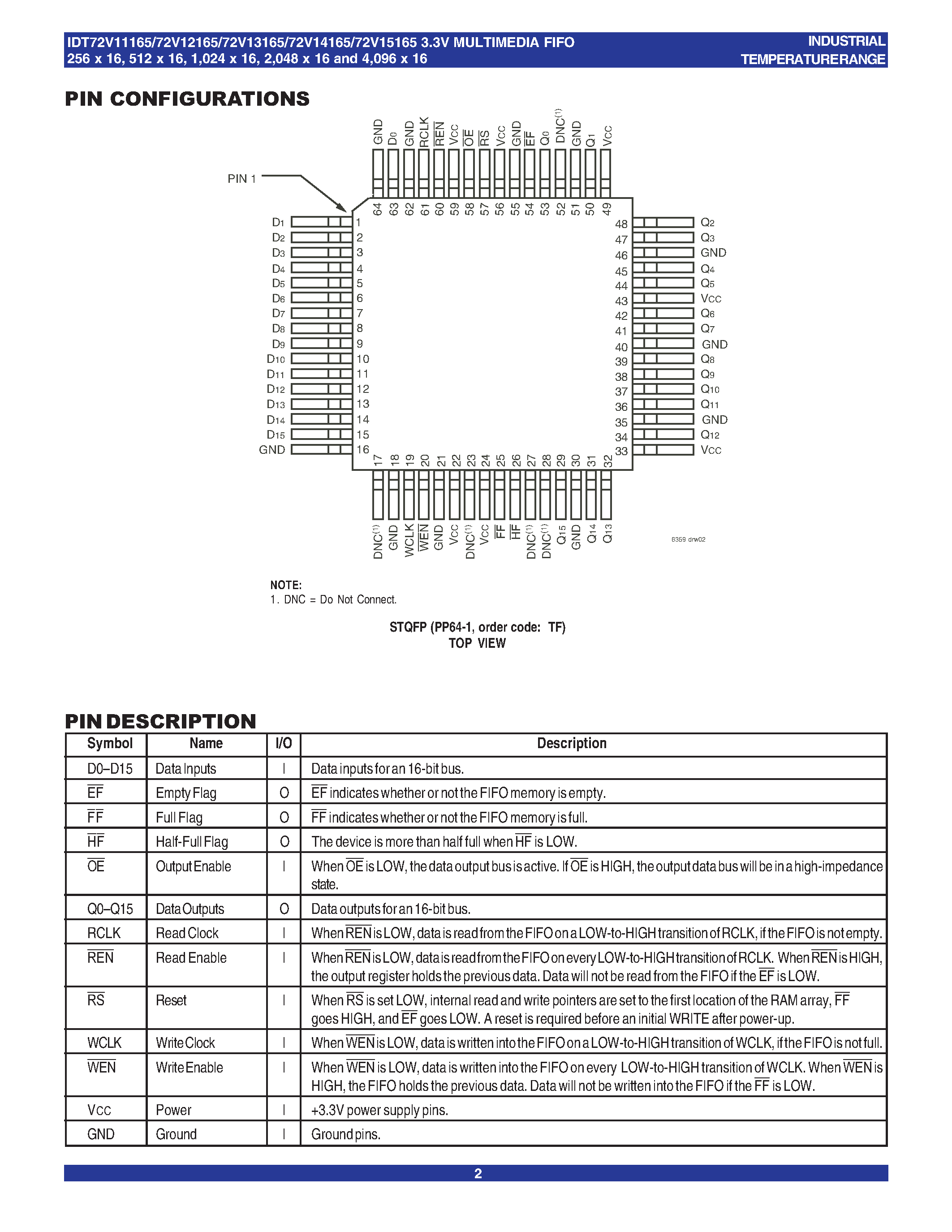

IDT72V12165-3.3 VOLT MULTIMEDIA FIFO 256 x 16/ 512 x 16/ 1/024 x 16/ 2/048 x 16/ and 4/096 x 16
Description:3.3 VOLT MULTIMEDIA FIFO 256 x 16/ 512 x 16/ 1/024 x 16/ 2/048 x 16/ and 4/096 x 16
Others with the same file: IDT72V12165
Datasheet IDT72V12165 - 3.3 VOLT MULTIMEDIA FIFO 256 x 16/ 512 x 16/ 1/024 x 16/ 2/048 x 16/ and 4/096 x 16 page 1
Datasheet IDT72V12165 - 3.3 VOLT MULTIMEDIA FIFO 256 x 16/ 512 x 16/ 1/024 x 16/ 2/048 x 16/ and 4/096 x 16 page 2
