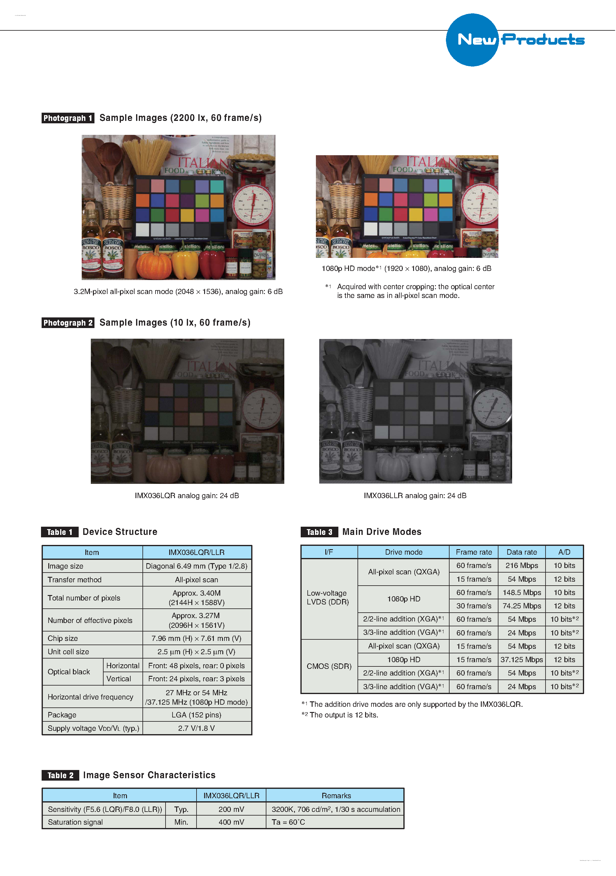

IMX036LLR-Diagonal 6.49 mm (Type 1/2.8) 3.27M-Effective Pixel CMOS Sensors
Producer:Sony
Description:Diagonal 6.49 mm (Type 1/2.8) 3.27M-Effective Pixel CMOS Sensors
