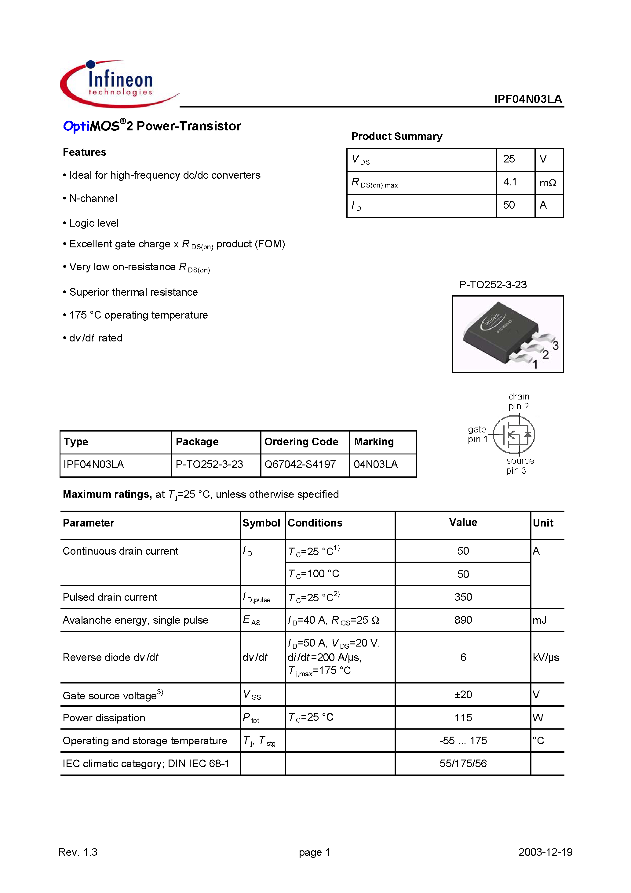

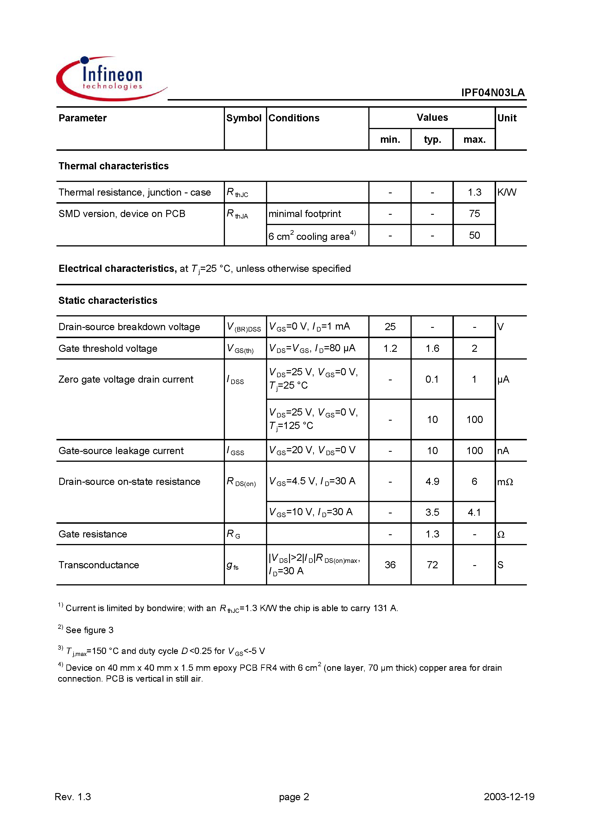

IPF04N03LA-OptiMOS 2 Power-Transistor
Description:OptiMOS 2 Power-Transistor
Others with the same file: IPF04N03LA
Datasheet IPF04N03LA - OptiMOS 2 Power-Transistor page 1
Datasheet IPF04N03LA - OptiMOS 2 Power-Transistor page 2
