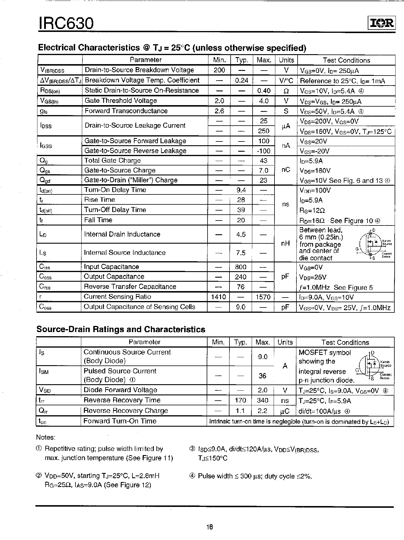

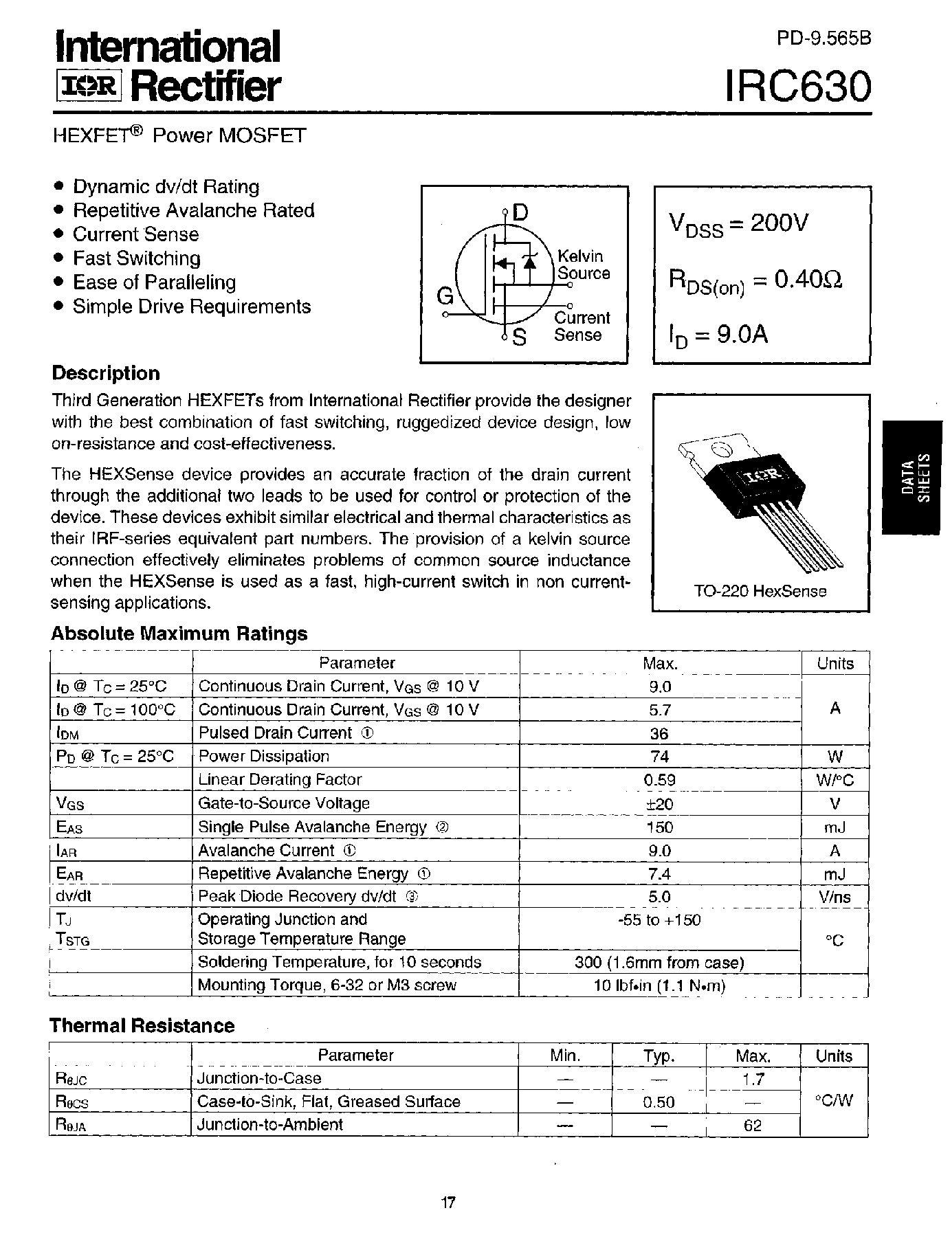

IRC630-Power MOSFET(Vdss=200V/ Rds(on)=0.40ohm/ Id=9.0A)
Description:Power MOSFET(Vdss=200V/ Rds(on)=0.40ohm/ Id=9.0A)
Others with the same file: IRC630
Datasheet IRC630 - Power MOSFET(Vdss=200V/ Rds(on)=0.40ohm/ Id=9.0A) page 1
Datasheet IRC630 - Power MOSFET(Vdss=200V/ Rds(on)=0.40ohm/ Id=9.0A) page 2
