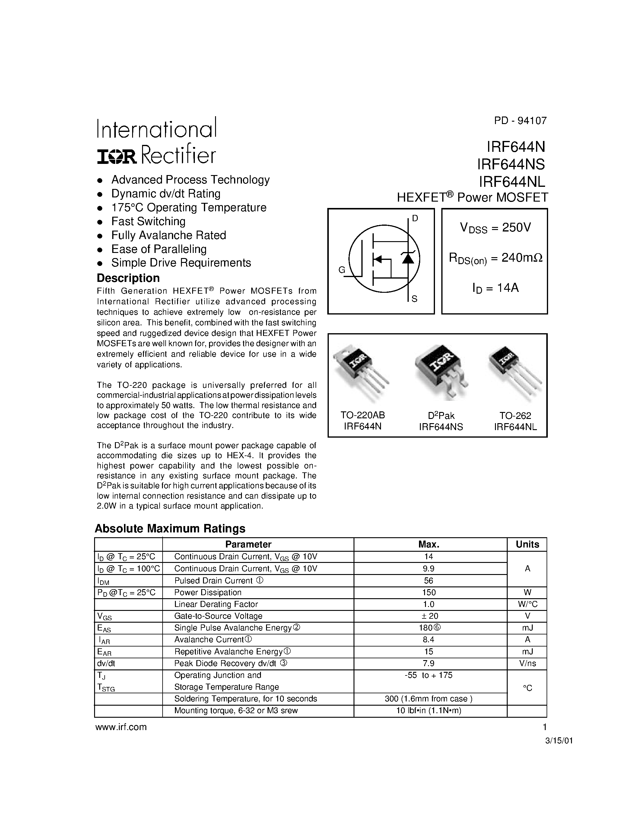

IRF644NL-Power MOSFET(Vdss=250V/ Rds(on)=240mohm/ Id=14A)
Description:Power MOSFET(Vdss=250V/ Rds(on)=240mohm/ Id=14A)
Others with the same file: IRF644NL
Datasheet IRF644NL - Power MOSFET(Vdss=250V/ Rds(on)=240mohm/ Id=14A) page 1

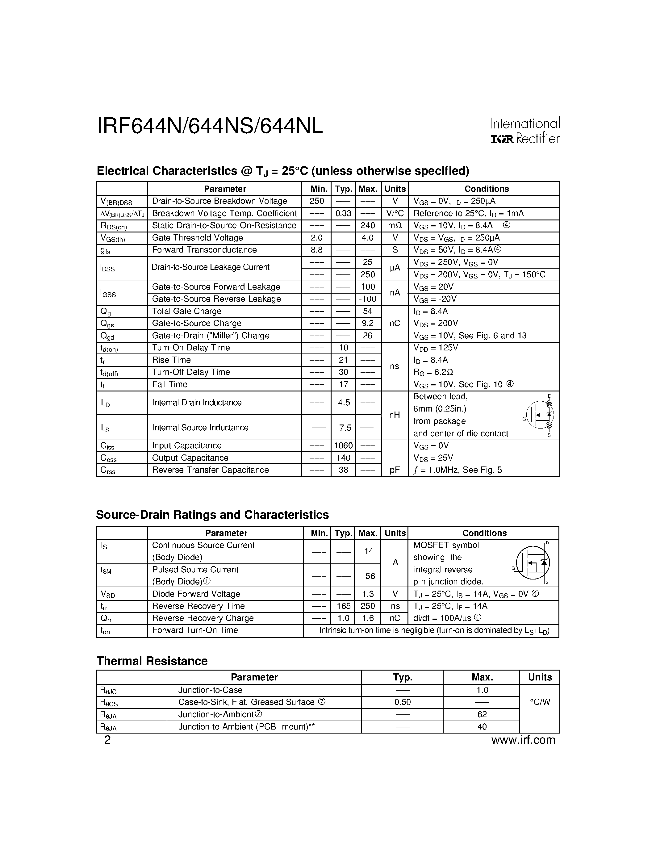

Datasheet IRF644NL - Power MOSFET(Vdss=250V/ Rds(on)=240mohm/ Id=14A) page 2
