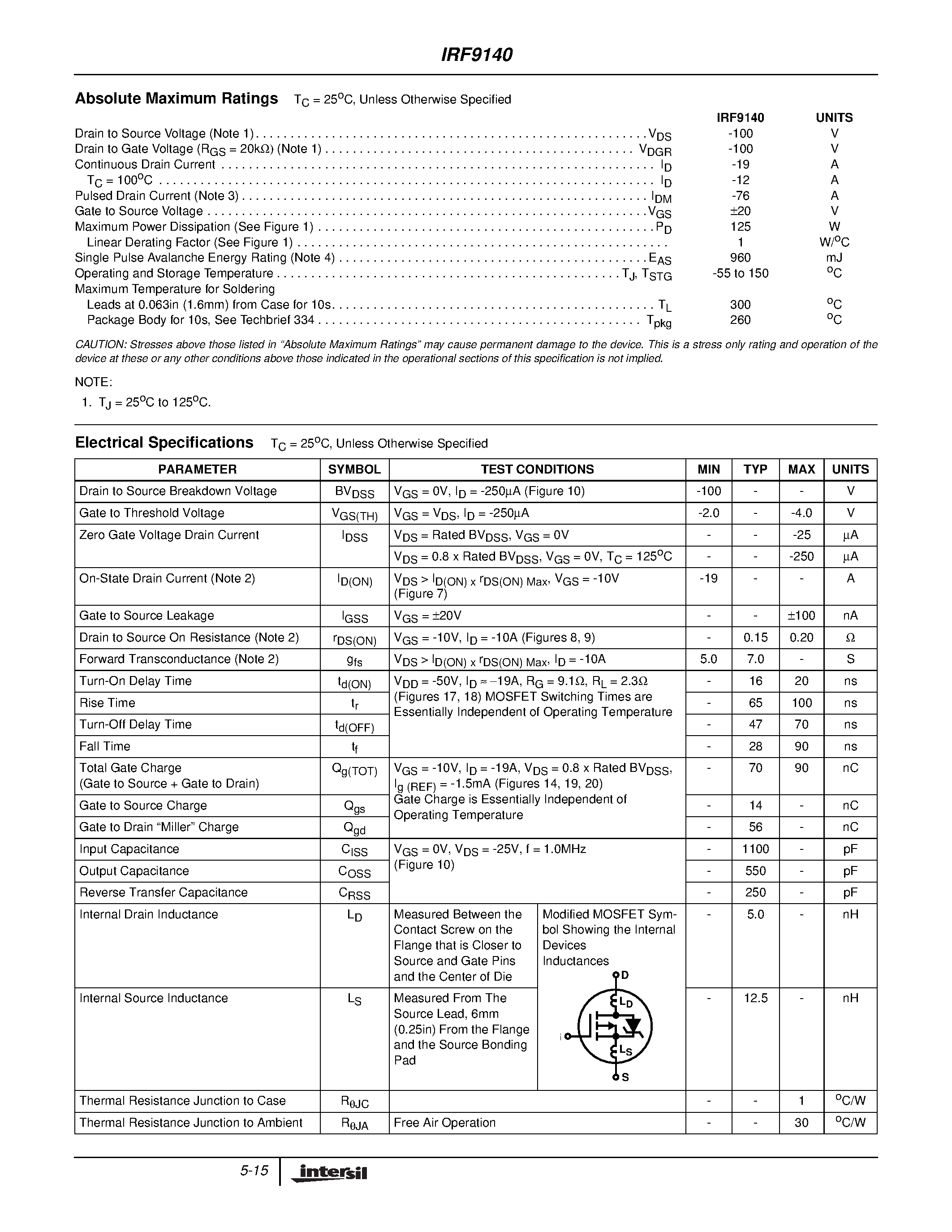

IRF9140--19A/ -100V/ 0.200 Ohm/ P-Channel Power MOSFET
Producer:Intersil Corporation
Description:-19A/ -100V/ 0.200 Ohm/ P-Channel Power MOSFET
Others with the same file: IRF9140

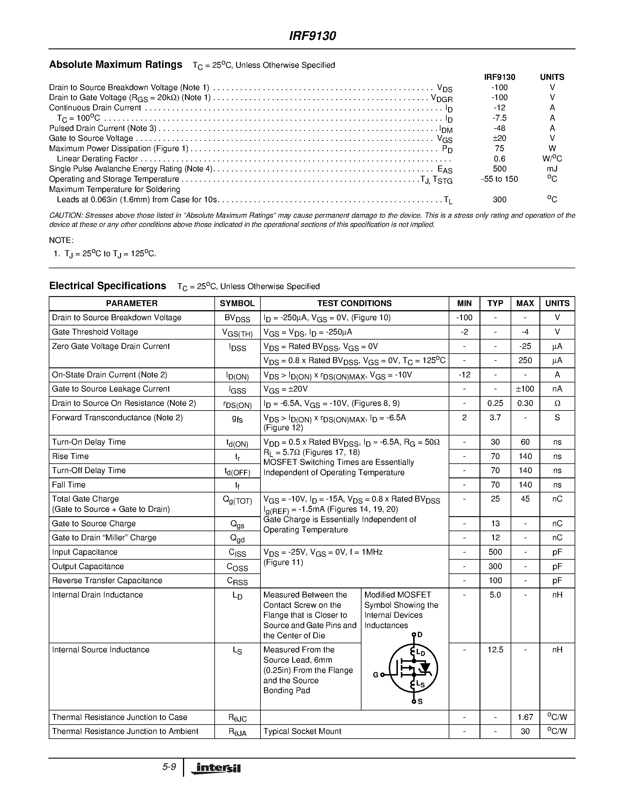

Datasheet IRF9140 - -19A/ -100V/ 0.200 Ohm/ P-Channel Power MOSFET page 1
Datasheet IRF9140 - -19A/ -100V/ 0.200 Ohm/ P-Channel Power MOSFET page 2
