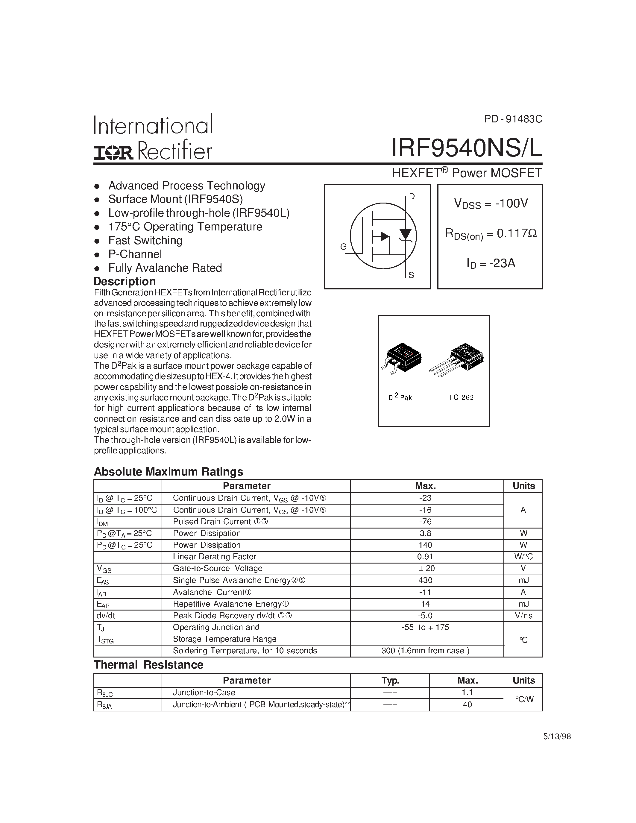

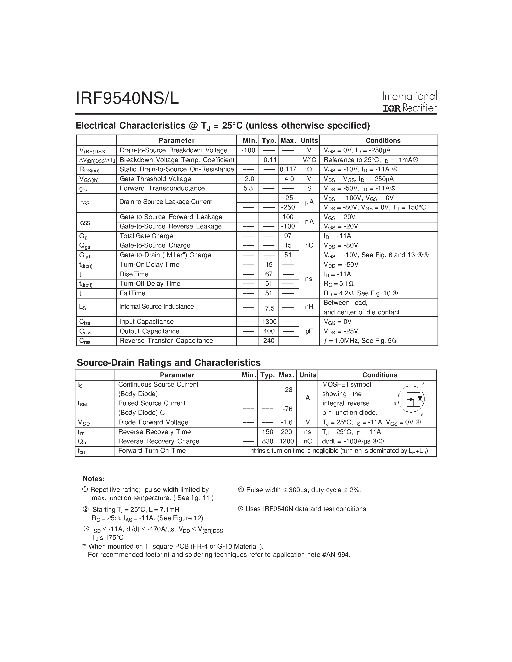

IRF9540NL-Power MOSFET(Vdss=-100V/ Rds(on)=0.117ohm/ Id=-23A)
Description:Power MOSFET(Vdss=-100V/ Rds(on)=0.117ohm/ Id=-23A)
Others with the same file: IRF9540NL
Datasheet IRF9540NL - Power MOSFET(Vdss=-100V/ Rds(on)=0.117ohm/ Id=-23A) page 1
Datasheet IRF9540NL - Power MOSFET(Vdss=-100V/ Rds(on)=0.117ohm/ Id=-23A) page 2
