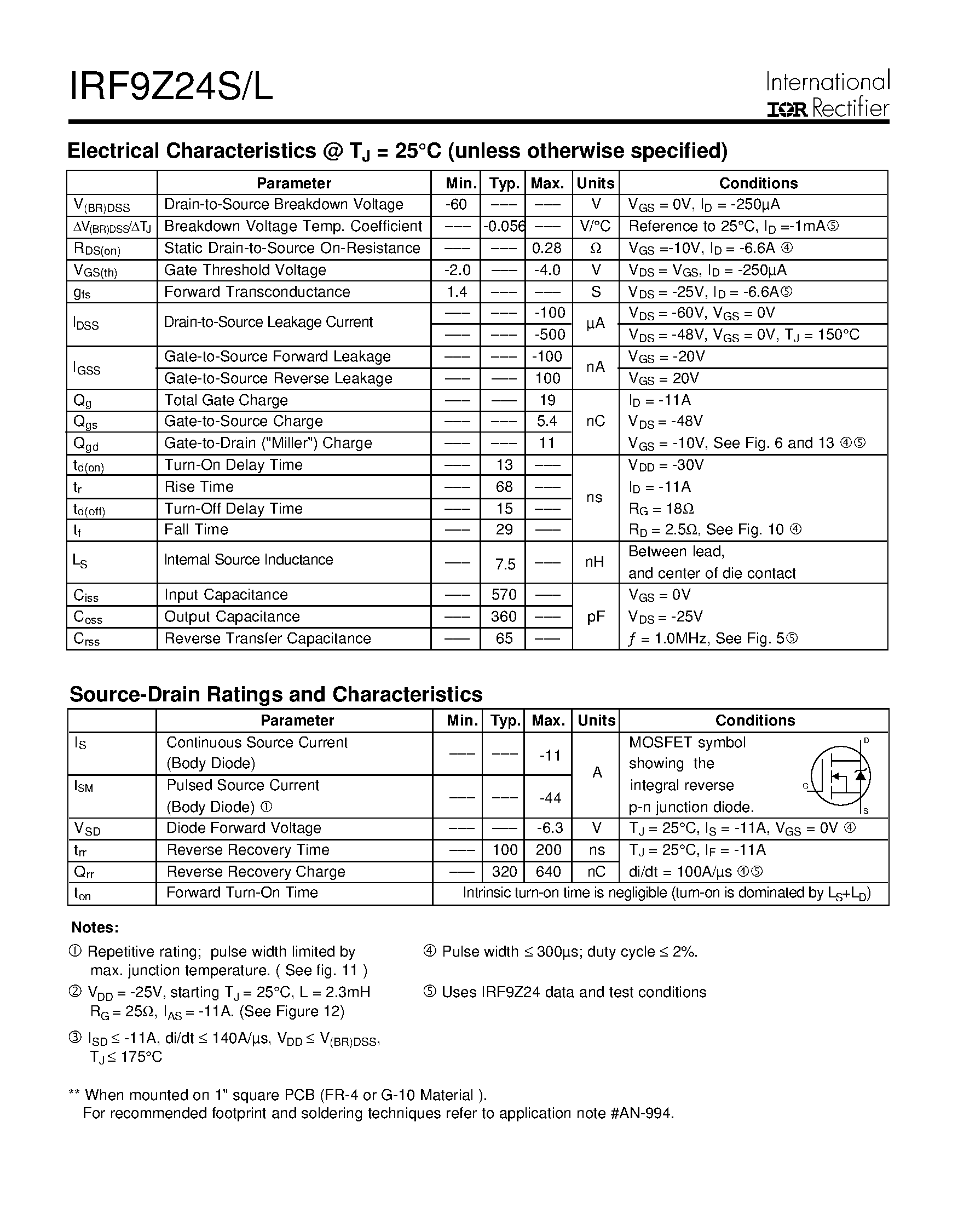

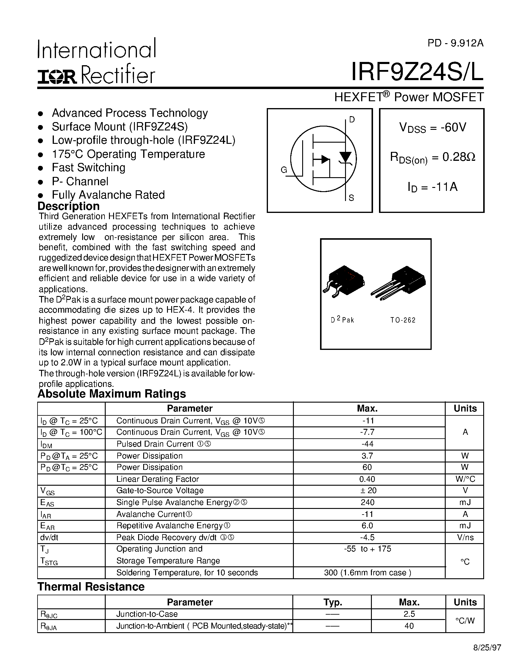

Description:Power MOSFET(Vdss=-60V/ Rds(on)=0.28ohm/ Id=-11A)
Others with the same file: IRF9Z24S
Datasheet IRF9Z24S - Power MOSFET(Vdss=-60V/ Rds(on)=0.28ohm/ Id=-11A) page 1
Datasheet IRF9Z24S - Power MOSFET(Vdss=-60V/ Rds(on)=0.28ohm/ Id=-11A) page 2
