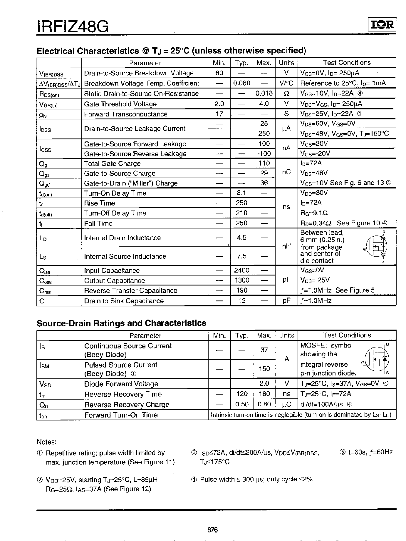

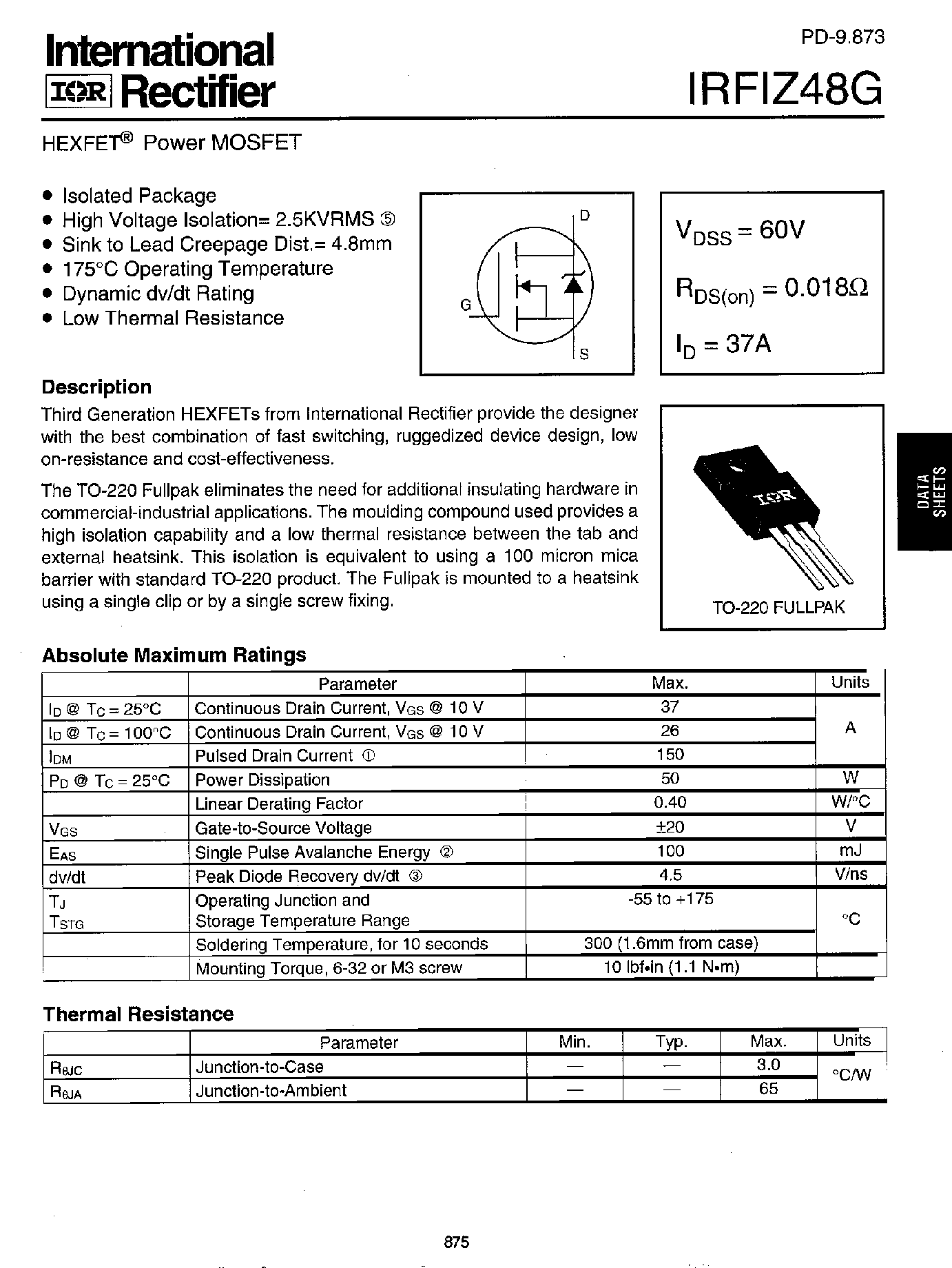

Description:Power MOSFET(Vdss=60V/ Rds(on)=0.018ohm/ Id=37A)
Others with the same file: IRFIZ48G
Datasheet IRFIZ48G - Power MOSFET(Vdss=60V/ Rds(on)=0.018ohm/ Id=37A) page 1
Datasheet IRFIZ48G - Power MOSFET(Vdss=60V/ Rds(on)=0.018ohm/ Id=37A) page 2
