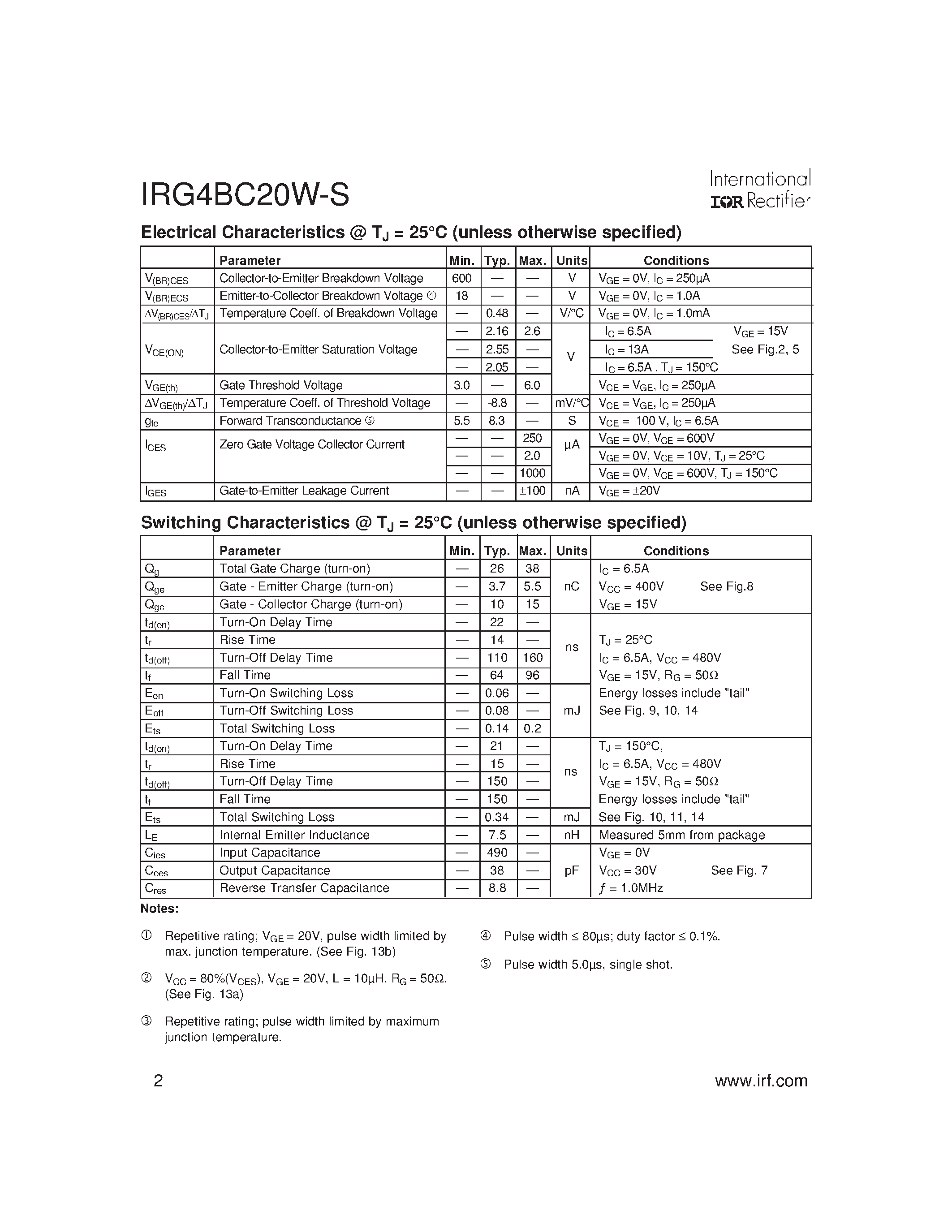

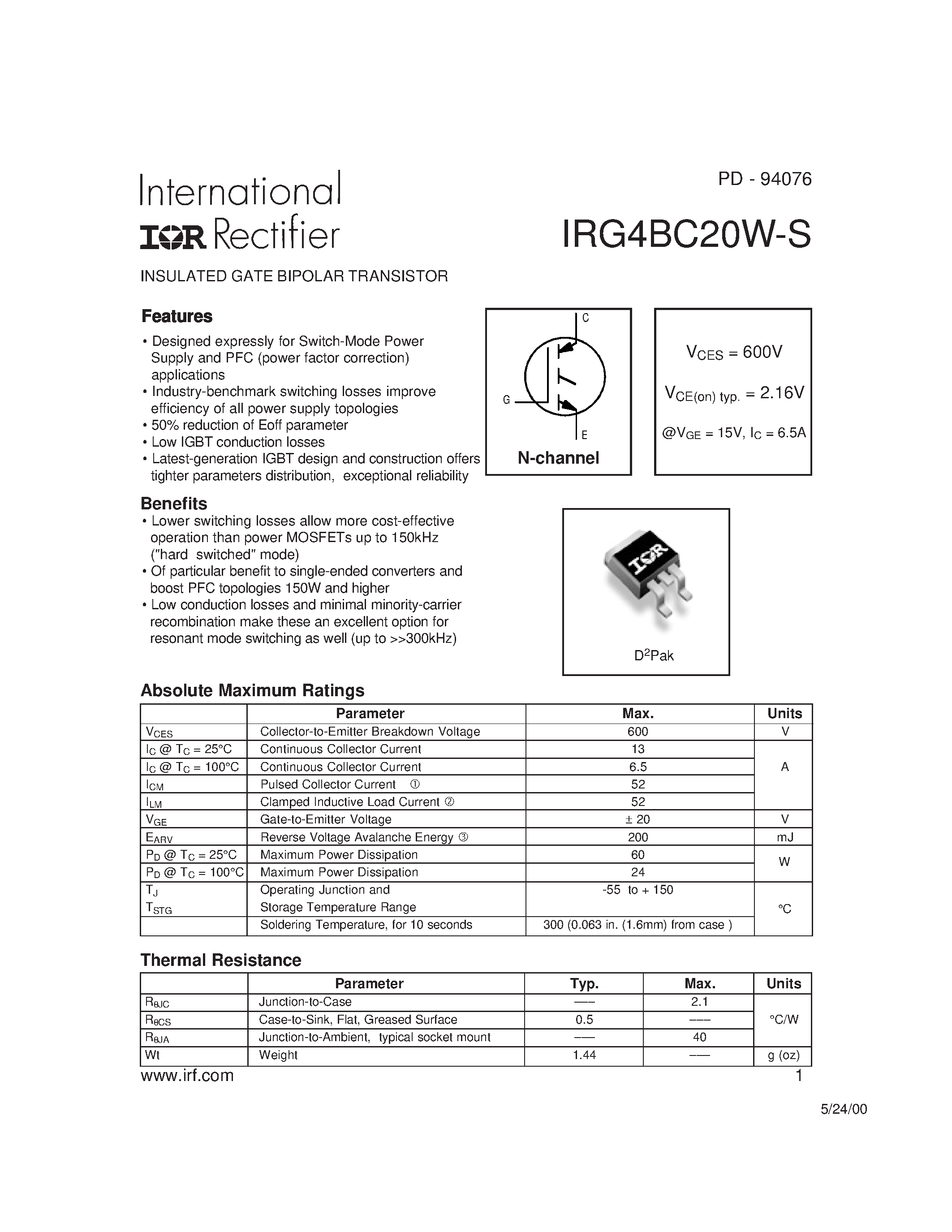

IRG4BC20W-S-INSULATED GATE BIPOLAR TRANSISTOR
Producer:IRF
Description:INSULATED GATE BIPOLAR TRANSISTOR
Others with the same file: IRG4BC20W-S
Datasheet IRG4BC20W-S - INSULATED GATE BIPOLAR TRANSISTOR page 1
Datasheet IRG4BC20W-S - INSULATED GATE BIPOLAR TRANSISTOR page 2
