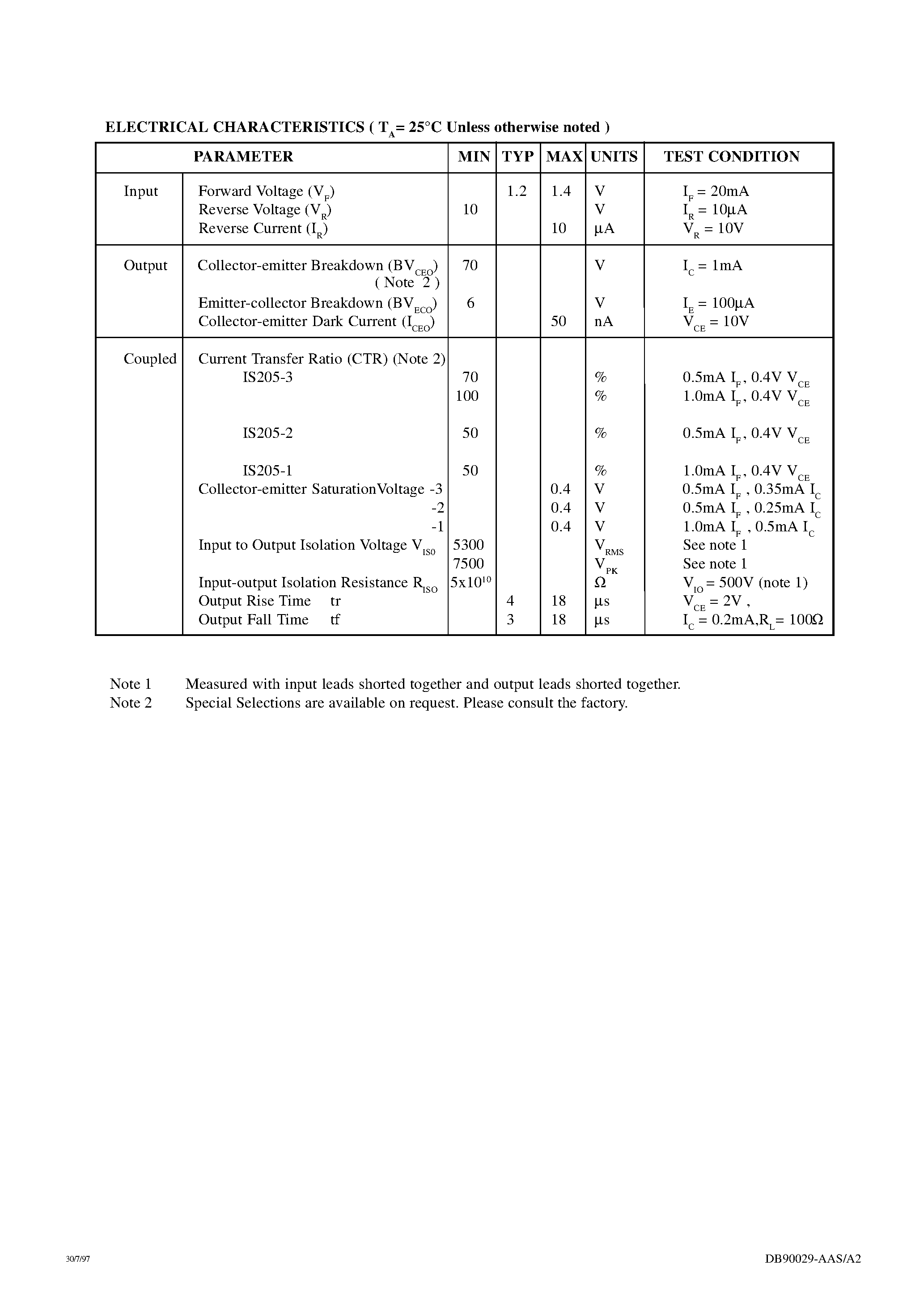

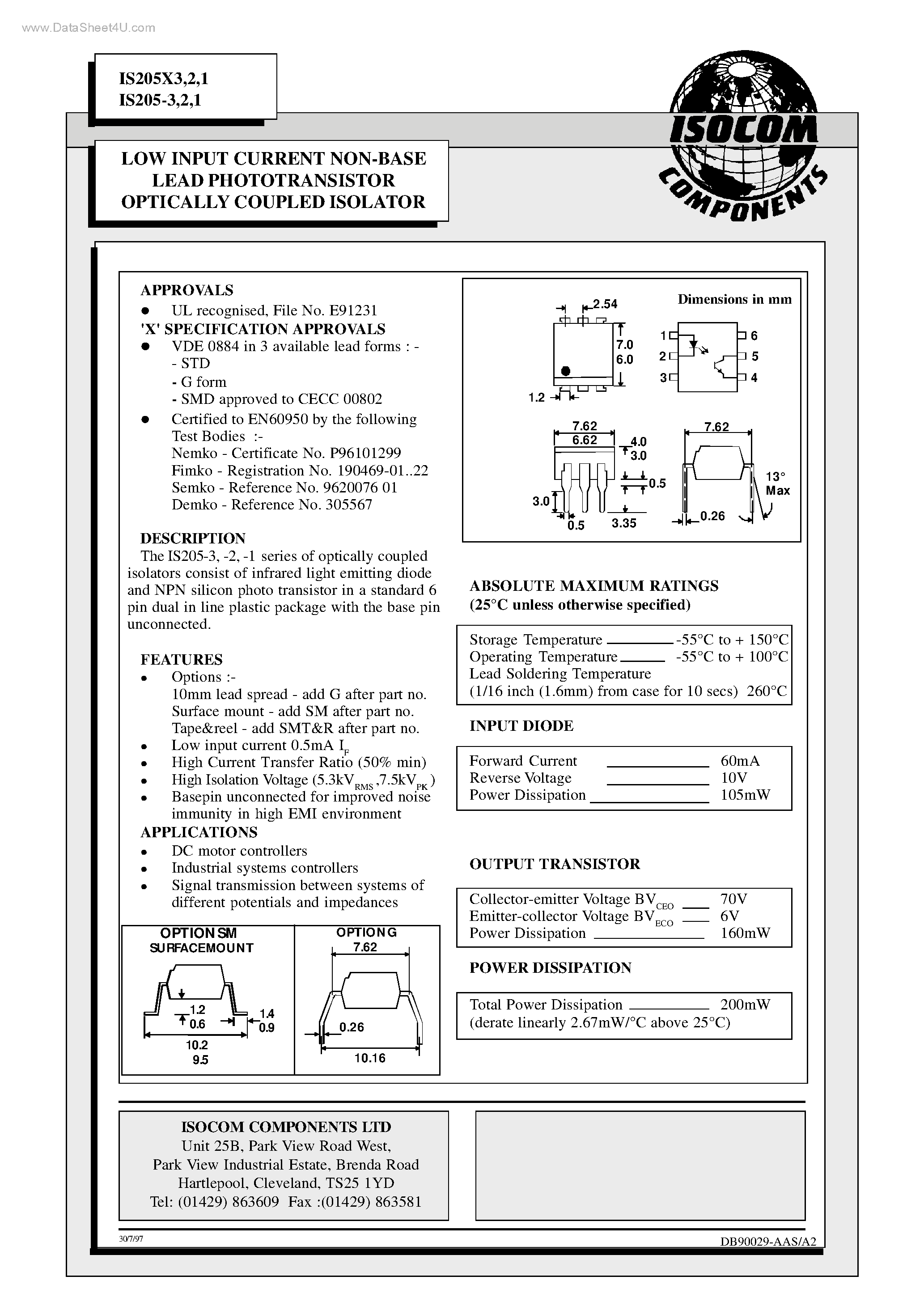

IS205-1-LOW INPUT CURRENT NON-BASE LEAD PHOTOTRANSISTOR OPTICALLY COUPLED ISOLATOR
Producer:ISOCOM COMPONENTS
Description:LOW INPUT CURRENT NON-BASE LEAD PHOTOTRANSISTOR OPTICALLY COUPLED ISOLATOR
