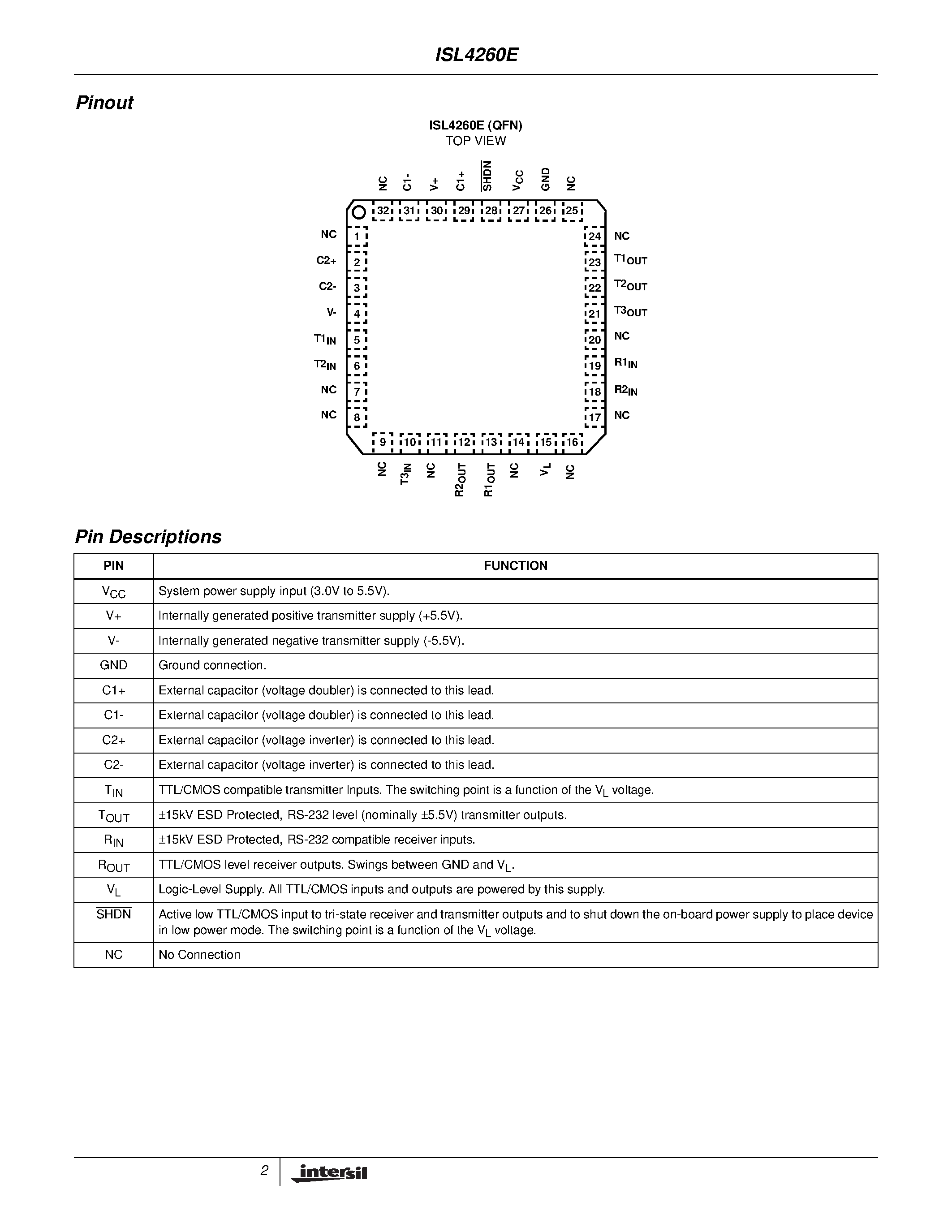

ISL4260EIR-T-QFN Packaged/ 15kV ESD Protected/ +3V to +5..5V/ 150nA/ 250kbps/ RS-232 Transmitters/Receivers with Separate Logic Supply
Producer:Intersil Corporation
Description:QFN Packaged/ 15kV ESD Protected/ +3V to +5..5V/ 150nA/ 250kbps/ RS-232 Transmitters/Receivers with Separate Logic Supply
Others with the same file: ISL4260EIR-T
Datasheet ISL4260EIR-T - QFN Packaged/ 15kV ESD Protected/ +3V to +5..5V/ 150nA/ 250kbps/ RS-232 Transmitters/Receivers with Separate Logic Supply page 1
Datasheet ISL4260EIR-T - QFN Packaged/ 15kV ESD Protected/ +3V to +5..5V/ 150nA/ 250kbps/ RS-232 Transmitters/Receivers with Separate Logic Supply page 2
