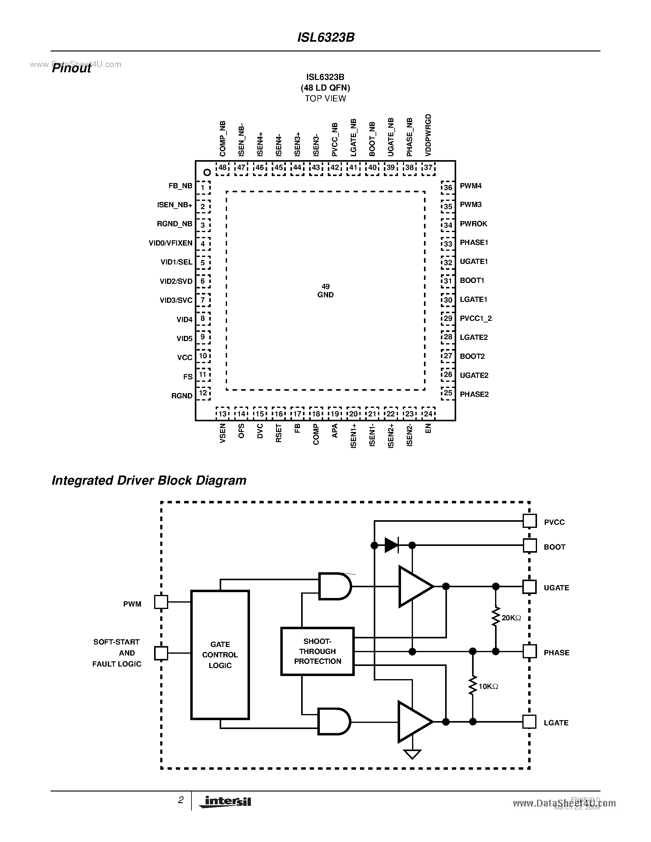

ISL6323B-Monolithic Dual PWM Hybrid Controller Powering AMD SVI Split-Plane And PVI Uniplane Processors
Producer:Intersil Corporation
Description:Monolithic Dual PWM Hybrid Controller Powering AMD SVI Split-Plane And PVI Uniplane Processors
