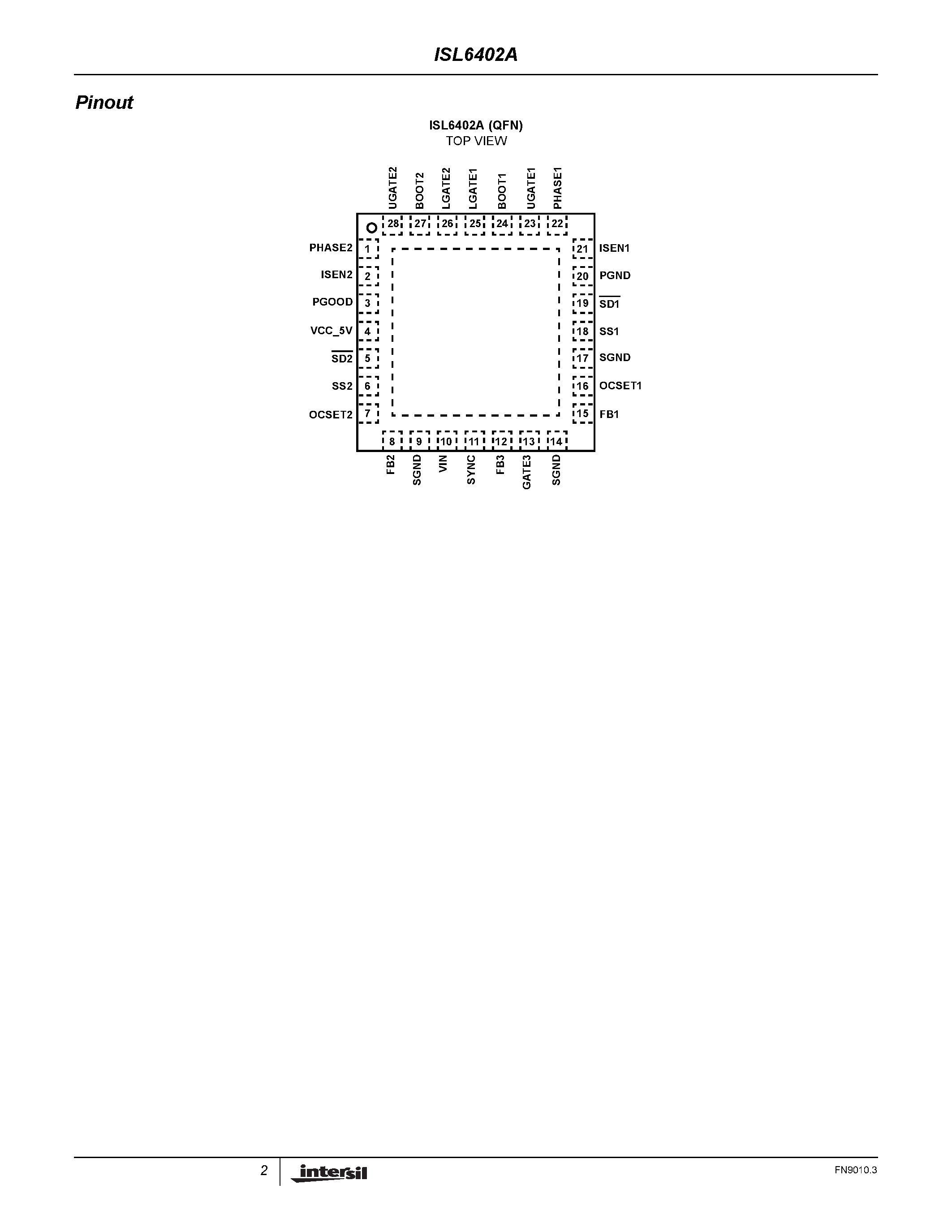

ISL6402A-1.4MHz Dual / 180 Out-of-Phase / Step- Down PWM and Single Linear Controller
Producer:Intersil
Description:1.4MHz Dual / 180 Out-of-Phase / Step- Down PWM and Single Linear Controller
Others with the same file: ISL6402A
Datasheet ISL6402A - 1.4MHz Dual / 180 Out-of-Phase / Step- Down PWM and Single Linear Controller page 1
Datasheet ISL6402A - 1.4MHz Dual / 180 Out-of-Phase / Step- Down PWM and Single Linear Controller page 2
