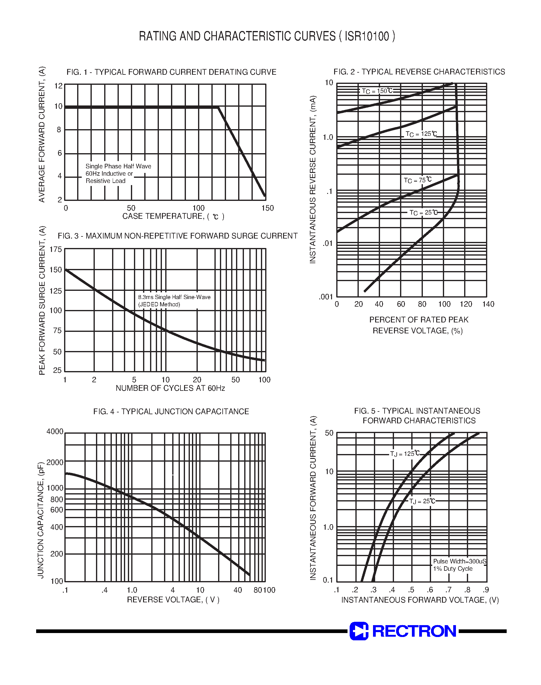

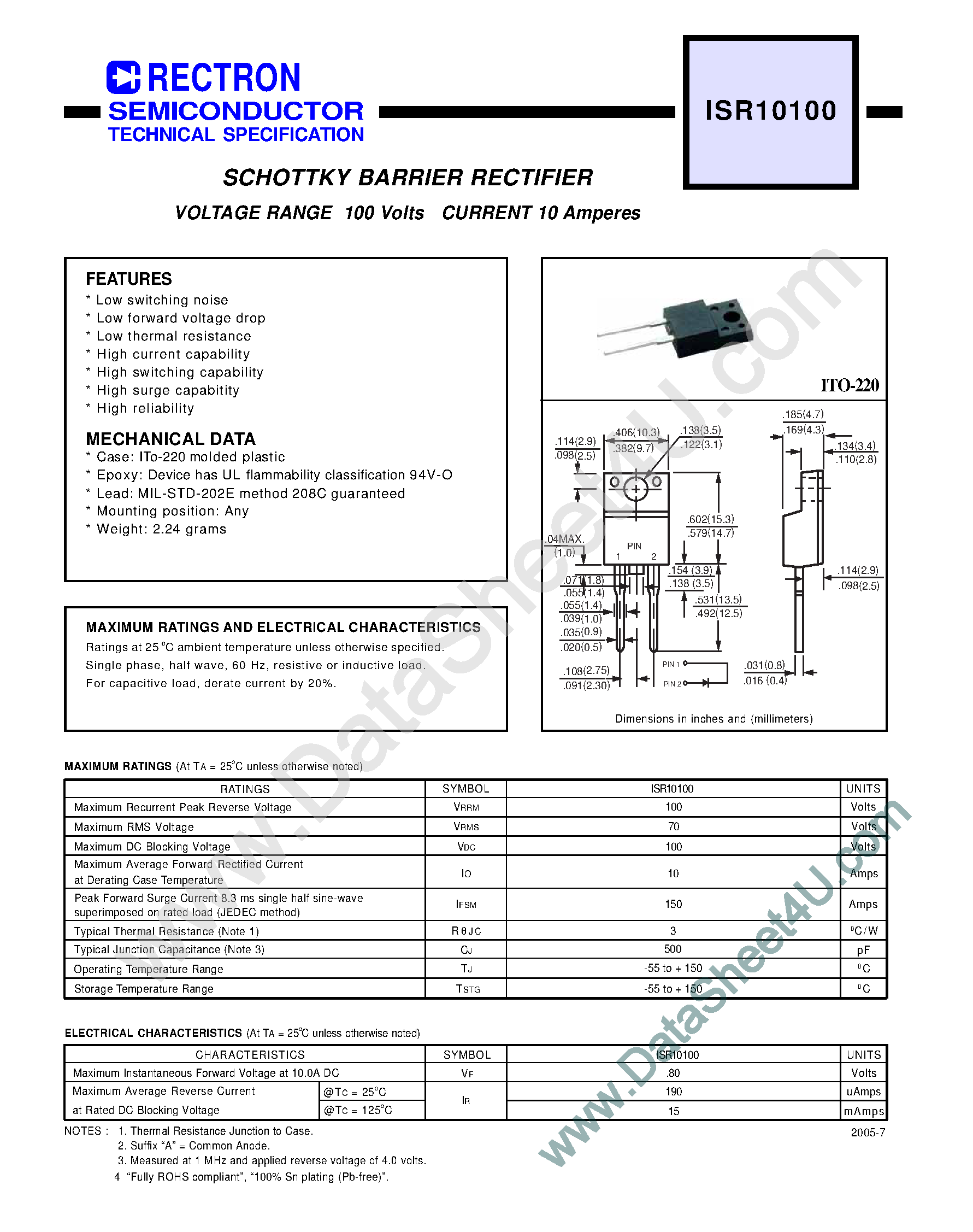

ISR10100-SCHOTTKY BARRIER RECTIFIER VOLTAGE RANGE 100 Volts CURRENT 10 Amperes
Description:SCHOTTKY BARRIER RECTIFIER VOLTAGE RANGE 100 Volts CURRENT 10 Amperes
Others with the same file: ISR10100
Datasheet ISR10100 - SCHOTTKY BARRIER RECTIFIER VOLTAGE RANGE 100 Volts CURRENT 10 Amperes page 1
Datasheet ISR10100 - SCHOTTKY BARRIER RECTIFIER VOLTAGE RANGE 100 Volts CURRENT 10 Amperes page 2
