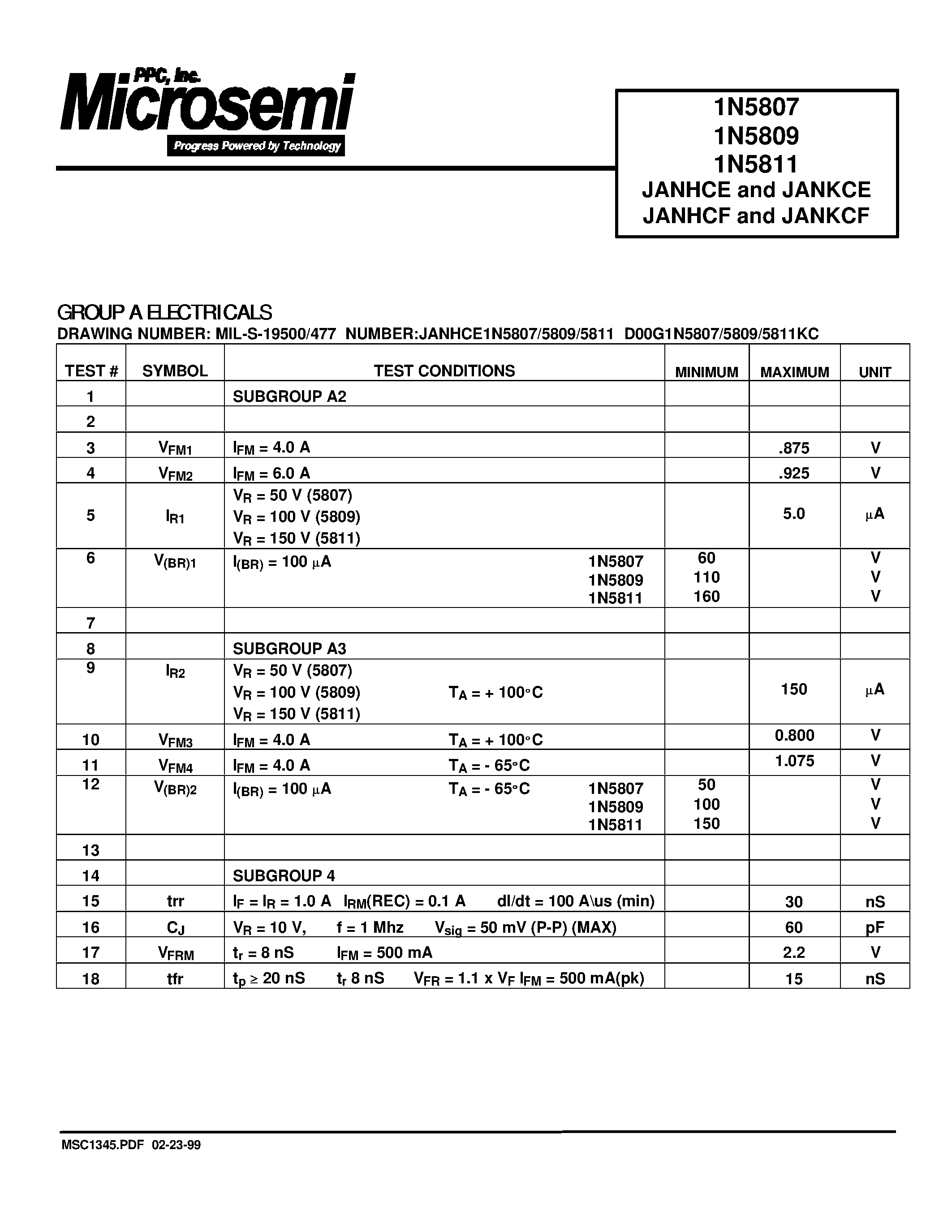

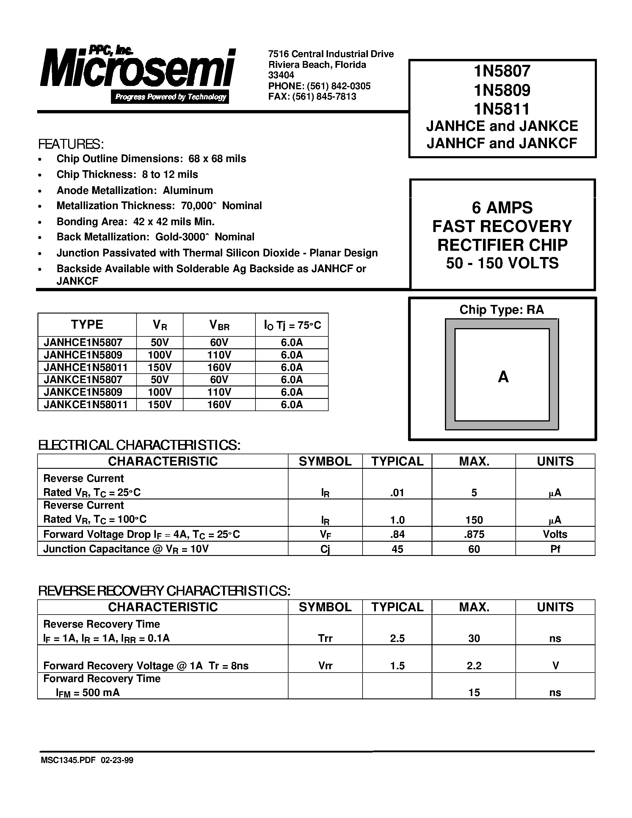

JANHCE1N58011-6 AMPS FAST RECOVERY RECTIFIER CHIP 50 - 150 VOLTS
Description:6 AMPS FAST RECOVERY RECTIFIER CHIP 50 - 150 VOLTS
Others with the same file: JANHCE1N58011
Datasheet JANHCE1N58011 - 6 AMPS FAST RECOVERY RECTIFIER CHIP 50 - 150 VOLTS page 1
Datasheet JANHCE1N58011 - 6 AMPS FAST RECOVERY RECTIFIER CHIP 50 - 150 VOLTS page 2
