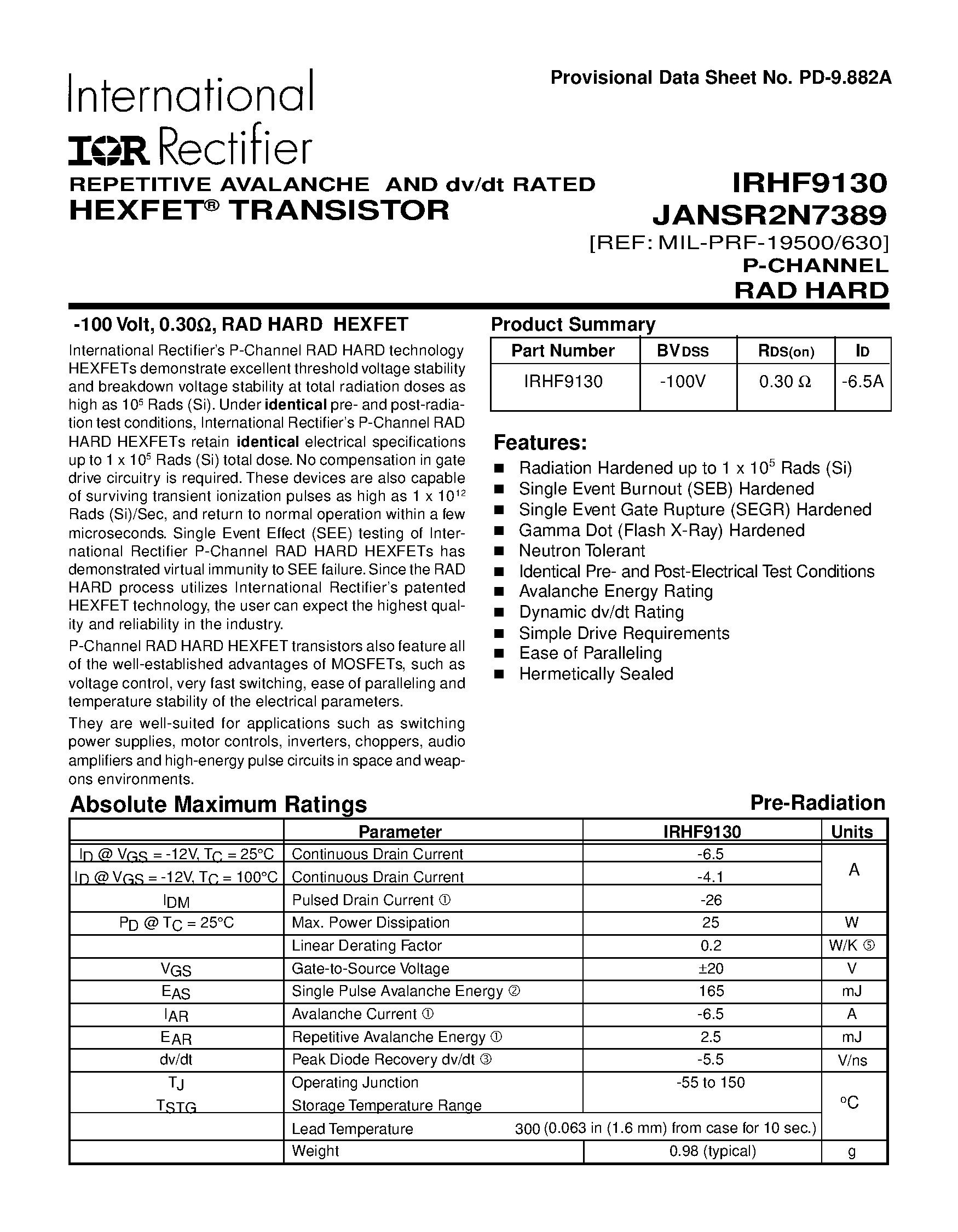

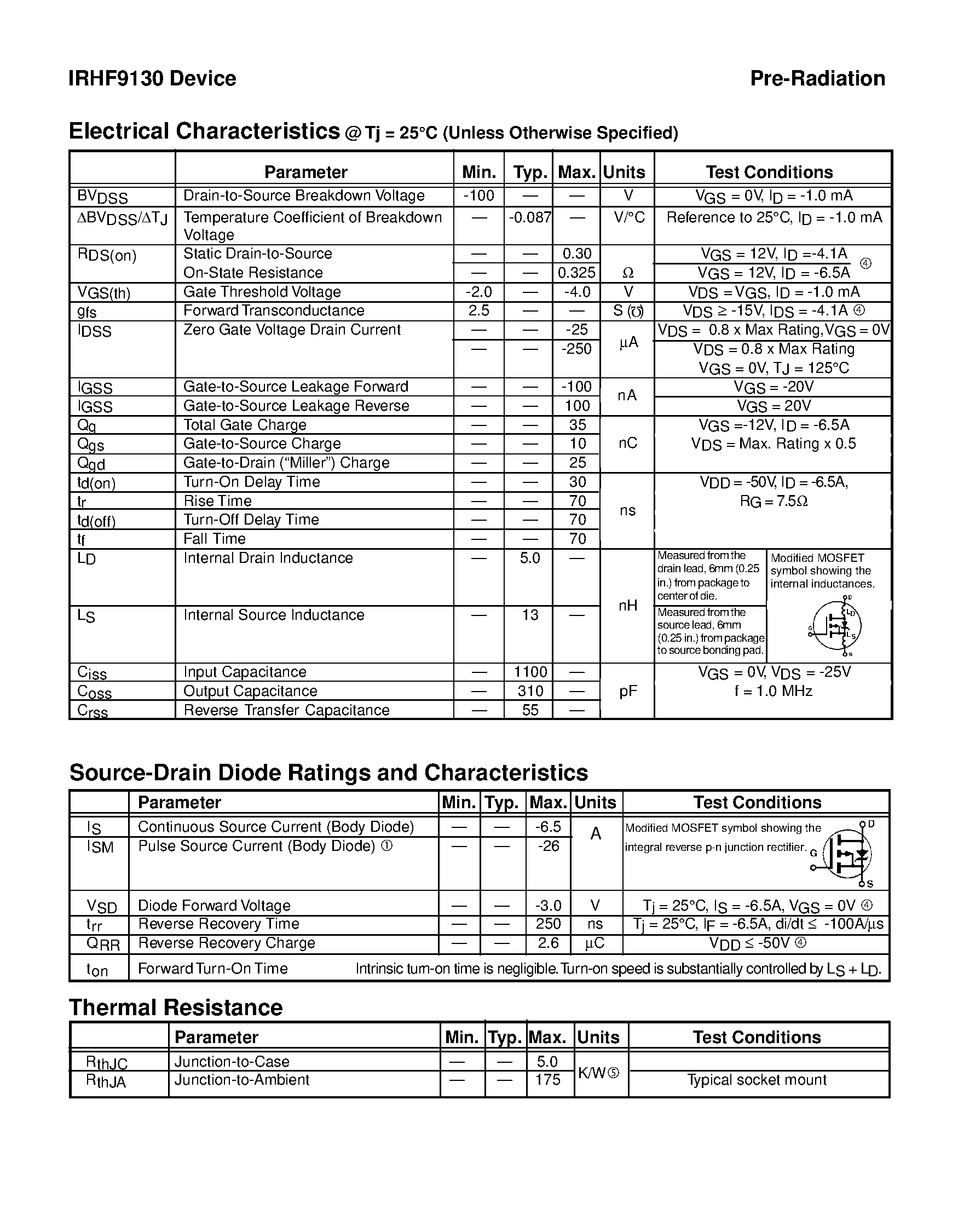

JANSR2N7389-TRANSISTOR P-CHANNEL(BVdss=-100V/ Rds(on)=0.30ohm/ Id=-6.5A)
Description:TRANSISTOR P-CHANNEL(BVdss=-100V/ Rds(on)=0.30ohm/ Id=-6.5A)
Others with the same file: JANSR2N7389
Datasheet JANSR2N7389 - TRANSISTOR P-CHANNEL(BVdss=-100V/ Rds(on)=0.30ohm/ Id=-6.5A) page 1
Datasheet JANSR2N7389 - TRANSISTOR P-CHANNEL(BVdss=-100V/ Rds(on)=0.30ohm/ Id=-6.5A) page 2
