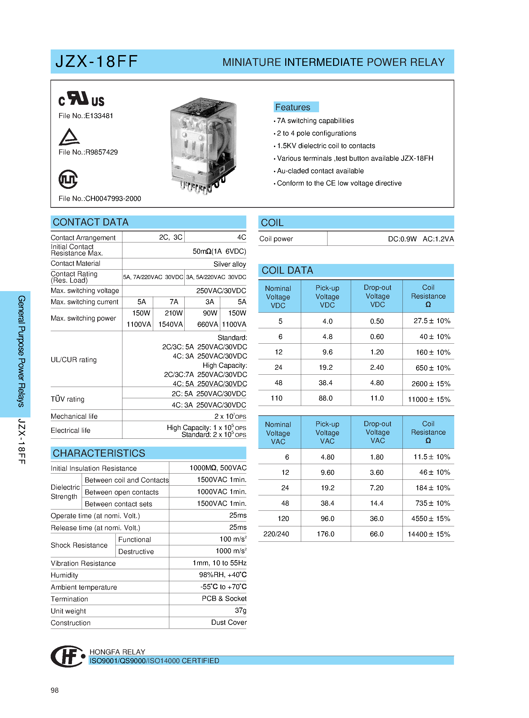

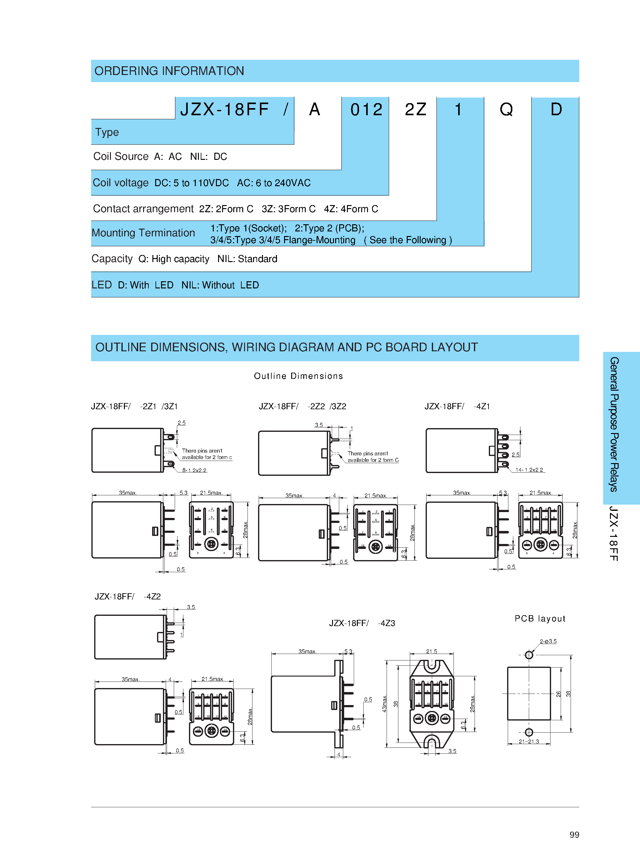

JZX-18FF/ADC2Z1QD-MINIATURE INTERMEDIATE POWER RELAY
Producer:ETC
Description:MINIATURE INTERMEDIATE POWER RELAY
Others with the same file: JZX-18FF/ADC2Z1QD
Datasheet JZX-18FF/ADC2Z1QD - MINIATURE INTERMEDIATE POWER RELAY page 1
Datasheet JZX-18FF/ADC2Z1QD - MINIATURE INTERMEDIATE POWER RELAY page 2
