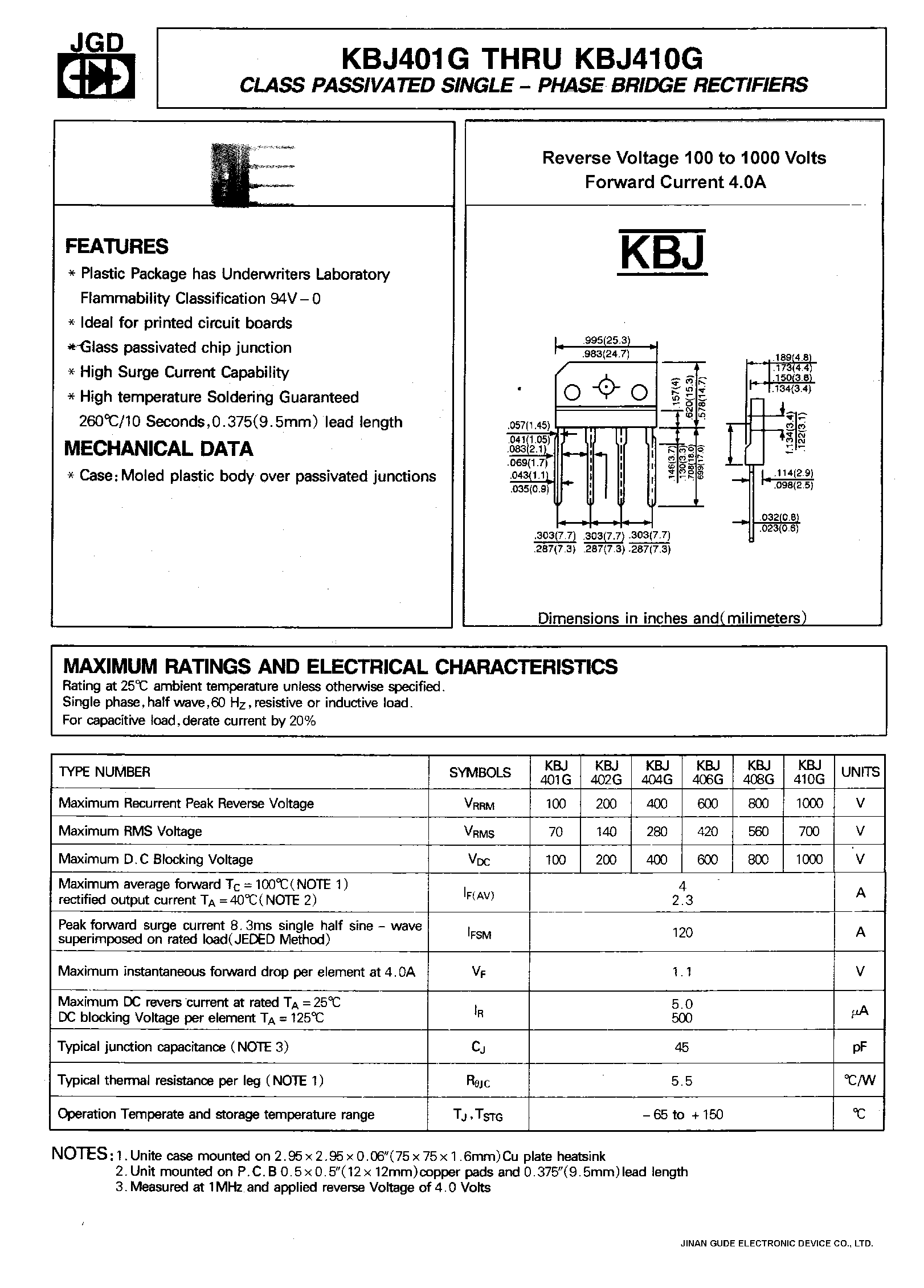

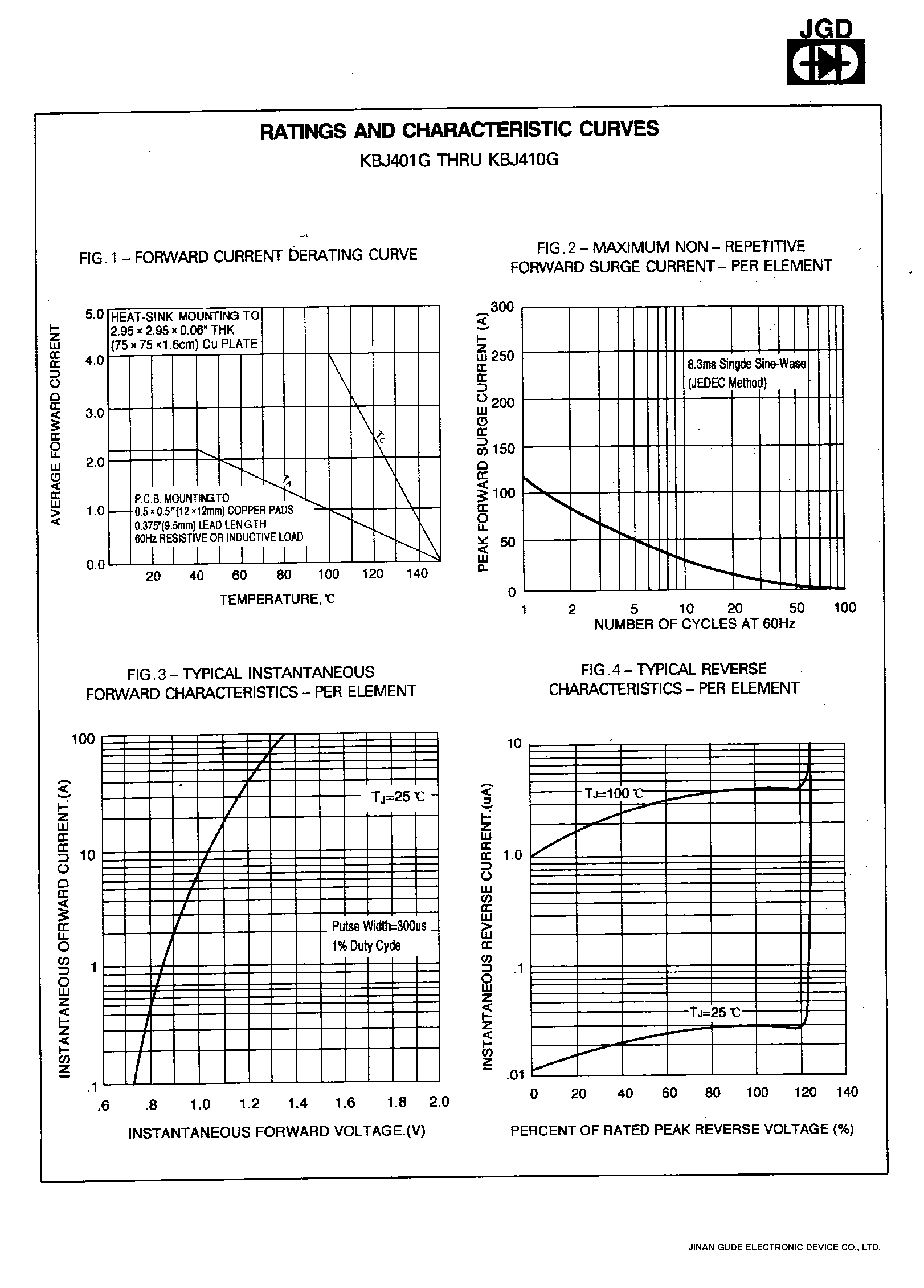

KBJ401G-CLASS PASSIVATED SINGLE-PHASE BRIDGE RECTIFIERS
Producer:Jinan Gude Electronic Device
Description:CLASS PASSIVATED SINGLE-PHASE BRIDGE RECTIFIERS
Others with the same file: KBJ401G
Datasheet KBJ401G - CLASS PASSIVATED SINGLE-PHASE BRIDGE RECTIFIERS page 1
