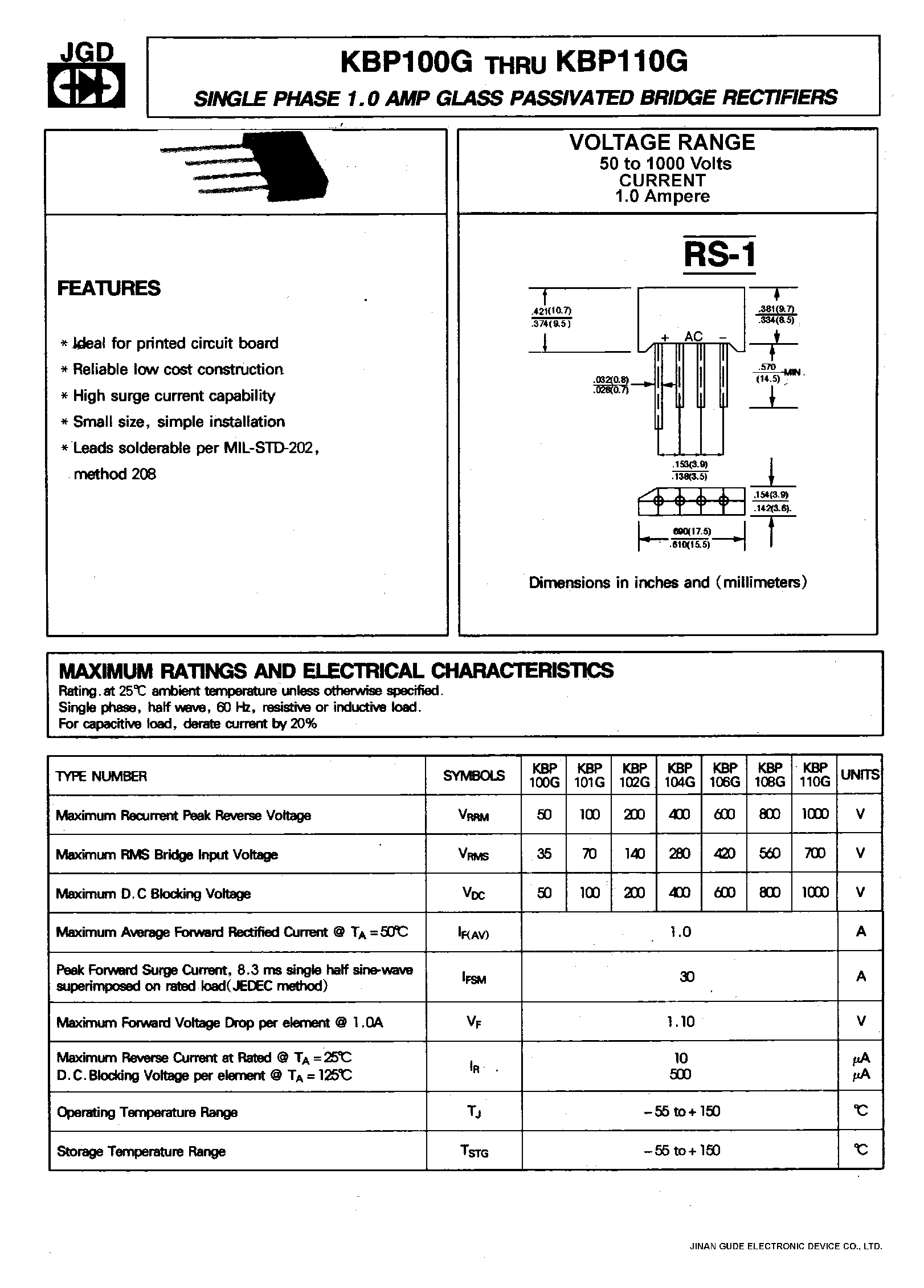

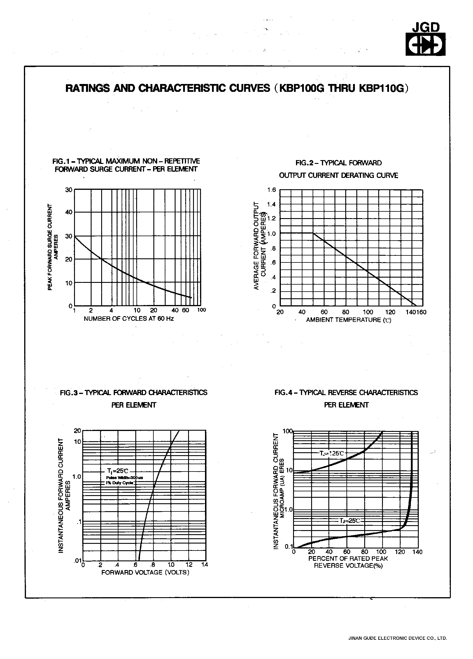

KBP100-SINGLE PHASE 1.0 AMP GLASS PASSIVATED BRIDGE RECTIFIERS
Producer:Jinan Gude Electronic Device
Description:SINGLE PHASE 1.0 AMP GLASS PASSIVATED BRIDGE RECTIFIERS
Others with the same file: KBP100
Datasheet KBP100 - SINGLE PHASE 1.0 AMP GLASS PASSIVATED BRIDGE RECTIFIERS page 1
Datasheet KBP100 - SINGLE PHASE 1.0 AMP GLASS PASSIVATED BRIDGE RECTIFIERS page 2
