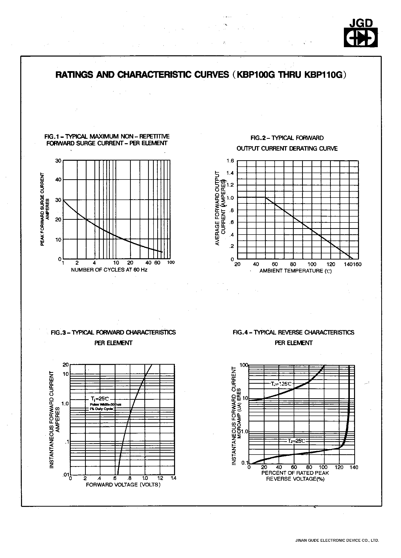

KBP101G-SINGLE PHASE 1.0 AMP GLASS PASSIVATED BRIDGE RECTIFIERS
Producer:Jinan Gude Electronic Device
Description:SINGLE PHASE 1.0 AMP GLASS PASSIVATED BRIDGE RECTIFIERS
Others with the same file: KBP101G
