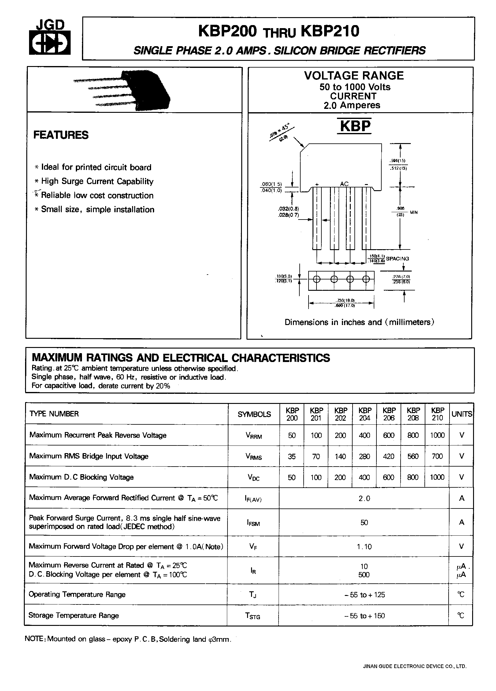

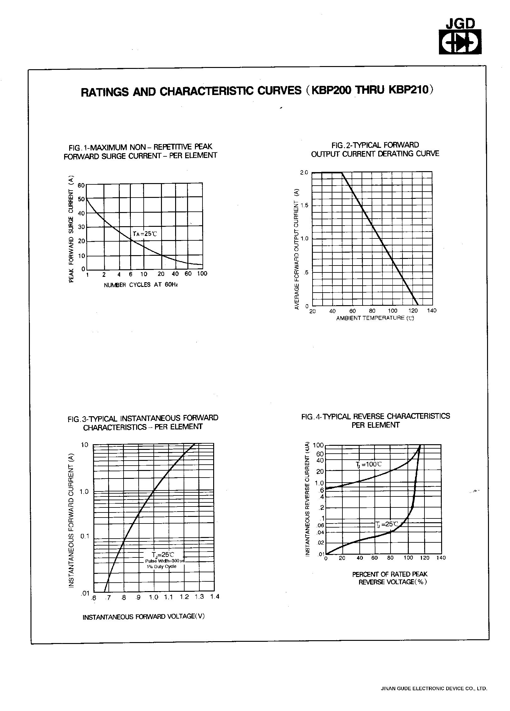

KBP201-SINGLE PHASE 2.0 AMPS. SILICON BRIDGE RECTIFIERS
Producer:Jinan Gude Electronic Device
Description:SINGLE PHASE 2.0 AMPS. SILICON BRIDGE RECTIFIERS
