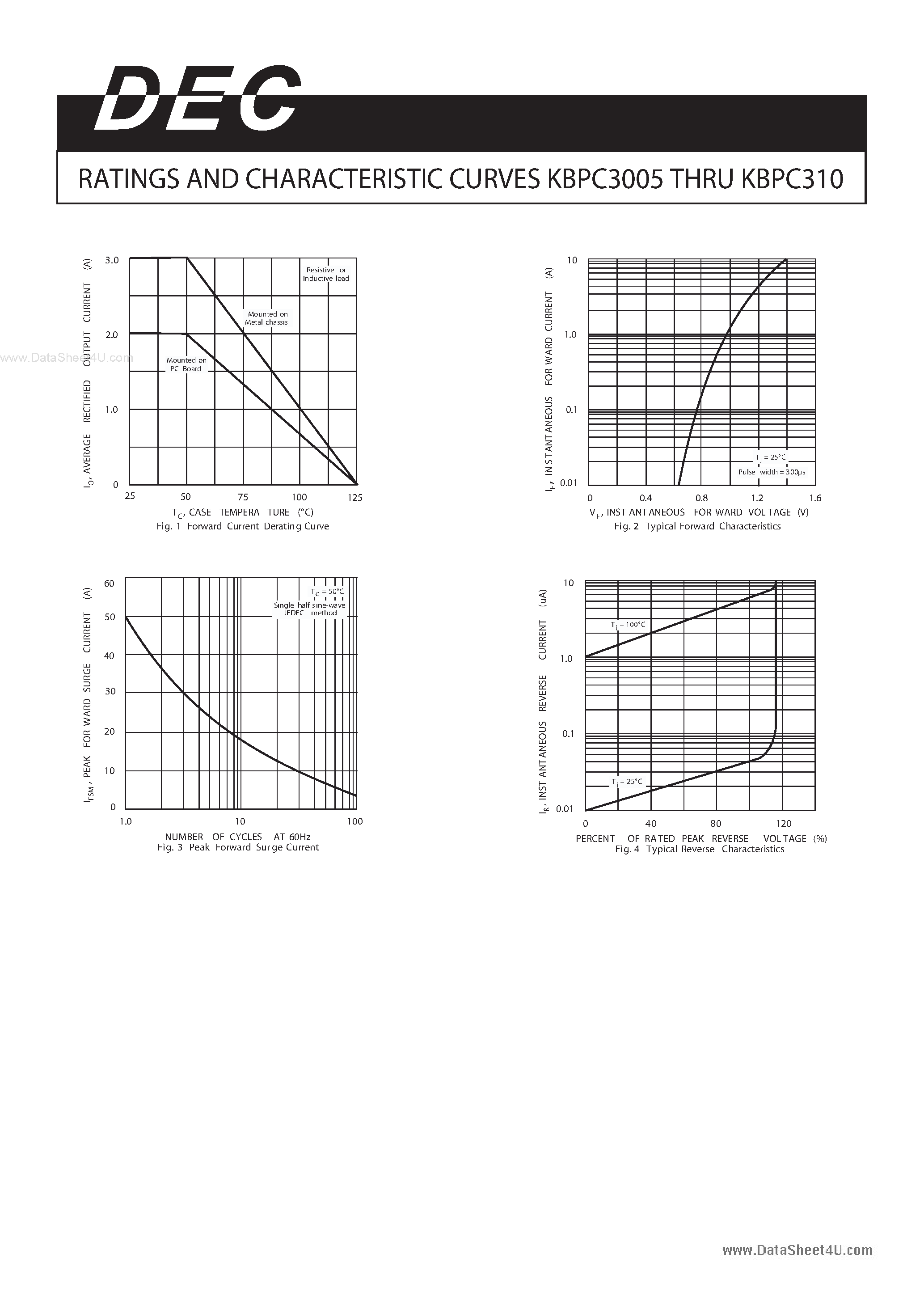

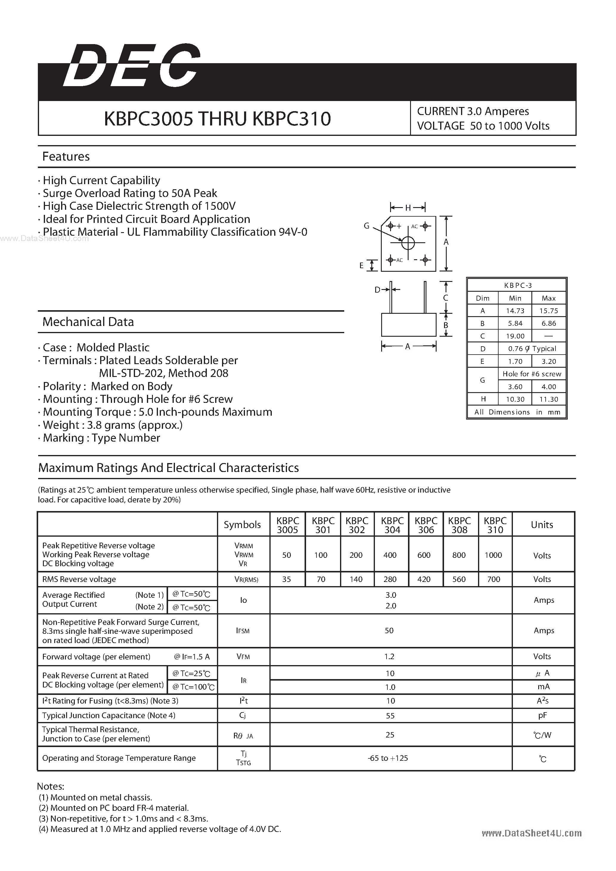

KBPC3005-(KBPC3005 - KBPC310) CURRENT 3.0 Amperes VOLTAGE 50 to 1000 Volts
Producer:DEC
Description:(KBPC3005 - KBPC310) CURRENT 3.0 Amperes VOLTAGE 50 to 1000 Volts
